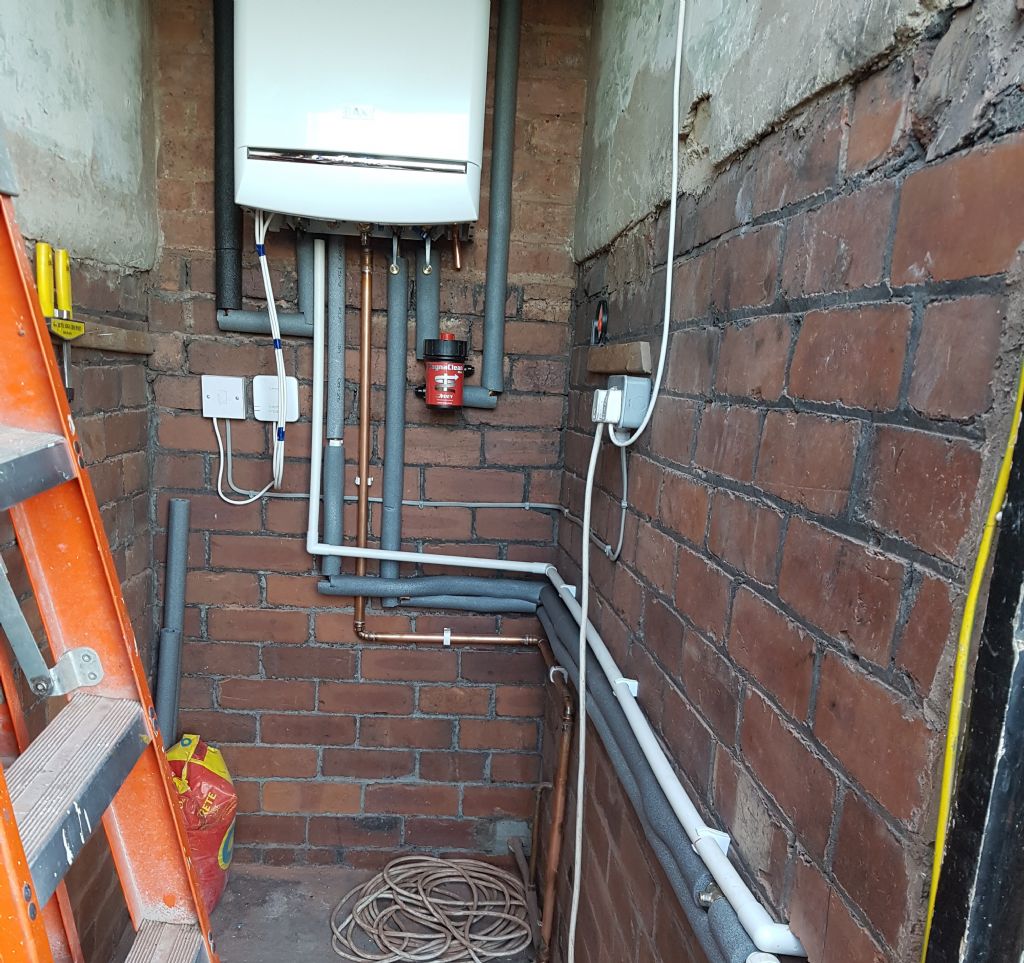

I can see nothing wrong with your boiler installtion from the photo posted. it is a quality boiler from a reputable company being use for it's intended purpose. As it was inspected by a Cometent Person it is reasonable to assume the installation complies with the installation instructions and Building Regulations.
I did exactly the same and installed new, not replacement, gas bolier and cooker including all pipework back to the meter myself. A Competent Person inspected the installation (no changes required, they actually commented on the good standard of work) made the connection to the meter and issued a certificate.
Now go get an OFTEC approved persion to inspect and certify your diesel heater and show us the certificate.
Why do you think an oil heater is different from a gas heater in terms of meeting certification, being used for the intended application and being installed and inspected by a Competent Person?
The Gas Safety Regulations make it abundantly clear that works on gas equipment must be done by a competent person, and if done for profit such persons must hold a Gas Safe registration to prove competence, the whole thing is administered by/on behalf of the Health and Safety Executive.
In contrast registration with OFTEC as a "competent person" is actually a membership of a trade-body compliance scheme which gives limited powers to self-certify installations with respect to the building regulations. It's administered internally by a trade body, on behalf of the Department for Levelling Up, Housing and Communities.
There is a very clear difference between the two on that basis alone.
When one considers the differences in both potential for harm and likelihood of a catastrophic adverse event between Gas (high harm, with serious off-premises impact, and medium-high likelihood) and Diesel (medium harm, with limited off-premises impact, and a low likelihood) when mis-managed, it becomes clear why the differing regulatory approaches have been taken and why gas is comparatively tightly controlled.
I would say the risk difference between diesel (a liquid with low volatility which can extinguish many burning and smoldering objects with, and natural gas a gas with a wide explosive limit in air, which is easy to initiate with static electricity) is common sense, but it also comes out clearly in an Quantitative Risk assessment framework.
