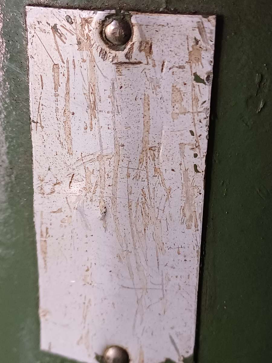

      I recently bought a used Chester Champion milling machine of the type pictured below.
      I seems that it was originally supplied with a 3-phase motor and Eurotherm drives inverter, power feed and cabinet from Chester.
      It was advertised as motor not working and I was expecting to replace it. After some investigation I have found that there is no voltage coming from the inverter, so maybe the motor does work.
      Before I buy a VFD how can I test if the motor works?
      The data plate on the motor is unreadable so I don’t know exactly what I will need, but the old inverter supplied 0.55/0.75kW 3-phase. Can you recommend a suitable replacement?

        How you test it depends on what test gear you have  ? Checking the resistance of the 3 coils and if you can get your hands on an insulation tester (megger )then test the insulation. Is there an unpleasant smell of burnt insulation when you open the terminal box ? It will I expect be wired delta, change to star and try the motor on proper 3Ph or on a converter (transwave or motorun ) also 415V. If your near me I can help. Noel.

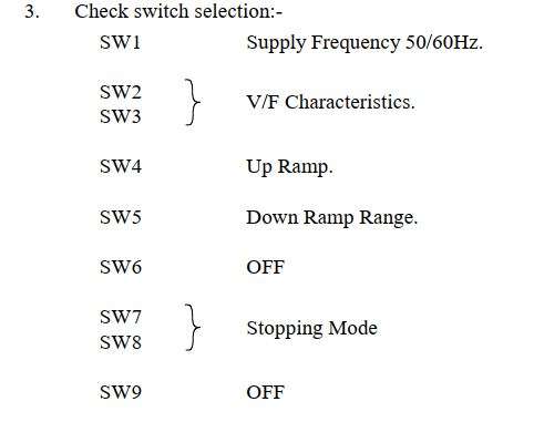

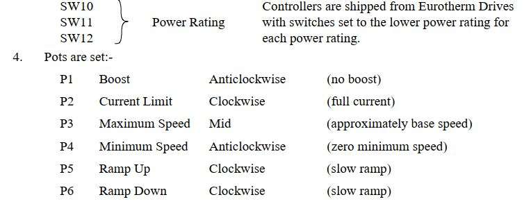

                  Thanks for your replies. I have done some more investigation and have managed to run the motor connected to single phase with a capacitor.
                  On the Eurotherm drives 582 inverter there are 5 pots and ten switches that can be set as per the manual. I don’t see anything that would prevent an output.
                  Snip 1Snip 2

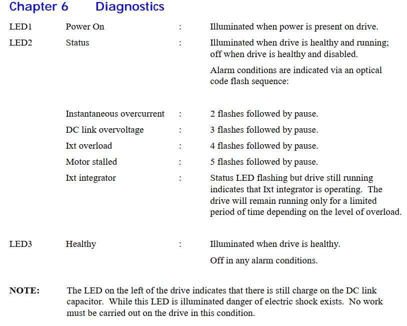

                  When power is connected only the DC link capacitor LED is illuminated, the other three are off.
                  Snip 3
                  #802071
                  Julie Ann
                    @julieann
                    If I’ve read that correctly LED1 to LED3 are off? If LED1 is off that implies the VFD is not getting power (or the LED is phut), which is pretty fundamental. I’d trace the incoming supply as far as I could; at least to the terminals on the VFD.
                    Julie

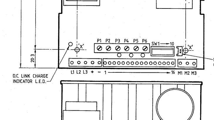

                          Thanks for all your ideas.
                          There are no interlocks. The power feed has a separate tranformer that supplies 110v and it works correctly.
                          The spindle motor (the problem) is on a separate plug. With power on, I get voltage at the inverter input (L1 & L2) and the DC brake connections (+ & -).
                          LED1 2 and 3 are Not illuminated (the three circle below the pots). The DC link charge indicacator does illuminate.
                          Snip 4
                          I have a copy of the manual, it can be found at the link below.
                          https://www.manualslib.com/manual/1380912/Eurotherm-582.html
                          I’ll have another look tomorrow but I’m not too confident poking around inside with a multimeter.
                          Martin
