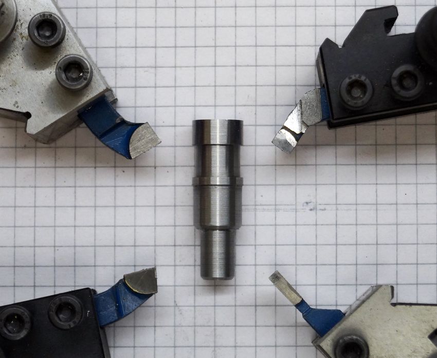

      Last year when I started out and got my mini lathe it came with a set of carbide tipped tools. Not knowing any different at the time I thought great, I could start making swarf…but no.
      The tools come shaped (and there are some strange shapes) but none are sharpened or at least mine were not. Some of you guys suggested I shelve them and get myself a decent set of HSS tools and/or blanks and cut my own which I did.
      I had forgotten about the tipped set until yesterday when I came across them again. I wondered if some of them were given a good edge how good or bad they would be. I picked out one or two using the ones that were reasonably shaped though I had to change/improve some of the angles.
      I put up a piece of free cutting steel as a test piece and gave them a try, I used the smaller of the two knife type on the spigot and the bit heavier version on the shoulder behind. The chamfer tool was a bit of a dogs dinner to start with (still is) but I got a good edge on it and used it between the shoulder and the spigot. The parting tool I used for cutting the groove and the parting off.
      Well the tools worked ok, not the very best of finishes but not too bad at all, I was surprised how well the parting tool worked for both grooving and parting off . Although carbide I used them not much above HSS speeds and in fact when I tried running them at higher speeds there was no improvement.
      One of the boring tools looks to have a decent shaped bit so that could probably be made good plus there are a couple of others that may turn out ok. I guess there are about six tools from the set of twelve that could be useful.
      It was just a bit of a test and obviously I am not recommending the set, far from it but with a bit of work you can get a few usable tools and if they come with the machine why not.

                  Yes they obviously do have their shortcomings and the carbide probably is of a poor quality but it was interesting to see if they would produce a half decent test piece and they certainly did that but they wouldnt be my cutting tools of choice.
                  As Neil suggests they may come in one day when there is something nasty to machine. The one tool I will keep handy though is the 3mm parting tool, not for parting but for grooving as that really did work very well.

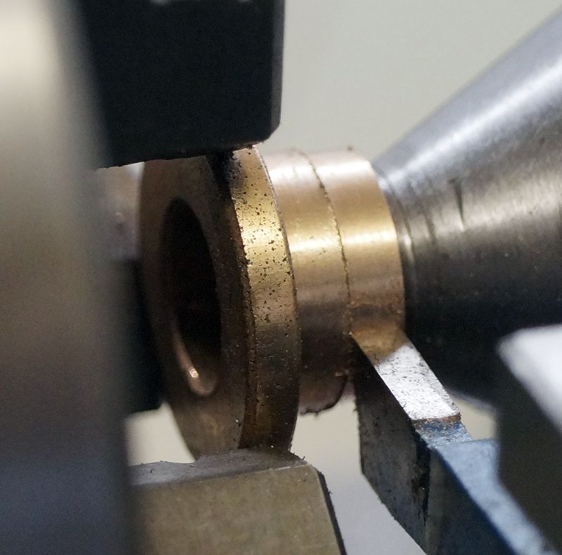

                    I knew the grooving tool would come in at some point and its sooner than later, ideal in a tight space. Saved buying more oilites (£20) I modified some I already had. smiley
