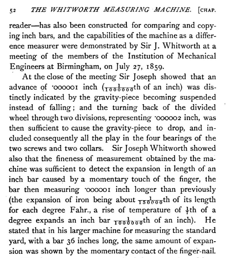

              Posted by Michael Gilligan on 09/05/2020 05:24:56:
              dont know
              I wonder how they predict the finished size
              Same way they do with any other CNC machines or do you have a specific query about that job?
              #470318
                Posted by JasonB on 09/05/2020 06:56:56:
                dont know
                Just thinking about the likely temperature rise … or is it all just fireworks for show ?

                        For context … Here is one of my favourite ‘Whitworth’ anecdotes:

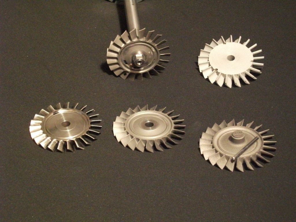

                                    Milled these turbine blades from 718 inconel ,not particularly hard material about
                                    40 rockwell the main problem it work hardens if the tool is allowed to rub.
                                    The 3 on the left were milled manually with a rather precarious setup of fixtures ,rotary
                                    tables and indexers long before i had any cnc machines somewhere around 2001.
                                    The cutter resting on the cast wheel on the right is a Dremel 12 tooth 9903
                                    tungsten carbide carving bit , surprisingly these will mill this material quite well
                                    after the discs are gashed out with an angle grinder.
