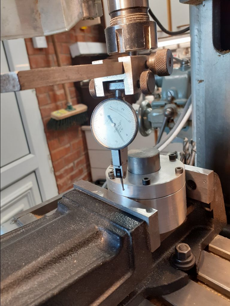

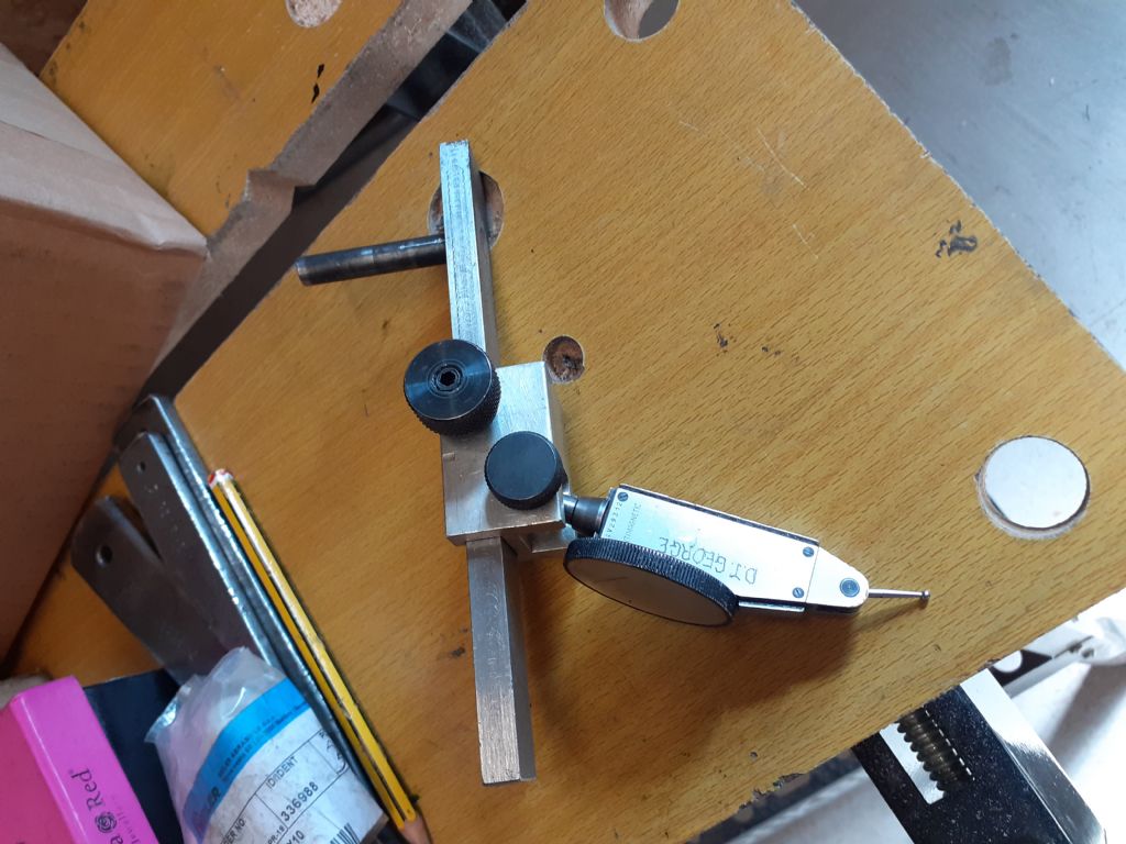

                  #622408
                  David George 1
                    @davidgeorge1
                    This is my center finder for round items in the mill. Made when an apprentice.
                    David
                    #622416
                    duncan webster 1
                      @duncanwebster1
                      You should have had that in for the Stevenson trophy. Not too late for a MEW article.

                        #622424

                          #622426
                          derek hall 1
                            @derekhall1
                            David,
                            I like your centre finder, I never got to make as anything as useful as that during my first year apprenticeship ….last century !!!!
                            I would like to make one of those…
                            That device is exactly the sort of project, in my view, that newcomers to our "hobby" could make as it would be useful, quick to make, very cheap to build and a good introduction to metal bashing.
                            Regards to all
                            Derek

                                  Clive Foster
                                    @clivefoster55965
                                    As will be obvious from this thread there are plenty of devices and methods around. I've got, or have used pretty much all of them except Howards pivoting V at one time or another. Dunno how that one slipped the net!
                                    Basically perm the most appropriate selection from accuracy, ease of use and price depending on what you do, how much time you have to spare, cheaper solutions tend to be slower to use, and how deep your pockets are.
                                    However if I were starting over with the usual neophyte budgetary constraints I'd settle for the "bump and pull a ciggi paper" method whilst putting my "purchase a device pot of money" towards getting a proper DRO scales and console set as soon as possible. A good DRO is win-win pretty much everywhere on a milling machine so a far better bang for buck overall.
                                    I really like my import co-ax indicator but the £60 or so should come after the DRO has been gotten. I could seriously argue that a decent Huffam wiggler should come before the co-axial indicator. Regrettably the less costly wiggler sets tend to be inconsistent in operation and of variable quality.
                                    All of which assumes you already have a lever indicator as shown by David George. Which really has to come first. Davids carrier bar is a nice easy project and very useful once done. Verdict listed a similar, albeit shorter, device but the price wasn't friendly. Mine was used E-Bay inexpensive but I didn't realise how inexpensive until I saw the catalogue price!
