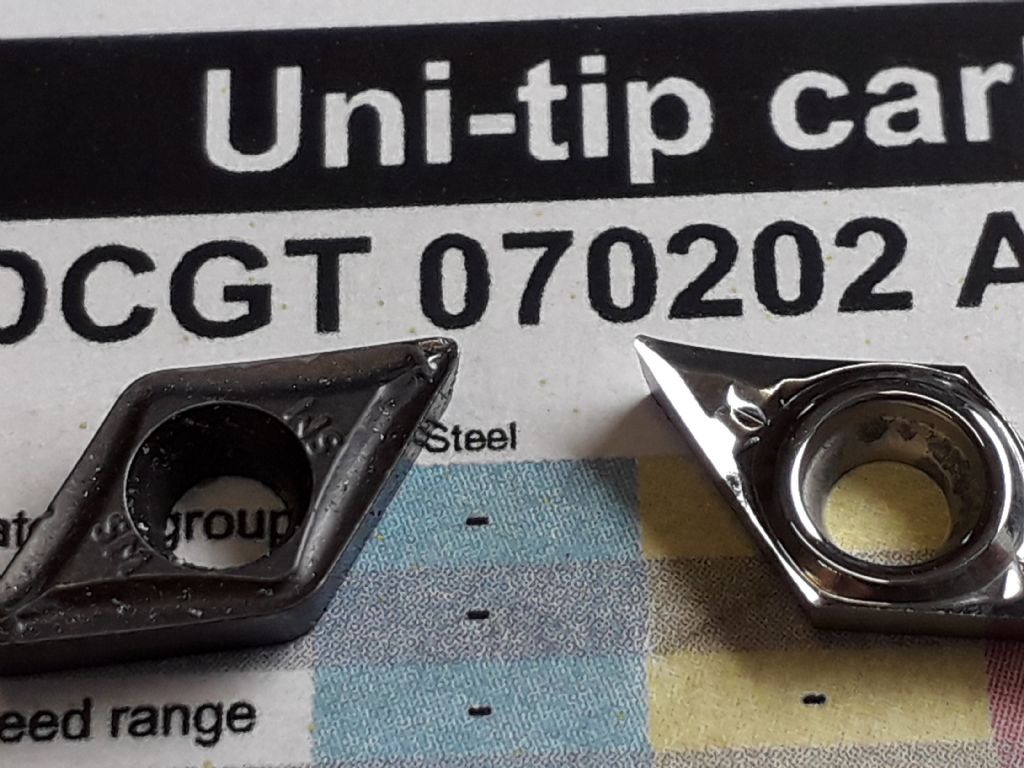

                                        Posted by Dr_GMJN on 10/05/2020 11:13:42:
                                        How does this affect cutting performance (assuming the actual cutting geometry is the same as an M designation)?
                                        That's a wrong assumption, the cutting geometries are different. The ground insert generally has a better defined edge and a higher rake angle. Since it is ground the surface finish is better and thus swarf is less likely to stick to the insert. That's important when turning materials like aluminium. Moulded insert on the left, ground on the right:
                                        Ground inserts are intended for non-ferrous materials, although of course they will work with ferrous. I don't use them for ferrous as the edges are a bit delicate.

                                          What Andrew says, **GT tend to have a crisper edge so are happier taking very fine depths of cut and also less likely to deflect long slender parts. The polished finish helps stop aluminium building up on the tip and they have a higher top rake angle which although not teh usually suggested geomerty for brass works very well and can actually reduce that shower of chips that a zero top rake tool tends to produce.
                                          This shows a 0.2mm tip on the left of the DCGT type and a 0.4mm DCMT on the left.
                                          Same DCGT taking a 1 thou cut off EN8, probably easier to see the swarf as it pile sup on teh cross slide than coming off the tool.
                                          Different types of swarf
