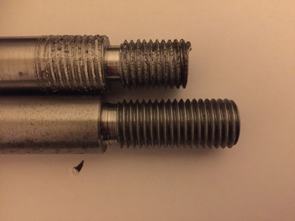

        More a beginner's observation than a question perhaps.
        A while back I started a topic on thread cutting with carbide inserts – thanks to advice from here and experimentation I thought I'd cracked it. Imagine my horror when I needed to make an M16x2 thread on the end of a bit of 3/4" EN1A bar and found I was back to square one, or worse.
        After much faffing about with all the variables I sent a street urchin round to my mate Sherlock – he came came back with the response "When you have eliminated all which is impossible, then whatever remains, however improbable, must be the truth. It is the metal". I didn't really believe him, but chucked up a bit from another bar anyway.
        Annoyingly he was was right yet again! Both (supposedly) EN1A from the same supplier, green blob on the end of the bar, but behaved quite differently. How can this happen?!
        Watson.

          I don't think anyone would call that top piece free cutting.
          I just bought a UNC die and a bar of EN1A from GLR to avoid exactly this little snag, I still have faith.
          Hmmm.

            Was it the very end of the bar? Sometimes the end bit is not much good. Something to do with the production process.

              Yes it was – I just turned off the wonky end of the rolled bar, perhaps about 3/16". Maybe that's it.

                I tend to buy most of my steel by the bar length. Usually 3 metres long, this is cheaper and I like having a good stock.
                As standard practise I cut the first 2"/50mm off the end and throw it in the scrap box.

                  As someone who spent a lot of my working life bughunting software, I can tell your mate Sherlock that 'eliminating the impossible' opens up a truly vast field of wasted effort in searching for a cause. You'll start by looking for the most impossible answer, and before long you'll've checked so many candidates that you'll never remember which one's next or whether it's sufficiently different to those you've already checked to justify another look. It's absolutely the worst possible way to investigate anything.
                  The two most likely reasons are:
                  i) work-hardening at the end of a bright-drawn bar
                  ii) inclusions of different steel types in a cheap gash melt.

                            Most likely it's the bar end. Whilst Black Steel and Bright Mild Steel have exactly the same chemical composition, their physical properties are noticeably different. It's because rolling steel Bright Mild Steel involves reheating and work hardening. In the same way cutting bar steel adds an area of suspect behaviour.
                            Can't agree with Mick's suggestion the cause is 'inclusions of different steel types in a cheap gash melt', because it implies steel is made haphazardly in small quantities. Actually steel making is high-tech, with perhaps several hundred tons of metal heated well above melting point, chemically analysed and then purified in the furnace to meet a particular specification. Slag eroding off the furnace might cause inclusions, but unmelted ball-bearings are unlikely. It is possible for trouble to occur later when the steel is cooled and processed. Cooling too fast or too slowly will change properties, as will cutting fast and hot, rolling, or missing out stages such as Normalisation because many big customers prefer to do their own.
                            Another problem might be our determination in the UK to buy 'EN1A'. "Emergency Number" specifications were forced on the British Steel Industry by government because the War effort demanded consistent steel, rather than whatever Hadfield, Firth, Colvilles, Dorman, Consett, Guest and all the others happened to be pushing as their proprietary free-cutting mild-steel. Although chaps swore by certain Brands, defeating Nazi Germany required Industry to behave consistently. Standardisation did the job so well EN numbers survived: no-one went back to the pre-war buying methods.
                            As the Emergency Number system is long gone, I suggest 'EN1A' today isn't a consistent product. As far as I know, no-one in the world makes actual EN1A, though there are many steels like it. Therefore what you get is a similar steel, like 220M07, or 230M07, or SAE1113, or SAE1213, or Workstoff 1.0711/1.0715, or JIS SUM25 or whatever else the supply chain thinks best. Almost for sure it's made in the Far East in a modern steel plant.
                            I feel it's a good example of old-fashioned British engineering conservatism causing unnecessary confusion: EN1A entirely ceased to be in 1991, yet it's still what I have to ask for in my local stockist. I've had better results since telling them I want to machine the steel. Pretty sure I'd get a different mild-steel if I said it was to be welded. I'm fairly sure that today's metal 'quality' problems are more to do with people having the wrong specification rather than the metal itself being faulty. There are a tremendous number of different steels in use compared with the last century. Life isn't simple, especially machining unknown scrap or one of the less suitable alloys. I reckon the Golden Age of straightforward home engineering ended about 1970, since then Industry has moved ever further away from 'our' materials and techniques. Unlikely that anyone will make an IMLEC winner featuring stampings, ground and laser cut components, welded stainless steel, extruded & die-cast plastics, robotic assembly, a FEM analysed and computer optimised design, low carbon emissions, and half a dozen microcontrollers!
                            Simple answer to Robin's question, buy free-cutting steel, check how it cuts#, and avoid the ends!
                            # My stock box contains samples of 'EN1A' rods and strip bought at different times. Although it all machines reasonably well there are obvious differences between some samples. The differences are more noticeable with Carbide than HSS, requiring up to 20% more-or-less speed, depth-of-cut and feed-rate for best finish.

                                              Although the immediate problem was solved by using another bar I tried cutting the thread on the other end of the original piece, about 500mm in from the factory end, to test Hopper's suggestion that it might be an 'end effect'. No better. So it's just a crap piece of steel, for this purpose anyway.
                                              This has all been quite enlightening for me. In retrospect I should have smelled a rat when I skimmed the bar to take off rust/mill marks. It didn't go well, but I put it down to my inexperience – I hadn't tried turning such a relatively slender 500mm piece before. But it went fine with the other piece using the same procedure.
                                              In future I shall make some test cuts to get an idea of how the metal behaves before beating myself up.

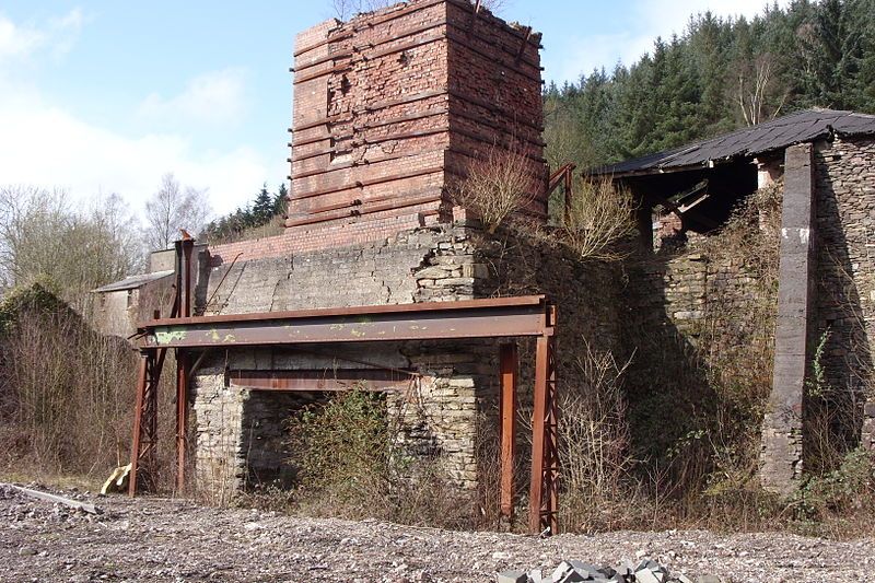

                                                    Maybe, it might have been made in a British Furnace like this, first built in 1711 and closed after various upgrades in 1966, long after it was obsolete:
                                                    Picture Attribition Wikipedia: The photo is of a small manual producer, not very scientific, with quality depending mostly on the skill of the individuals operating it. Capable of good results, but not when the skilled operator is drunk, ill or on holiday! Or his boss insists on cutting corners. This sort of 'stirring scrap in a pot' operation may be what chaps imagine goes on in the Far East. Very unlikely!

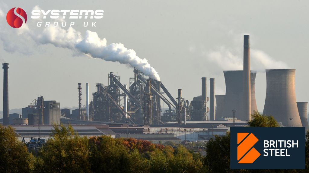

                                                    Far more typical of modern steel-making is the British Steel plant at Scunthorpe:
                                                    Plants like this are highly mechanised, highly efficient, with most sources of human error removed. This is the sort of operation unlikely to make steel containing unmelted inclusions, or steel outside the target specification.
                                                    Sadly the Scunthorpe Steelworks was sold for £1 in 2016 and went into receivership, bankrupt, last year. Nothing wrong with quality, the problem was cost. This relatively small steelworks relying heavily on imported materials and an expensive workforce, couldn't compete with the really big boys. No profit in it.
                                                    To give an idea of scale, 1,808,000,000 tons of steel were made in the world during 2018. China made 928,300,000 tons of it, and the second largest producer was the European Union, at 168,200,000 tons. In 2018, the entire British steel output was 7,700,000 tons, or 0.43% of the world total, slightly less than Egypt. Of course quantity isn't everything, in 2020 steel made in Britain will be something special, high-quality, made in an electric furnace for very demanding applications.
                                                    China's dominance of steel isn't entirely wonderful for them because the market for steel is ferociously competitive and very vulnerable to sudden drops in demand. Large inflexible enterprises catch bad colds : about 2 million Chinese steel workers have been made redundant since 2018, which makes British job losses in the steel sector look like chicken-feed, agonizing though they were. (In the UK, about 250,000 lost jobs since 1967, or roughly 50 years). Change in the steel industry, wherever it happens to be located in the world, can occur quickly. British steel production peaked in April 1970 at nearly 2.9 Million tons, but collapsed to 0.13 Million tons in February 1980.
                                                    It's not that I believe inclusions are impossible, only that modern steel production methods make them far less likely than in the past. Can anyone post a photo of a recognisable inclusion found by them in a bit of modern metal? Slag is far more likely than ball bearings and gears!
