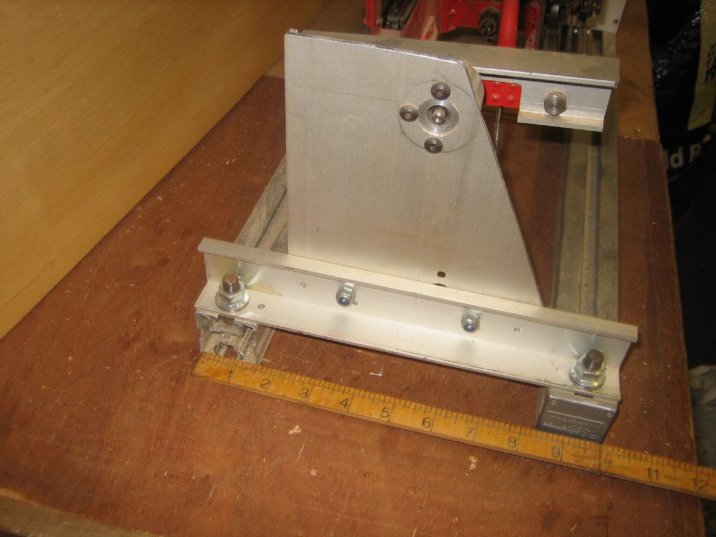

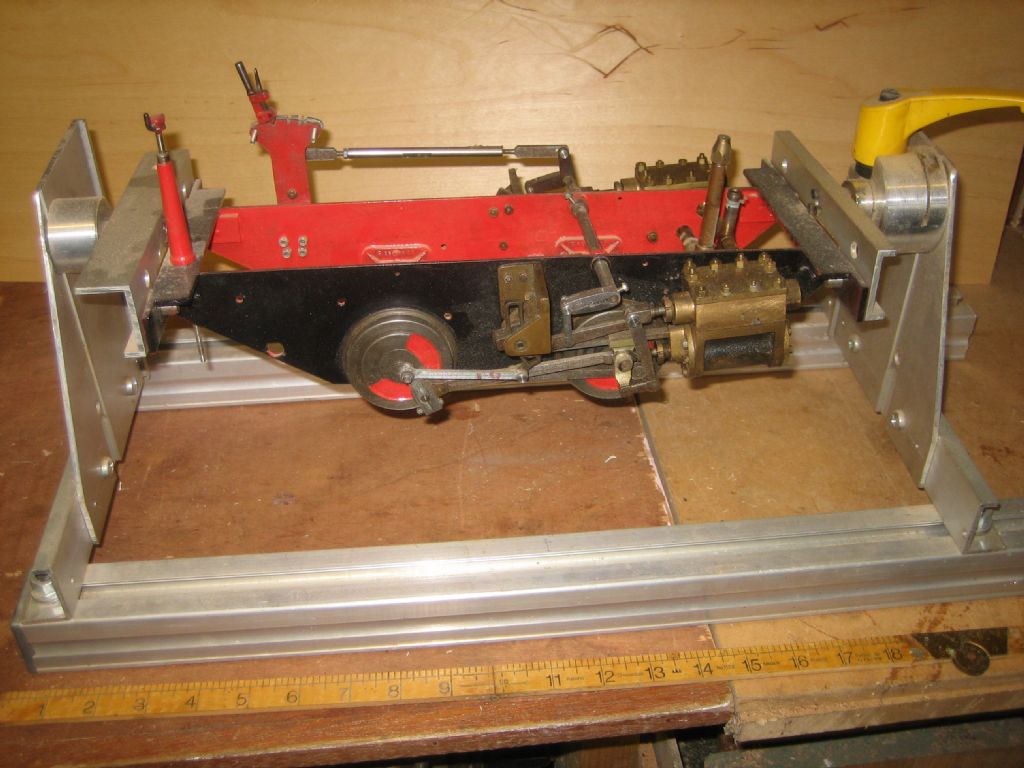

Here is my Building Jig made from Aluminium T slot profile section and some bits from the "Left Over/ Come in Handy" box!

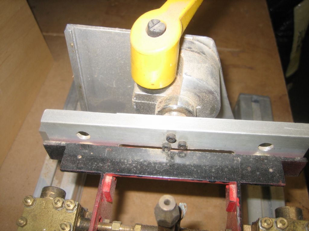

The right hand end has a clamp to hold the Loco when rotated, The Loco [Tich in this case] is supported by unscrewing the Buffers and bolting on the angle plates to the Buffer Beam at each end . There is a cutout in the angle plate to clear the Draw Hook
Took an afternoon to put together, The T slot Profiles were left over from a Solar Panel installation! The Upstand ends are some 1/8 " Aluminium Panel from an IBM computer cabinet . The Yellow clamp handle …a spare for the wood lathe Tail Stock.
