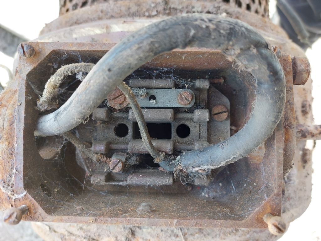

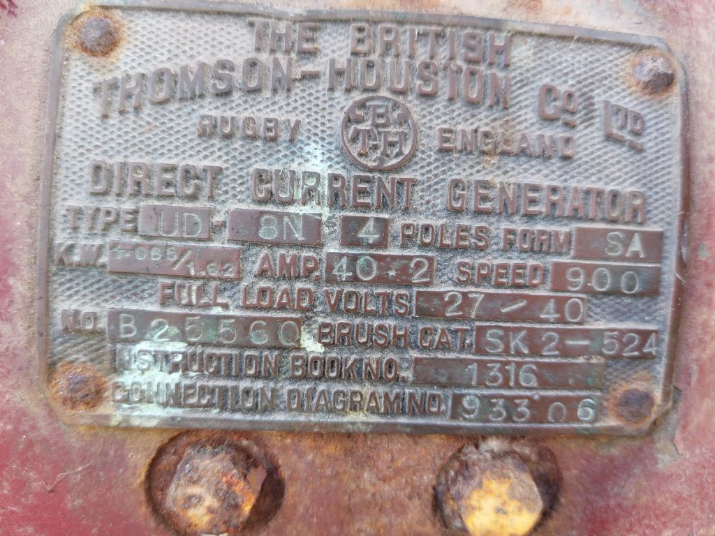

      I have a British Thomson-Houston (BTH) Dynamo/DC generator … 40 Amps at 27 to 40 Volts. I believe it may have been used to drive a fairground ?
      I need a wiring diagram. It has 2 light wires coming out of it, but I do not know where they "went" …. I suspect to a rheostat… for perehaps voltage control ?
      Can anybody point me to anywhere I could get the diagrams (I suspect it is 1930 to 1950 vintage.

        #603134
        john fletcher 1
          @johnfletcher1
          Can you take a picture of the machine and its terminal box and are you certain that it is a generator and not a motor, circuit wise they are the same. Those thin wires are the shunt field pair, one of the thin pair would have been be connected to one of the main terminals and the other to some form of voltage regulator then to the other main terminal, a parallel group. I have seen at a traction engine rally where the operator used a rheostat to control the voltage to the the bulbs around the engine. John.
          #603147
          bernard towers
            @bernardtowers37738
            Yes if it was a dynamo I would have expected only one output wire and usually an insulated stud in the body, the second connection being the frame.

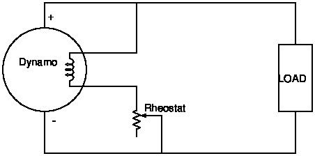

            #603152
              Simplest possible circuit is like this:
              The wires allow amps to flow through a field winding inside the dynamo, much increasing the magnetic field and the machine's ability to generate power whilst also providing a way of controlling the output voltage to suit the load. The rheostat is a high-power resistor, usually wire-wound, and cranking the handle controls the strength of the magnetic field by adding more or less resistance to the circuit.
              The circuit is very old-fashioned in that it requires an operator to manage the output. Typically only used on constant loads such as a set fair-ground lights. Automatic control circuits were soon added; these cope with varying loads and don't need an operator. Various ways of doing it: motorising the rheostat, using contactors to disconnect the winding when the volts went too high and reconnect it when they went too low. Most common I think was an arrangement of contactors that provided fine control by adding or removing fixed resistors from a selection. These days it's done electronically. Stabilising circuits are more complicated.
              Various problems with rheostats:
              • what value in ohms, and how many watts does it need to dissipate without going up in smoke?
              • avoid burns and getting rid of the heat
              • finding one – being grossly inefficient, rheostats are rarely used these days, and hard to buy
              Guestimating wildly – I hope someone knows better – I'd start by assuming the field current to be about 10% of the dynamo's output, so:
              • rheostat ohms = 40V/4A or 10ohms, and
              • heat I²R = 4A * 4A * 10ohms = 160W.
              Suggests a rheostat of, say, 0 to 40ohms and rated for 300 or 400 watts. Probably necessary to experiment – I don't know what the field current of a BTH Dynamo should be – when new, it would have been in the manual!
              #603159
              Joe Hurley
                @joehurley96100
                Thanks v much Dave and all for informative and technical replies.
                I have photos of the brass plate and the wiring. I plan to post them when I figure out how ?

                  #603180
                  John Olsen
                    @johnolsen79199
                    The older style of single bar electric radiator element should be about 60 Ohms and is rated for 1kW for the whole element. About 4 Amps maximum current. So you would probably want to arrange two pieces in parallel so it does not have to run at red heat. A Carbon brush scavenged from a motor would make a good slider.
                    That is if Dave's estimates are about right, they seem reasonable.
                    Sometimes older generators used a vibrating contact style of regulator, these were quite usual on cars into the sixties, until alternators took over. The on/off time of the contacts reduced the current through the field to regulate the output. These were of course used with a battery which would help greatly in reducing any output voltage variations.
                    These days it might be easier to come up with a circuit using power MOSFETs to control the field current. The circuit could easily be small enough to conceal somewhere if you want to look authentic.
                    #603195
                    noel shelley
                      @noelshelley55608
                      Johns idea is good ! I needed a power resistor and happened to have a stock of new/old electric fire elements ! for variable resistsnce a starter motor brush would work as the slider.DO NOT try to run this machine without a load ! A 28V(24v) CAV regulator as used on the AC7 alternator might be able to be adapted to suit. Noel.
                      #603211
                        Found a book describing a 500W dynamo that quoted 2A for the field winding, so I'm a shade more confident the 4A guesstimate is in the right ball-park.
                        Electric fire elements are a good idea, and for a test, you could just substitute an electric fire for the rheostat, wiring a domestic socket so it can be plugged straight in. Doesn't matter if L is connected to + and N to – or the other way round. Earth not needed on a 40V circuit, but as always treat electricity with due respect, shorting out 40A could start a fire, and DC arcs aren't self-extinguishing.
                        Don't use a fan heater – the element might overheat because 40V won't run the fan needed to keep it cool.
                        #603420
                        Joe Hurley
                          @joehurley96100
