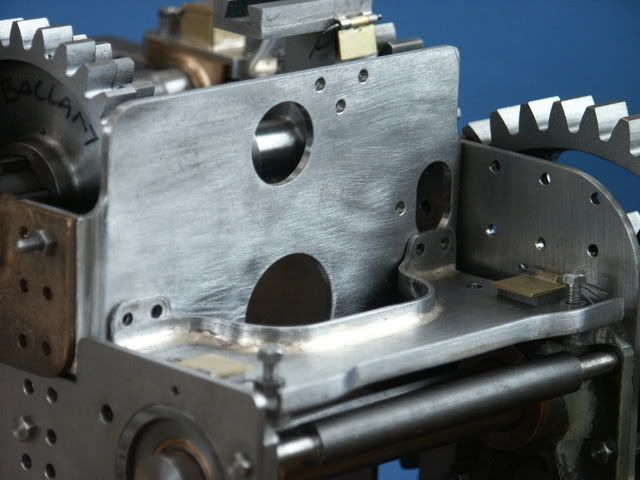

                                                Working on the water pocket back plate
                                                Can anyone offer any advice on how to drill the small hole for the hinge pin.
                                                So far i have broken 3 drills and scrapped the first back plate.
                                                Thanks in advance,
                                                Brian
                                                #271483
                                                Richard S2
                                                  @richards2
                                                  I didn't follow the book on this part. I used 18 gauge for the back plate and 20g for the Body/Lid.
                                                  It meant I was able to avoid drilling the holes!.
                                                  I used 1/16" diameter brass tube and silver soldered it to the edge of each piece and carefully cut/filed to fit the 2 hinge pieces together. 1/32" dia pin joins 'em up. Not sure what metric sizes are around now, but you can make your own tube to size with less risk of breaking Drill bits.
                                                  I managed to make tubes for my 1/4" square Oil Box Lid hinges down to 1mm dia with 0.5mm bore on the old Peatol (Taig) no breakage-
                                                  #271490
                                                    Can't remember how I did mine now but it is to the book.
                                                    Few thoughts
                                                    1. thin down some flat brass section as this is a harder brass than if you use sheet so less snatchy
                                                    2. leave parts oversize until you have the hinge working then if anything wanders it can be accomodated
                                                    3. drill the backplate from either end, don't try going right through
                                                    4. as said solder tube to each edge and then mill the knuckle which is how these oil pockets are done
                                                    5. use thinner material and form the "hole" by bending the metal round, the hasp and staple here is about half the width of the water pocket
                                                    #271730
                                                    Brian Abbott
                                                      @brianabbott67793
                                                      Thanks both,
                                                      Going to try soldering the tube idea, see how that goes.
