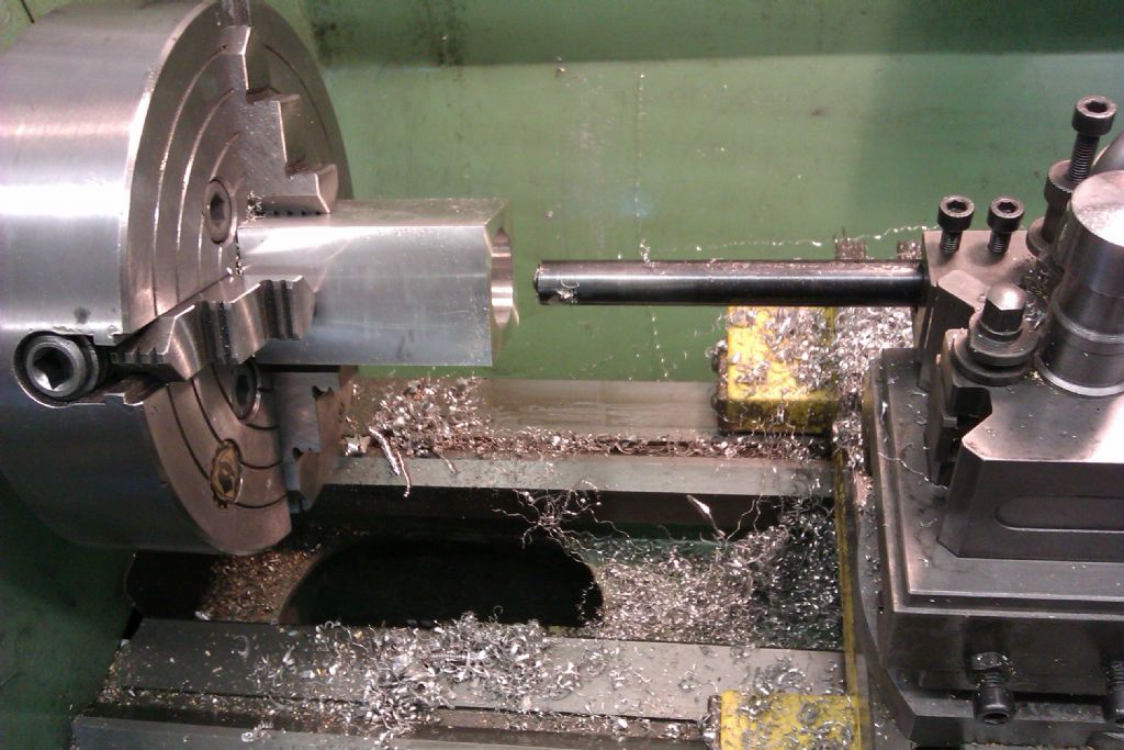

                  You should be able to get away with a simple homemade one. Take a piece of 1/2" or 12mm BMS bar, cross drill about 5mm in from one end 4mm to take a round HSS toolbit. Drill and tap in from the same end for a M4 grubscrew. I think I used this same bar many years ago when I did my stuart beam. As you can see it does well over 3x dia which is the often quoted max overhang.

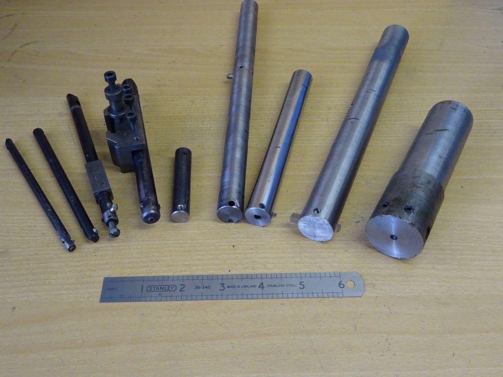

                  If thay had them in stock then this set from Tracy would be as cheap as making them.
                  In true Blue Peter style this is one (or two) that I prepared earlier from 1/4" upto 1.5"

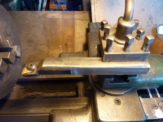

                        Hi Martin,
                        If you want a more rigid boring bar, buy one that is bigger than you need and machine it to suit your tool holder as shown below. Bought this one on %-bay for $10. (it was originally round)
