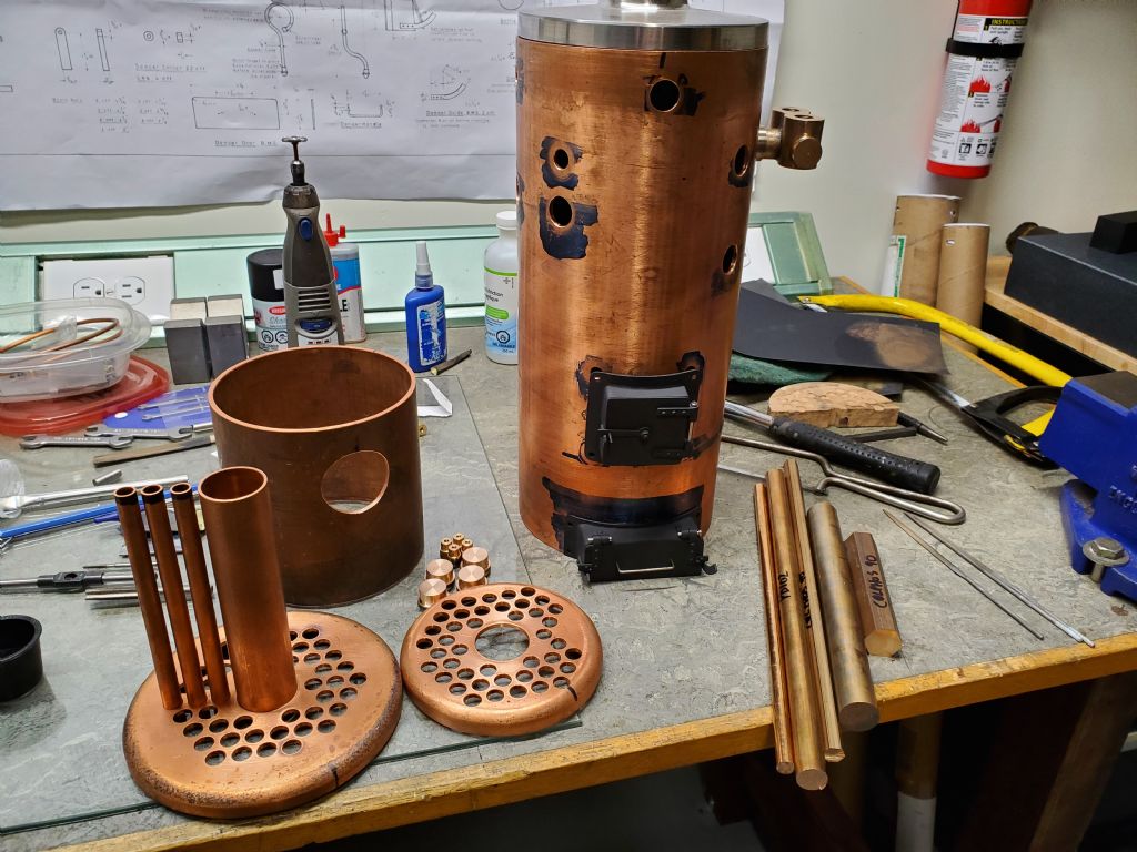

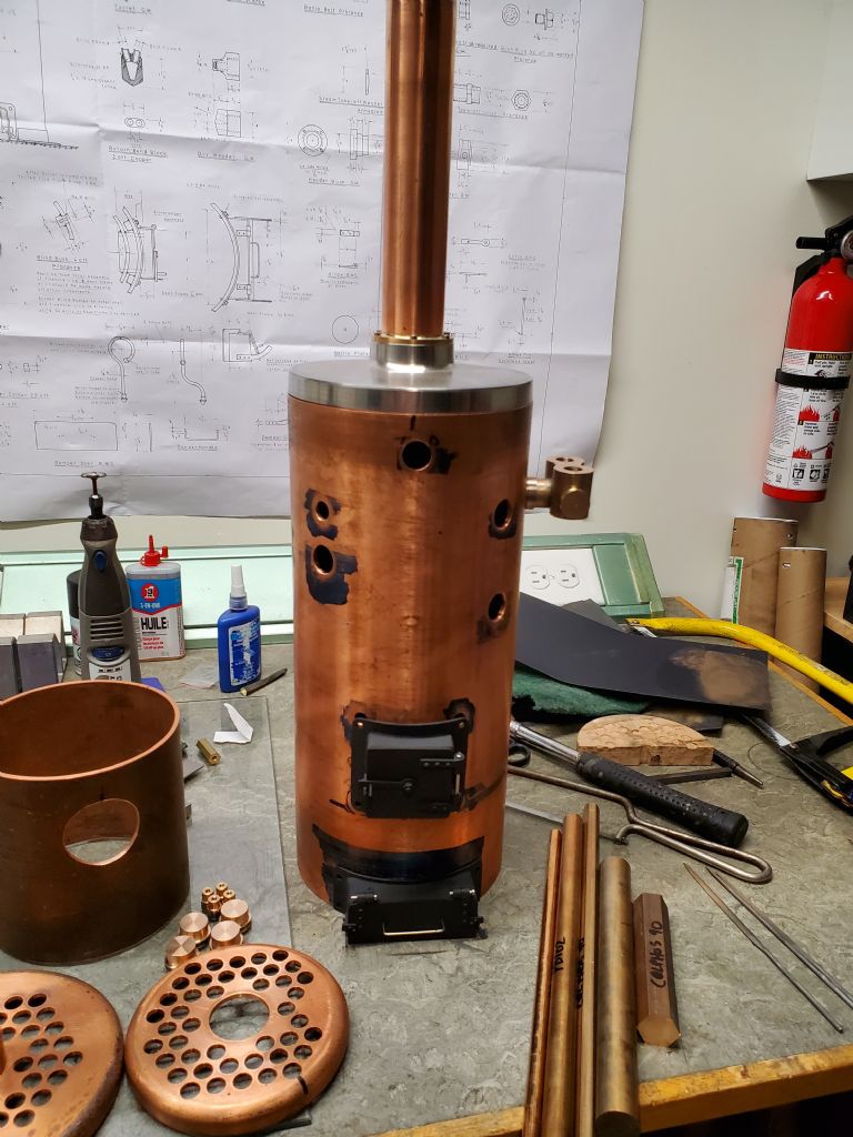

                I will try to post a few pictures later for interest purposes….
