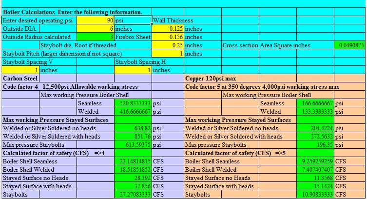

          It would have been nice to see some actual test pieces and compare them to the theory.
          Although the authors say at what pressure the barrel will start to deform permanently they do not say by how much, if only a thou or two is that going to be a problem or will it end up looking like a balloon? Paul, is there an allowable deformation in diameter in the Aussie code or must it be zero?
          With modern methods it would also have been good to see the two methods shown with FEA
          It also makes no allowance for the fact that a boiler is likely to have had a few tests done by the builder at hme often starting at les sthan 2x WP which will start to harden the copper.

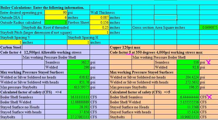

          The loco boiler calcs are quite similar only being 4 thou difference in thickness but the Harris boiler is a big difference 0.091″ Harris to 0.168″ yet many have been made over the years and I’ve not heard of them going barrel shaped.
          Putting the Harris figures from p31 into the spreadsheet that several of the current commercial boiler makers use then it is still over allowable figures so is there a need to go 50% thicker with the barrel material? Paul what would the Aussie code require for a 6″ boiler at 90psi WP?
          boiler calcs
          Later in the book Harris shows his actual design for a 6″ vertical boiler which has 1/8″ thickness barrel (could be where the article got the 3mm from?) that is almost double the allowable factor of safety figures
          boilers 2

            Ops I think I spot a cock up or two.
            For the Harris example they give the shell thickness twice as per the other example but have the first as 3mm and the second as 0.0865″ should that 3mm be 13swg in a similar way to the first examplethat gives SWG and then decimal thickness?
            However the main thing that looks wrong to me is that for the Harris example the 90psi working pressure has been multiplied by a factor of 3 not 2 for a test of twice working pressure. This would give a result of a wall thickness of 0.122″ rather than their result of 0.168″
            Think it is time for a letter to the mag unless the learned gentlemen are reading and would care to comment?

                        Oh Dear, Harris uses inside diameter on page 31 but they have applied the 6″ as if OD in their calculations assuming they are using OD as shown in fig 2.
                        I don’t have a problem with the suggested method but with errors it is going to be hard to convince people to change. Even more so when the corrections are made and there is only a few thou difference in wall thickness between the two methods.
                        Am I expecting too much that with their results showing such a difference in thickness and no reported failures that they may have gone back and checked the calculations, particularly as it was a joint effort at least one should check the other?
