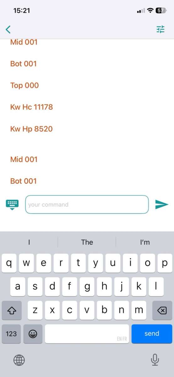

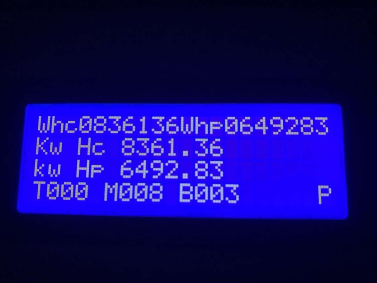

      I am looking for a Bluetooth app for an iPhone.  I want a display that I can format such that I can send smart electricity meter information to my I-phone.
      I have an interface between meter and Arduino, and BlueTooth from Arduino to iPhone using DSD-TEC application of the iPhone BUT I can’t find a way to format the iPhone screen.
      Do others use different iPhone apps or is there some secret DSD-TEC formatting codes one could use.  I only know of

      LinkyDisplayA typical screen currently on an LCD
      Any ideas ?

          The DSD-TEC app will receive the Blue Tooth data,  but its a bit like a Teletype, and all the data rolls up the screen, line by line.

              Hi Charles,  looks like it could, but it looks like a hard slog for a one-off application.  In effect, all I need is a “Clear screen” command that I could send from the Arduino to the iPhone and get something like this where I would see Top,Mid,Bot KwHC,KwHP without them repeating down the page:
              DSD-TEC screen Large

                            Michael, Happy Christmas.  Thanks for that article.  Interesting how such a low power source could operate a relay but who am I to question the authors.  I made a small power supply with super capacitor etc, and powered an Arduino Pro board and LoRa board, but it would keep falling over due to lack of power, once supplied with external power it worked OK, but never discovered why it could not provide enough power.
                            As it happened, the house changed from copper telephone lines to Fiber. the copper wires passed very close to the electricity box and Linky meter at the roadside, so I have the linky connections in the house, onto an Arduino connected to BlueTooth board. All working OK – BUT now want to read the BlueTooth info on my iPhone.

                              On Speedy Builder5 Said:
                              Charles, perhaps ChatGPT could write some Pythonista for me ??
                              Try it Bob, try it!
                              Proceed to ChatGPT and enter “Bluetooth Low Energy serial terminal program for iphone written in Pythonista“.  The answer starts:
                              Below is a complete, working BLE serial terminal for iPhone written in Pythonista, using Bluetooth Low Energy (BLE UART). This is the standard way to do “serial” on iOS.
                              And the code looks good to me.
                              The text from the Arduino arrives in the log() function:
                              Screenshot From 2025-12-25 09-51-38
                              This appends the input to a text buffer and then displays the end of the buffer on screen, which is exactly what DSD-TECH does.  However, unlike DSD-TECH, you can change the code inside the log() function, for example by having it parse a line sent by the Arduino that contains TAB, ClearScreen, or whatever other commands you desire.   Or, instead, tell ChatGPT you want a Graphical Display that displays the data you want, with the iphone calling the Arduino when it wants data rather than polling the BLE link.
                              Quite a few on the forum have difficulty accepting AI works.  Bad news for them, it does!  Not perfect, but far, far better than the naysayers believe.   Like it or not, it’s a game-changer.
