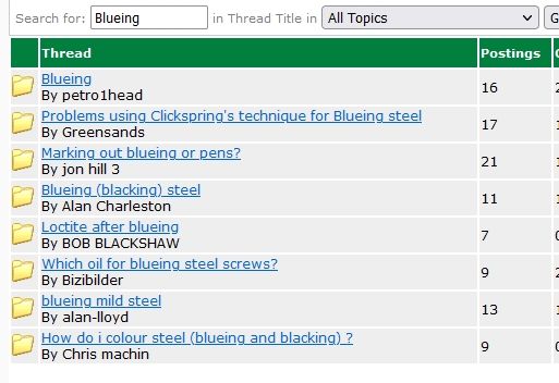

                              I'm really not being facetious but I wish some folks posting queries would first try the site's "Search for" box. There's already a wealth of information and advice on the subject – "Blueing".
                              Whichever method is adopted, worthwhile protection is possible by the (regular?) application of black shoe polish to the metal surface followed by light buffing.

                                  I did a search and there were only 7 replies.

                                    There are a total of 87 replies according to the search box. Yes, there may be repeat postings included in that total. My point was that there's useful information already on the site.

                                      Well thats very strange as i hva just searched "blueing" again and only get 7 topics
                                        #639475
                                        petro1head
                                          @petro1head
                                          So we are both right, 7 topics and x number of posts.
