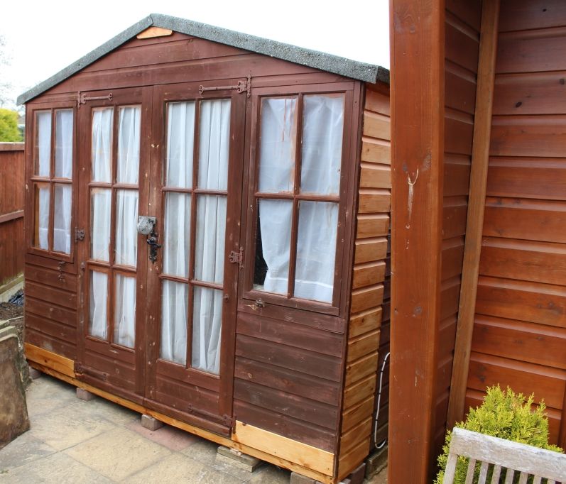

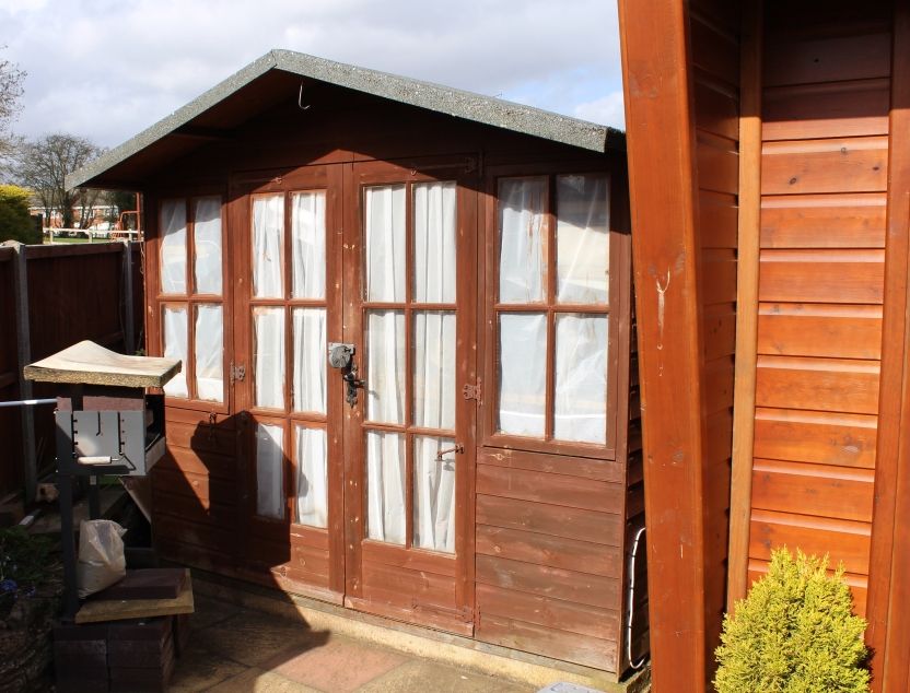

      My workshop has been an 8ft x 6ft summer house which meant that my new lathe choice was restricted to – in the WARCO range – a WM 240. Due to available space in the garden a newer, larger workshop allowing for a larger lathe was not an option. Well there is always more than one way to skin a cat as they say so I have let a "chippy" relation loose with a big hammer and some wood and over two days he has crafted me a stretch job on the summer house. I now have an extra 14 inches – plenty of space now for the larger WM 250.
      Before……………..
      …………..and after.
      All I have to do now is decide on either the belt drive version or the variable speed with powered cross slide version. Any advice much appreciated.
      Rik

        ……..stretching it a bit!

                          I should have pointed out before that the unstretched version of the summer house was home to a now sold mini lathe. It also (and still does) house a lifetimes collection of tooling and other machine tools. All of this is housed in and on custom built shelves and cupboards anchored firmly to the building. This means that insulation is only an option if I gut the innards and start again. Life is to short for that and I will soldier on in uninsulated mode. I do however appreciate the advice and agree that if I was just starting model engineering I would insulate without a doubt.
                          In the six years that I have been using this particular "building" as a workshop WD40 has become my best friend for keeping the rust at bay. To improve things more and as an experiment I am installing a greenhouse type electric tube heater shortly that I will leave on at night when the weather turns cold. Not sure whether a 180W will be enough or to use one with a higher wattage.
                          Rik

                              Nice little shed. You know what you could do – extend the roof out the front a bit to act as a sun/rain shade for those windows. Then in a year or so invite your relative around again……..
