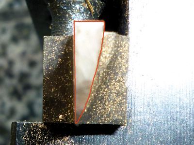

                  #541247
                  Journeyman
                    @journeyman
                    Posted by Greensands on 23/04/2021 16:31:55:
                    If opting for the trepanning route, what would be the recommended spindle speed? Presumably a tool ground as for a parting off operation but perhaps provided with a bit more side clearance would be the tool of choice?
                    Yes, something along the lines of:-
                    I have highlighted the edge in red. Speed as per parting. Make sure inners and outer bits are secured so that they don't come loose at breakthrough. Probably safer to stick to Jason's recommendation and do the last little bit off the lathe.
