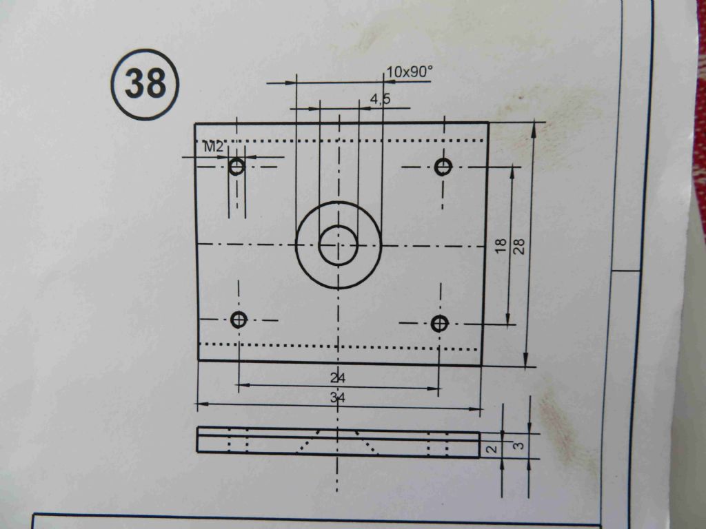

        I have a lifelong inability to translate tech drawings/plans to the solid … not ideal for model engineering!!
        Presently dawdling through the Bengs beam engine Sophie and, having completed the beam support pillar, the base plate is next. It appears to be secured to the pillar from underneath by a 4mm countersunk screw and the plate secured to the wooden plinth by 4 countersunk screws. These latter appear on the plan to be upside down!! i.e. the countersink is between the plate and the wood, rather than on the top surface. How likely is a commercial company to make that sort of error? I am intending to go with commonsense rather than drawings unless somebody can advise otherwise!

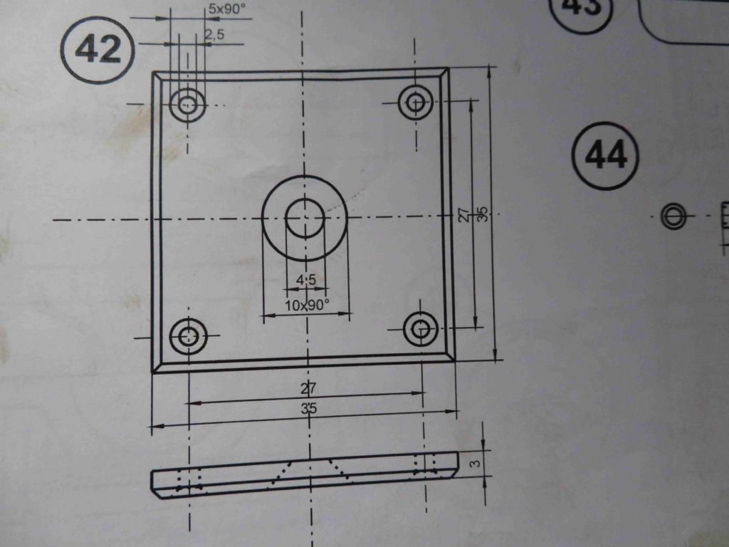

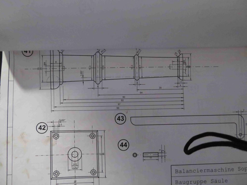

                Apologies Jason et al – should have engaged brain re. pics. See below
                As you will note, the 'instructions' have lost a little in translation … almost a touch of the 'Stanley Unwins'!
                The part 42 drawing shows the 4 corner holes as having the countersink facing upwards but I assume they are to enable the pillar to be fastened to the support block (??) so should face downwards – yes??

                #371551
                  The 4 corner holes are shown correctly with the CSH in the top face which has the decorative chamfer all round and the central one should be the other way round so the larger screw comes up from below. The side elevation below the plan view is showing the part upside down.
                  I think I would be tempted to use studs and nuts for the corner fixings rather than CSK screws.
                  #371552
                    I think its (a) drawn upside down and (b) the centre hole should be countersunk from the other side.
                    Looking at the GA the plate should be mounted chamfer up, and screwed to the base with the four screws (just visible in the GA top view) so the centre hole attaches the plate to the column.

                      I can't imagine that a full-size beam engine's centre column baseplate would be held down with huge slotted countersunk screws. So I'd be with Jason for studs and nuts on that.
                      The drawing has the usual bizarre orientation of a first-angle projection, with the additional error that the centre screw countersink is indeed on the wrong side. So I'd be with Neil on that.
                      Interesting and revealing that Jerry can mess up just as much as anybody else. The translation is so bad that it suggests the original German wasn't especially lucid.

                        Jason, Neil, Mick, thank you. That all makes sense and I'll go with the hold-down studs as well. Given the quality of the 'plans' and instructions, I may well return for further (much needed) assistance!

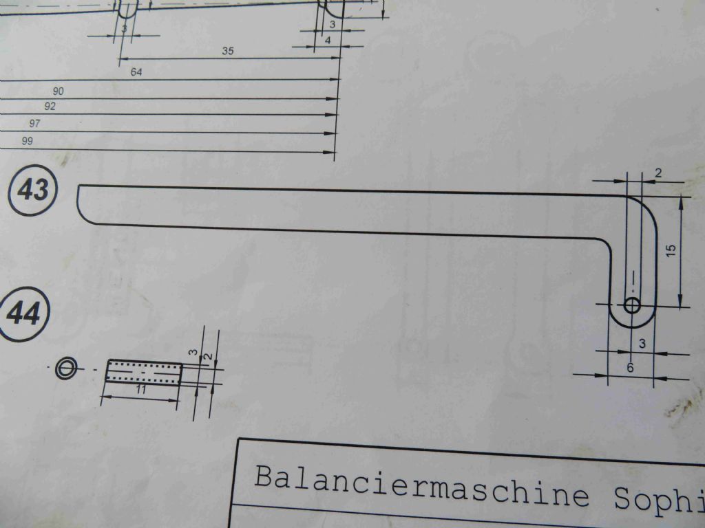

                                      Howi et al – plodding on with Sophie and need to attach the parts 43 (2off) to part 38, which has preformed 3mm rebates for the purpose. I am assuming that the options are soldering or super glue. My soldering talent is pretty awful, so I'm inclined to loctite or similar. The 43s provide support for part of the beam motion. Would Loctite be suitable? If soldering has to be the method, would paillons of cored electrical solder be suitable or what is recommended? Material for both is brass.
                                      rgds
                                      Bill
                                      #374202
                                        I think soft electrical solder would do on a small engine like this.If you have separate flux apply some first.
                                        I would be tempted to make use of the M4 clearance hole for a screw with large washer/plate and a nut to clamp the two arms onto the column top and also put a spacer (24mm? ) at the far end of the arms to keep things parallel and slip a 2mm drill through the holes too.
                                        #374216

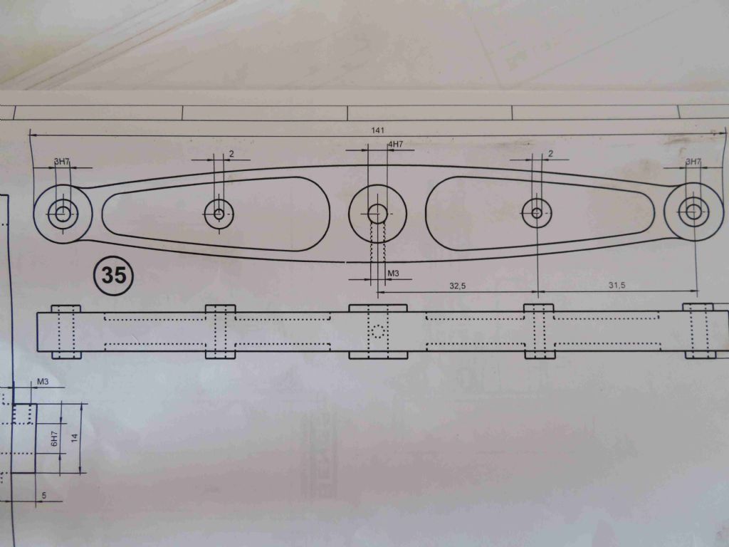

                                            Another cry for help, please!
                                            The beam on Sophie is annotated with measurements I don't understandblushviz. "3H7 and 4H7". Could someone point out what is , probably, obvious?img_0206a.jpg
                                            rgds
                                            Bill
                                            #374465
                                              The Germans like to put tollerances on their drawings. The H7 part is the tollerance the holes should be made to which for our purposes means that these holes should be reamed rather than other holes that just show the diameter which can simply be drilled.
                                              So 3H7 means a hole reamed to 3mm nominal with a H7 reamer and 4H7 means a hole reamed with a H7 reamer.
                                              On small holes like this drill say 0.2mm under nominal and then ream.

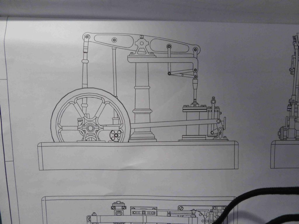

                                                  First post (hope I am doing this correctly!
                                                  I am building the Bengs Sophie and struggling with the lack of information regarding the cylinder assembly..
                                                  i cant work out how part no. 11 (which is not named) , part no. 12 which is the slide Valve and part no. 13 which is also not named all fit together..
                                                  I assume that part 11 is soldered to the cylinder sleeve and part 13 is screwed to part 12 the slide valve, but i cant see how the slide valve is fixed to part 11?
                                                  What confuses me is that part 11 is also drilled and tapped like the slide valve to fit part 13 and i cant see why
                                                  Any advice would be GRATEFULLY received
                                                  Regards Garry

                                                      Thanks for the response Jason, its nice to know that there is a community out there that may be able to help.
                                                      I have posted four photos showing the information that i have, as you can see there is not much. I am a retired qualified engineer and like to think i know my way around drawings and instructions but there is not enough for me to work this out. This is the first model steam engine that i have tried to build and it was supposed to be the easy one as i have an Allchin Royal Chester Traction Engine that i bought (part built) waiting in the wings. Getting very nervous about this one now.
