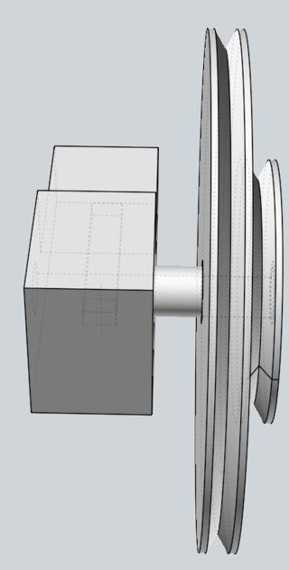

        I am making a small "backshaft" for my Taig lathe, and am wondering where is the best place to put the bearings. In the pulley with a fixed shaft, or in the bearing block with the pulley fixed to the shaft.
        The large pulley is 80mm, the small one 20mm, the shaft is 8mm (or 10mm) steel, and will use a couple of 8 x16 x 5 bearings. Block & pulley will be aluminium. The Pulley profile is for a 3mm Gates belt ( as used on the lathe).
        If I mount the pulley firmly on the shaft, I could use the shaft as a mandrel for turning the pulley and ensure concentricity – but I then need to work out how to stop lateral movement of the shaft in the bearing block.
        Putting the bearings in the pulley would make it a bit harder to ensure concentricity, but makes lateral positioning easier – small step on the shaft, and a nut or similar on the small pulley side.
        Could I ask the the wisdom of the forum for thoughts, ideas or gotcha's before I make yet more scrap.

          As a Peatol user I am interested to know the use of this. Personally I would have the pulley fixed to the shaft and the bearings fitted to the block with retaining caps/plates/screwed rings. If the block is bored with a hole clearance size for the shaft and a stepped bore for the bearing minus 5 thou screwed cover plates would do the job and make for ease of maintenance.

                The block will be 20mm wide and I will be using a couple of bearings in either case. A concern with the step and nut approach on the bearing block is where the axial squeeze forces applied by the nut would be carried. To avoid them being transferred to the sides of the ball races, I would need a spacer between the two inner races and the bearing block would need sufficient room for that to rotate. That also implies that all the radial loads caused by belt tension get transferred to the block via the ball races – so two 5mm supports at opposite ends of a 20mm block.
                For bearings in the pulley the two bearing centres could be clamped together ( with a very small spacer to allow rotational clearance) giving in effect a (small and cheap) double row bearing. The radial loads get transferred through the whole length of the 20mm shaft set in the block.
                I think I am convincing myself to go the pulley route. As usual dialogue here clarifies thinking in a way I can't do on my own.

                  You are lucky to have a choice, both ways would be usable, but I would tend to lean in towards having the bearing/s in the pulley for slightly better rigidity.

                    Also, if you over-hang the pulley as in the drawing, minimise the overhang by reducing that gap between jounal / axle-block and pulley face as far as possible.

                      Whichever way you do it, the bearings should be a light push fit in the bit that goes round, ie on the shaft if the bearings are in the block, or in the pulleys if t'other way.
                      A purist would say that the bearings will last longer if in the block , but either will see me out, so I wouldn't get worked up about that.

                          Operating with the load axial to the bearing is always the better option. Outboard bearings will always be pulling off-centre – imagine a huge overhang. The usual way, if large over-hang is unavoidable, is bearing support on both sides of the pulley. Moving shafts are far better employed in transmitting the power to the other end of the shaft.
