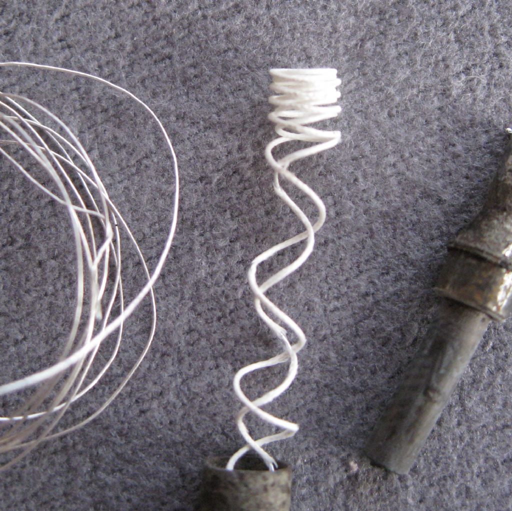

        I have some 'wire' which comes from the tip of a Metcal induction heated soldering iron. This wire forms the induction coil around the nickel/copper soldering tip. I wish to use this wire type for induction heating of a 3D printer hotend – for a number of reasons – Metcal use it, so it must be OK – It obviously withstands the heat and shows no tarnish or corrosion at all
        I am attempting to 'copy' the operation of the Metcal RF power source to get things working initially. The RF source runs at 13.56MHz, around 50 or so watts.
        Now to the wire…

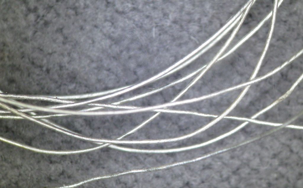

        the wire is around 600mm long, is 0.2mm diameter ( vernier, not micrometer), as best as I can measure is 0.4 Ohms. This measured by placing a current through the wire till 1 volt drop across it ( Fluke 6digit multimeters), with another Fluke as ammeter in series – the amps was 2.5A.
        The wire is bright silver. Scraping it gently under a microscope reveals NO copper colour at all. Bending it back and forth in a small bend seems to harden that section – sort of work hardened. It solders with plain tin/lead solder, 'tins' very easily, without cleaning or scraping.
        From metal resistivity tables the resistance seems to low for aluminium, to high for silver and it ain't copper..
        I suspect it may be silver or a silver alloy and trying to use resistivity comparisons probably leaves the path open to large errors – if I had a 100meters of it, maybe the resistance value would be useful, but 600mm…
        Any Chemists with some bright ideas as to some basic chemical tests that may divulge the wires prime makeup?

                            John, I would use it but its a little short for what I am trying to do. Point is that Metcal by induction generate 40 to 50 watts into the tip, without cooking the wire , no tarnish, no oxidation. The wire is insulated with a very open weave fibreglass sleeve when coiled around the nickel/copper slug at the tip, so that would lessen oxidation to some extent, but the weave is rather open so is exposed to hot air. I have been playing with peralin coated copper wire, as well as kapton coated copper – it cooks…. I tested this by winding an identical copper wire coil in place of the Metcal wire and running it on the metcal tip and power source.
                            From Robert :
                            Is this a genuine Metcal tip?
                            Well,… Yes – since its my Metcal iron and the tips I purchased from OKI International – Tip in the photos is a STTC-135
                            Last time I took one apart it used Litz wire. That was several years ago though. Has th bit been used? migh seem obvious but if it's not been used much it won't have oxidised much.
                            That must have been long ago – Litz wire was used in the SP-200 system ( over 15 years ago..), which ran at 475KHz – quite different,
                            From Andrew:
                            I'd agree with Michael, platinum is way too expensive. Fair point by SoD about skin depth, although silver does tarnish in the atmosphere so the wire may not be simply plated. From a simplistic viewpoint the intent of induction heating is to transfer energy to the workpiece to heat it up. Any heating of the primary coil is wasted energy, so I would have thought that the primary coil wouldn't be designed to get hot?
                            Andrew, that is the key here, and exactly what I am trying to discover how its achieved – The tip gets hot, but the wire is never hotter than the tip – Measuring the AC current in the coil while heating the tip ( using an old, good, HP current probe..) I read around 1.2amps RMS. The voltage across the coil is around 200volts PP. That magnetic field then generates eddy currents in the nickel mix cladding on the copper tip and heats it. But the wire does not cook. If I replace with copper wire, the current actually drops to 1.05amps, but the coil cooks after a while – I suspect the skin effect is killing the coil.
                            I begin to think the wire is silver – Pricing also reflects that – around 18 Euro for a meter…
                            And last, in one of the Patents I read, It is indicated that the wire can be Silver, copper, or nickel/copper….
                            Reading patents – to do much of that requires a special kind of person…
                            'said means of multiple claimed pluralities causing substantial crossing of the glazzies'..
                            Joe
                            Photo shows the coil in its glassfibre insulation, the tip heating slug right, and the bare wire on left.
                            Coil zoomed in
                            Bare Wire from a VERY used hot grade tip

                                    What Neil is referring to is the actual heated tip – it is a copper slug, covered ( plated in some cases) with a nickel ferrous mix ( alloy 42) ( Area 52..??) . When inductively excited at 13MHz, the eddy current which travels mainly on the surface due to skin effect, travels in the 'high' resistance alloy 42. heating it up. It heats till its Curie temp, when the resistivity drops, and the eddy currents travel in the alloy and copper below. The heating then stops, till the alloy cools below Curie, and the loop stabilizes. There are some electronics monitoring the reflected energy from the coil – when cool the reflected energy is low so max power is applied to the coil – when curie is passed, the reflected energy is high and the power is shut down till the reflected signal is good again.
                                    The temp that the irons work at, ie, the tip temp, is purely a function of the Curie point of the cladding material on the tip – in my case the hotend is a stainless steel nozzle, with the coil around it ( basically). The coil inductance changes as the nozzle heats, changing the reflected energy ( higher SWR) and the my electronics would reduce power to the coil, etc. There is no Curie effect in my intended application, so I make the temp whatever I want-
                                    IF I can get it to work – at the moment coils of copper are no good! The copper gets too hot, and could probably be used to heat the nozzle directly, making the whole induction thing somewhat moot..!
