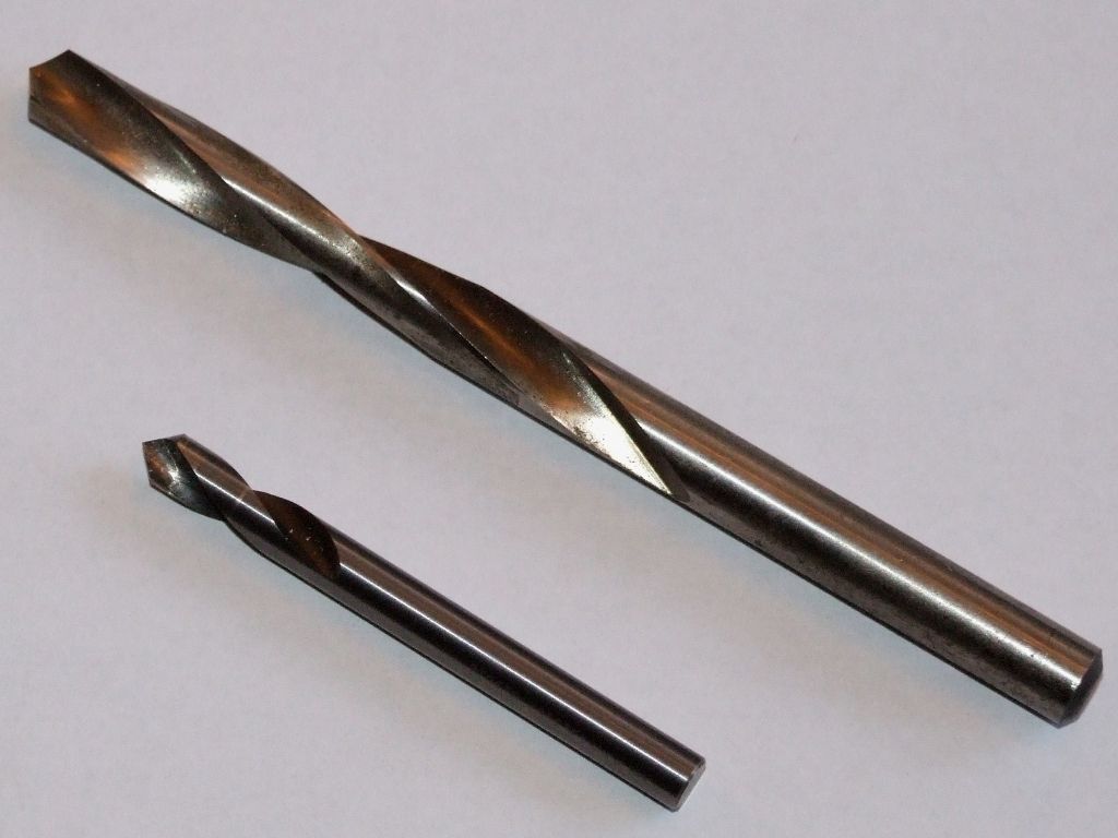

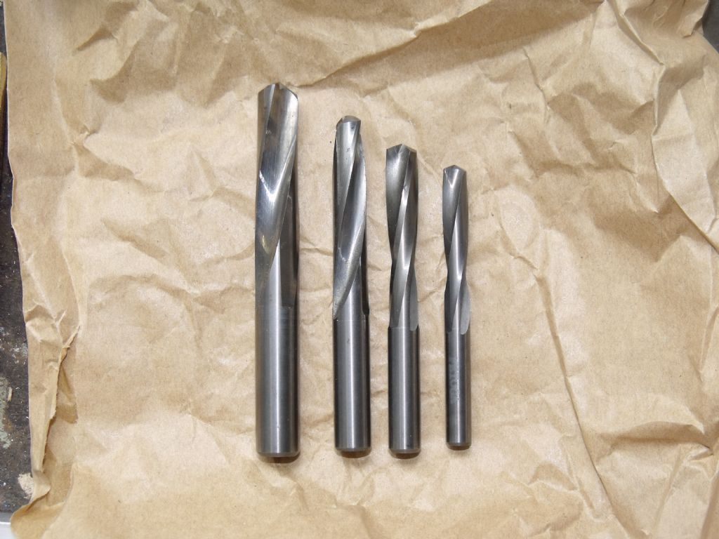

but I note that carbide versions are advertised for use on hard steels, etc.
That's what confused me. Drill Service list straight flute drills but all for very hard materials, not brass.
The picture posted by Jason is what I remember, athough not from 1895. The drills would have been in my fathers toolbox when I was a kid. So I expect them to be from the 1940s, and almost certainly carbon steel.
The slow spiral drills are good on brass but what would be really useful on the Britan is left hand, slow spiral, stub drills. But you don't seem to be able to get them either.
