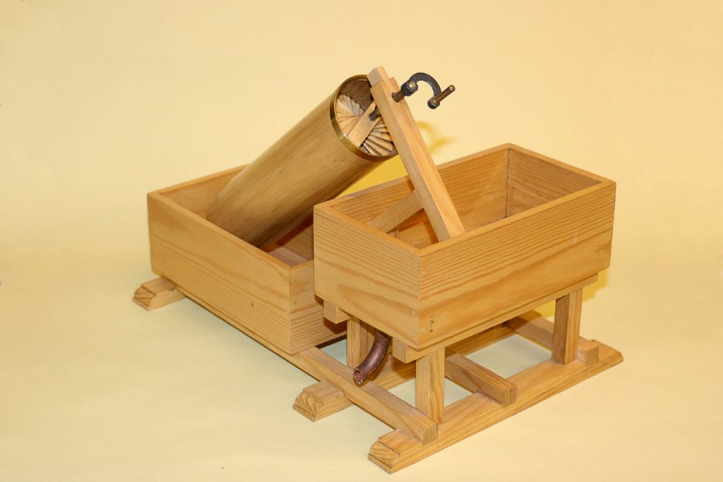

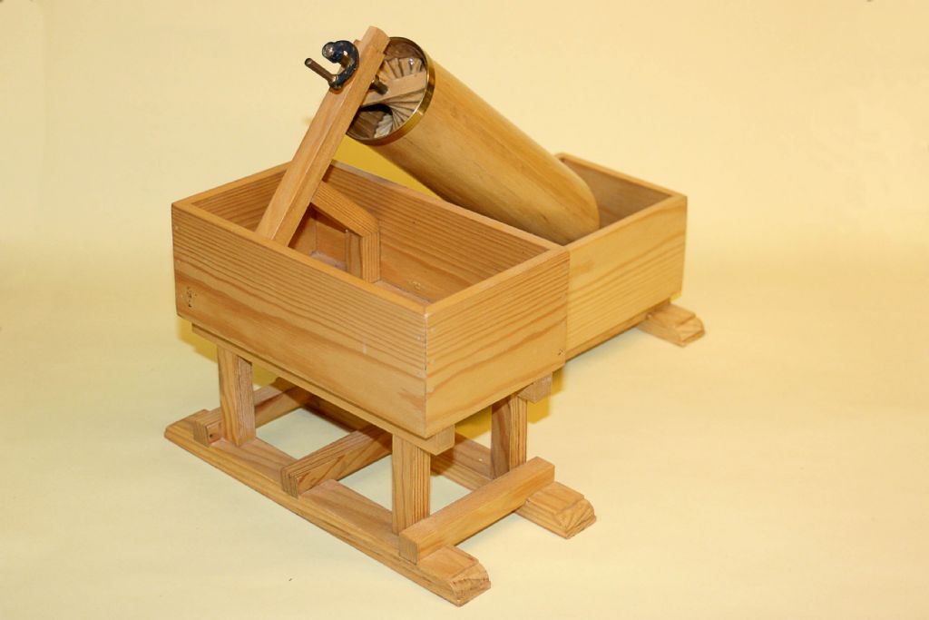

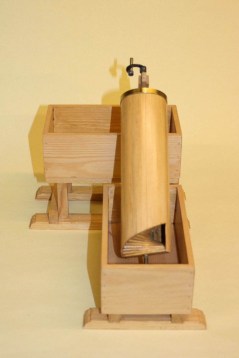

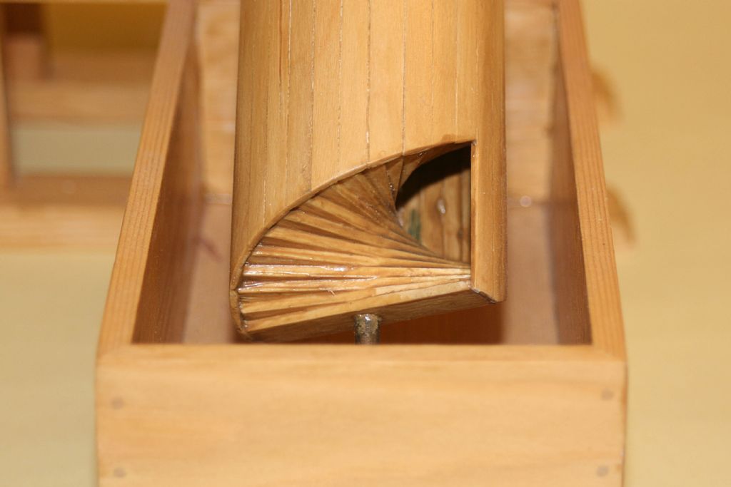

      arch screw 3.jpgarch screw 2.jpgarch screw 5.jpgarch screw 4.jpgI though that perhaps some might like to see the Archimedes" screw that I made a couple of years ago. The screw itself is seven inches long, and two inches in diameter. The cost was minimal. The screw part is made from halves of "lolly" sticks, and the casing from coffee stirrers. It just needed a few simple jigs to get all the bits the same. Properly, the screw element should be sanded smooth rather than left stepped, but I left it like that to show the construction; and it looks nice! The lower end is copied from a picture of a full size one that I found on the internet. I suspect that it makes it less likely to get damaged. I added the brass lip to stop it dribbling when in use. In full size it would not be an issue. The tanks are base on a picture I saw of an early chemical works. Children love to try it out.arch screw 1.jpg

                Thanks for the kind comments gents. I first made one from balsa wood when I was eleven, after being told about them at school. Always promised myself to make a better one. It took me long enough! I'm glad you like the handle Neil. You can find many examples of cranks of this shape on old machinery, from the pumps in "De Re Metalica", to treadle fretsaw machines and some textile machines, etc. I've often wondered if there was some perceived advantage to them, or was it just the appearance?

                                Thanks for all the nice comments gents; yes Peter, the handle is 'clockwise'. One thing that is not visible in the photos is that the spindle, or axle, ends in a ball at the lower end. It just locates in a socket, and is not restrained along any particular axis. Thus there are no alignment problems, and it is readily unshipped went not in use, as were some of the full size ones. Probably to stop them getting nicked!
