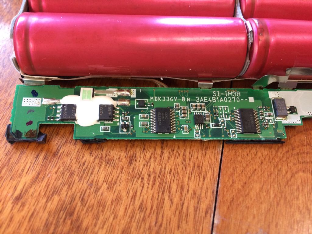

              Neil – are you asking how RS232 works or are you wondering about the format of the control data you need to send to this thing? I rather suspect the latter. I expect the format is semi-proprietary but isn't going to be a well-guarded secret. The vendors might tell you (in Chinglish!) if you ask.
              Dunno if you can find any trace of these devices publicly but these are what you find when you rip open a Lenovo L-Ion pack.
              Lenovo BMS board
