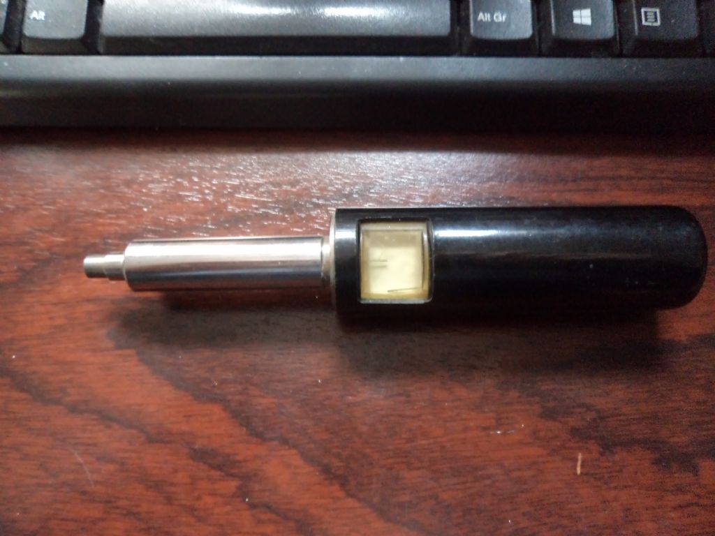

        Hello all.
        I recently agreed to help a friend clear his workshop.
        I have come across an odd measuring tool.
        It is made by Sigma and says "based on NPL design" and is obviously a measuring tool. When the end is gently pressed a needle marker moves in the window.
        It may have been inserted into a sort of enormous micrometer fitting I have also found.
        Picture here or if that fails on the next post!
        Any ideas
        Thanks

            It’s exactly what you’ve assumed … a precision indicator for the enormous micrometer.
            ‘ere we go :
            https://collection.sciencemuseumgroup.org.uk/objects/co59510/0-2-bench-micrometer-micrometer

              Michael is spot on they and similar devices are or were used on many, mainly inspection grade tools and indeed precision machines, one of the Newall jig borer's I worked on used them in conjunction with a micrometer head and their roller measuring system

                Thanks Michael & John. The link showed exactly the enormous micrometer.
                Would this be intended to ensure a consistent pressure when measuring?

                  it's a fiducial indicator, used to ensure consistent readings with, most likely, micrometers used for inspection.

                        It's a fiducial indicator as explained by John. It is used with micrometers in place of an anvil to ensure a consistent reading. The mic is turned / closed until the needle reads zero and as the pressure used is always the same it does not matter who operates the device you will always get a consistent reading.
