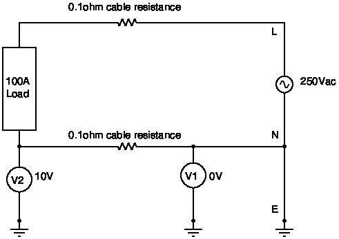

                                              Interesting to hypothesise about where volts between neutral and earth come from. I offer this example:
                                              In the circuit, to keep the maths simple, a 250Vac source is feeding a 100 Amp load through a cable with a 0.1 ohm resistance. If a voltmeter is read near the Neutral/Earth connection at position V1, the voltage will be close to zero. However, if the voltmeter is moved to position V2 at the load, it detects the voltage drop caused by cable resistance. Though about 10V above ground, there's no current imbalance at the source, so an RCD is happy. So is an earth resistance check. This example is all good I think (other than the power wasted in the cables!)
                                              Another possibility is that the multimeter is detecting RF on the line, perhaps from a Ethernet over Power Line system. These piggy-back on mains wiring to carry a modulated radio signal through buildings. Power equipment doesn't react to the signal, but it can be detected by suitable electronics. A multimeter might 'see' both signals. Low frequency mains (50Hz), pretty much obeys ohms law inside the meter, which measures it correctly. Radio signals don't obey ohms law in the same way: high frequency AC sees the meter circuit as a mix of resistance, inductance, and capacitance, which allow it to bypass the meter's dropper resistors. The movement of an analogue meter is protected by diodes, which rectify the signal and produce an uncalibrated meter reading. Diodes in a digital meter can also cause anomalous meter readings. This cause is also OK – only the meter is confused.
                                              My circuit diagram deliberately shows 3 earth connections, which is not normal! I did it to stimulate debate about earth faults – what happens when the earth system malfunctions, either by developing resistances, leaks, or part of it goes open circuit. Various strange things can happen, and there's at least one supply-side earth fault where consumer Neutral becomes Live with spectacular results.
                                              And then there are electrical storms and solar activity…
