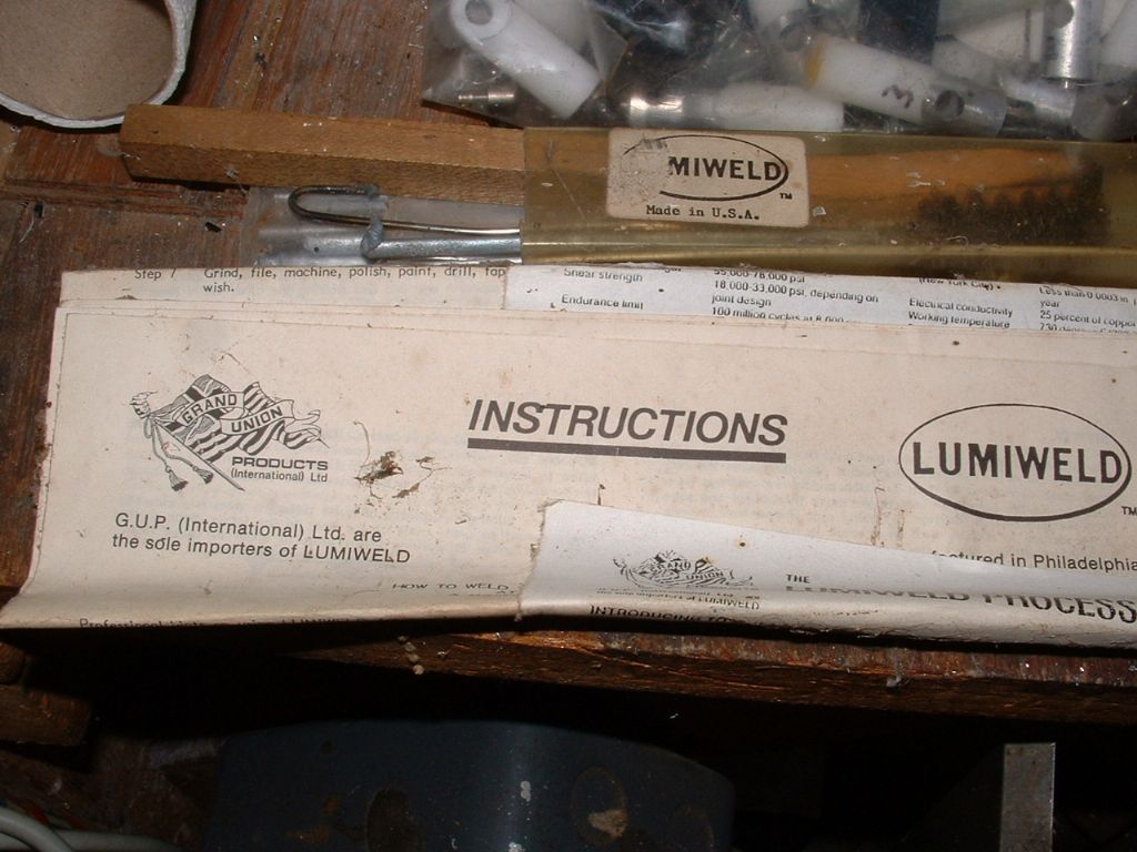

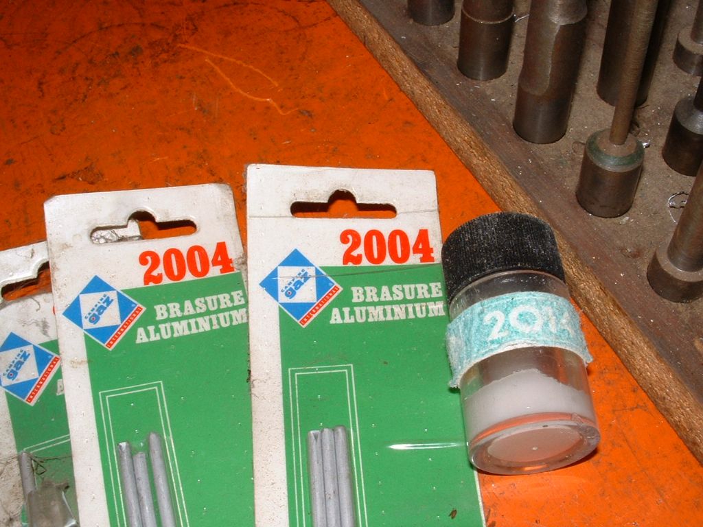

                                                #477570
                                                Emgee
                                                  @emgee
                                                  Sorting my workshop today came across the Gaz aluminium solder pack Gaz 2004 I mentioned earlier, the flux is Gaz 2014. Original part used Lumiweld product also found.
