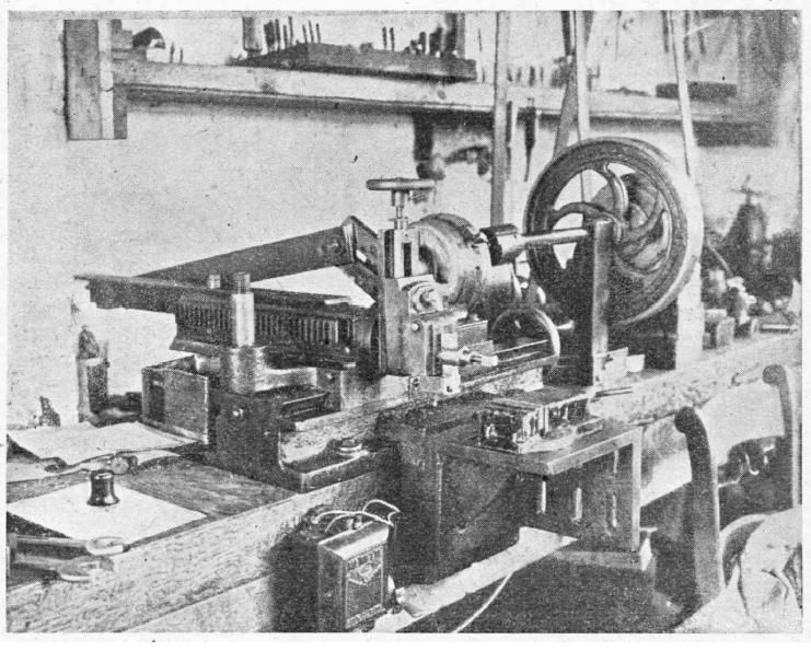

      I read an interesting article from Jan 45, no 2281
      To power a hand shaper they used a "continuous steering box" from a Trojan Utility vehicle which is a pinion inside an internally cut gearwheel
      You can see the offset steering shaft into the circular box behind the clapper slide
      This geared the lineshaft down by 4.5-1
      Do any of you know of a current steering box type mechanism which uses the same principles and which could be useful for turning rotary into horizontal motion (old landrover mk1kinda thing)

            Bit like one of these?
            **LINK**
            Honda industrial engine
            #149330

                    Ady
                    Most current or recent vehicles have rack and pinion steering so I doubt you will find anything like you describe.
                    A pinion inside an internal gear does not have any special connection with converting rotary to linear motion. In your photograph that appears to be done with a crank and link.
                    Is your question aimed at the problem of trying to find a robust reduction gearbox? or are you trying to find a readily available linear (oscillating?) movement?
                    Pneumatics or hydraulics can be used to get straight line power.
                    Ian P
                      Robust reduction is good… in the same plane

                        As I pointed out before Ady, the reduction gearboxes on some of the Honda (GX160 type) engines are exactly the same as that you refer to.
                        It doesn't take much to knock up a drive arm as per the steering box.
                        Approx reduction 6:1
