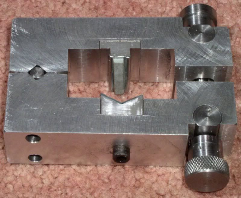

              Paul Lousick
                @paullousick59116
                An external hone can be used to finish the shaft. There was an article in an early edition of ME for making one. Do a Google search for DIY designs.
                This one uses a stone from a car cylinder hone.
