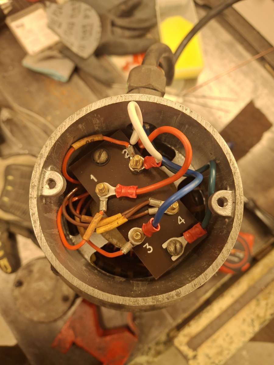

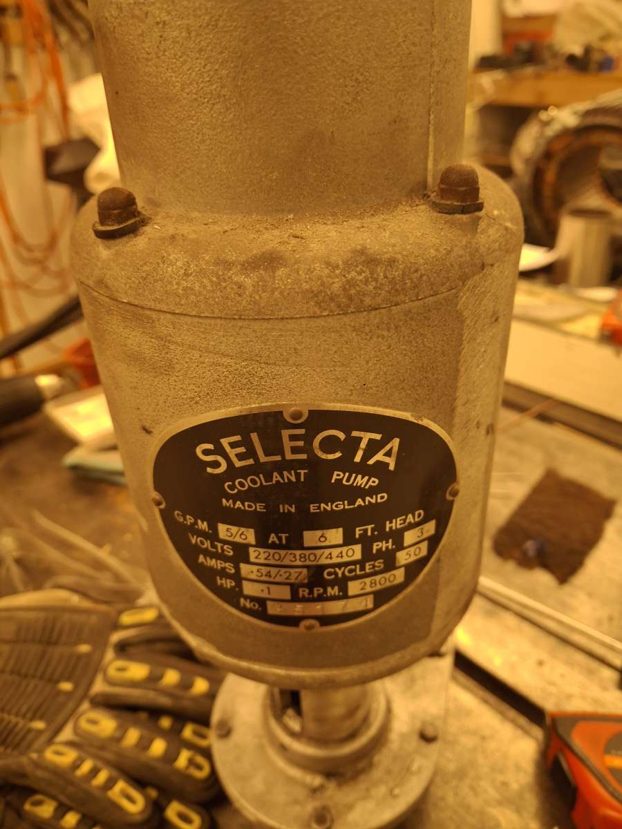

      I have been looking for a coolant pump for my surface grinder and realize that my Omnimill has a coolant pump in the base that I never use due to the mess it makes when milling. I tested it before removing and it works well on 380VAC. I would like to wire it for 220VAC 3 phase but there is no wiring diagram inside the connections box.
      The internal wiring marking has remained very legible with the following at each numbered connection:
      1. A0 and Line
      2. B0 and Line
      3. C0 and Line
      4. A1, B1 and C1 from motor
      Can someone help me with how to alter these connections for 22VAC please? Photos below, thanks in advance and Merry Christmas to all on this forum (and anyone else for that matter).

      #829123
      Robert Atkinson 2
        @robertatkinson2
        Hi,
        Connect like this:
        1. A0  & C1 to line
        2. B0 & A1 to line
        3. C0 and B1 to line.
        No neutral connection.
        Basically take the 3  neutral / starpoint wires on terminal 4 and move them to the relevent terminal.
        Robert.
        #829125
        Bazyle
          @bazyle
          The brown wires on 4 are the ‘other ends’ of each of your windings 1,2,3. Inconveniently all the same colour but helped the manufacturer get them all together. If you draw a 3 pointed star with 4 in the middle and 123 as the points this is the “star connection” for standard 400v 3phase. At anytime in this configuration the voltage is going in at say 1 through a winding to 4 then back out to 2. Hence the 400v is going through 2 windings or 200v each winding.
          The change you want is to get your lower voltage 3 phase across one winding at a time, eg in at 1 but now out at 4 (brown), or in at 2 and out at 4 (but it is a different 4 that is the other end of the no 2 winding). So First identify with a continuity tester (just a battery and LED) which brown is which and label them. Lets call them Brown1, Brown2, Brown3 here but those yellow tags on the wires might be useful idents.
          Now draw a triangle instead of a star – this is called Delta wiring ‘cos it is sort of like a D. Each of the points of the triangle is one of the numbers 1,2,3 and the other end of the previous leg, eg 2 is joined to Brown1, 3 is joined to Brown2.
          The power is now joined to the points of the triangle. Make sure it really is only 200v as if you put 400v through just one winding things are going to get hot.

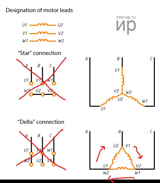

                          peak4
                            @peak4
                            On Wade Beatty Said:
                            For 3 phase supply on a 3 phase motor,  I have never seen a capacitor used.
                            I suspect some folk are thinking you’re wanting to run a 415v three phase motor on 220v single phase, and providing capacitor instructions for that. (about 4 microfarad for that on this motor)
                            Yes, if you’re running 220v 3 phase, just change the wiring from star to delta, but ensure your three windings all face in the correct direction on the pump motor, or it will run unevenly as one winding will be opposing the other two.
                            Reversing the motor necessitates reversing any pair of phase windings on the supply side of the connection strip, not the motor side. i.e. Reverse supply A-B not winding U1-2
