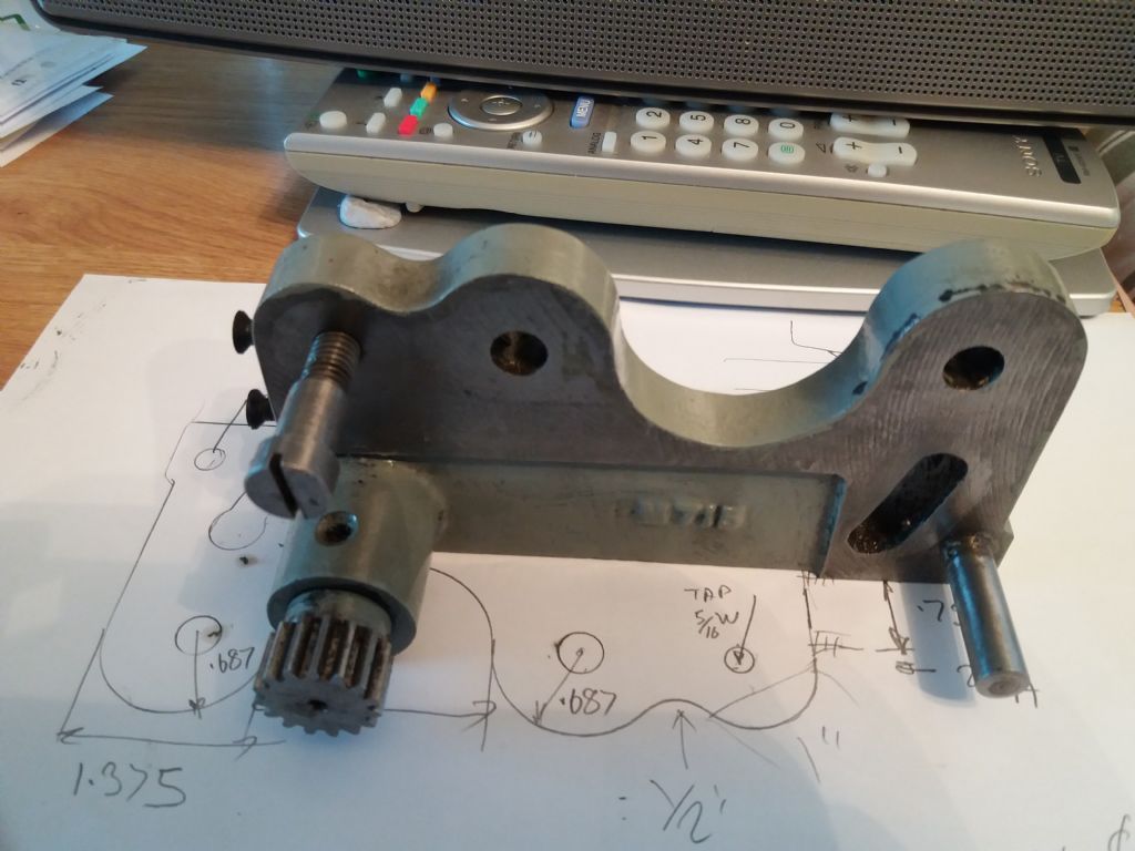

              Hi John this is the mod I did on my M Type lathe saddle. I had a casting from Geoff Walker which allows you to add an idle gear to make the handwheel to rotate in the corect direction to saddle direction. I had a few close shaves before the mod.
              If you want any info just ask.

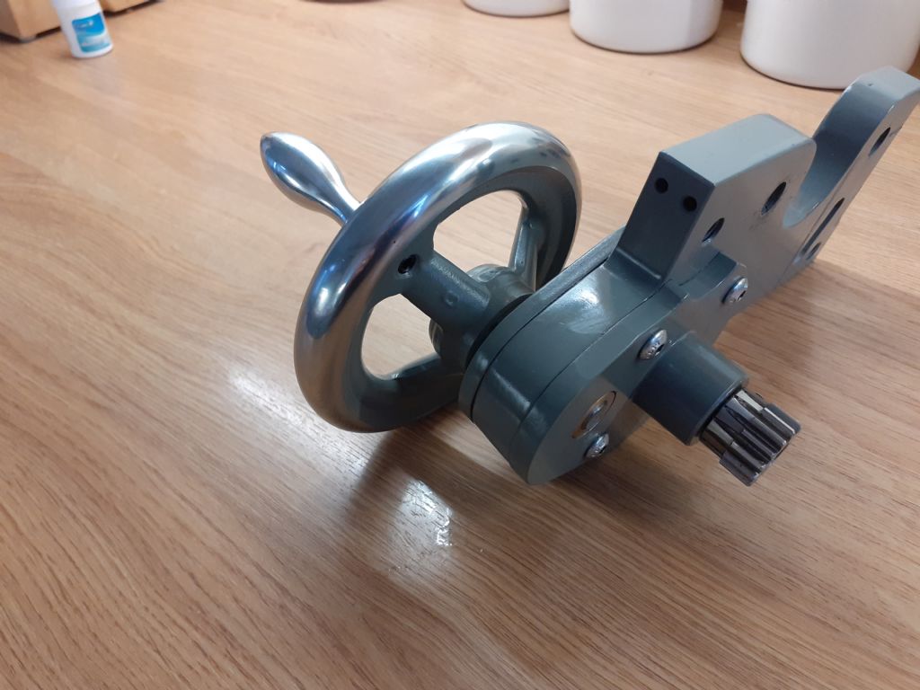

                              This id a mod I made to my Grayson lathe it could also be done on the Zyto by using parts from an old hand drilldscf1832.jpg

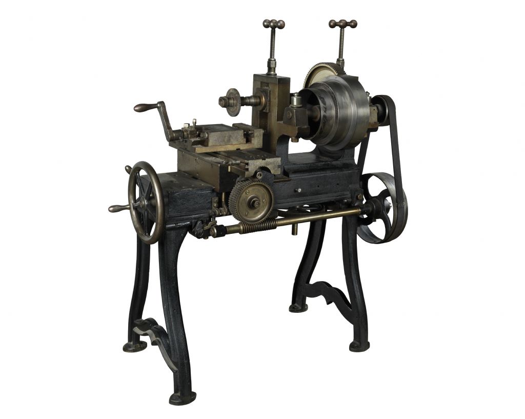

                                Does seem a feature of older lathes. Mostly cost-cutting and partly because the machine was designed before ergonomics were realised to be important. And sold when hobbyists were pleased to have any sort of working lathe.
                                Picture below is of a Lincoln Miller, and the first milling machine to be sold in large quantities, circa 1860. Although it did the job, it can't be said to be operator friendly!
                                I'd learn to live with a Zyto – the feature isn't a show-stopper!
                                Ergonomics is an interesting subject. Although machine-tool designers sniffed around the subject, it wasn't until customers started complaining about products like sewing machines and motor-cars that anyone took much notice. The military were keen on ergonomics and the subject really took off with radios and radar. A communications receiver has many controls, and receivers are difficult to operate unless they're not laid out sensibly, backlash is eliminated, and the tuning feels good.
                                Can't expect too much of Zyto vintage machines. They pre-date a number of improvements made during WW2 and after. Better ergonomics are one reason why post-war Myfords were, and are, popular. Doesn't mean Zytos in good condition are junk, they're just less slick than modern designs.

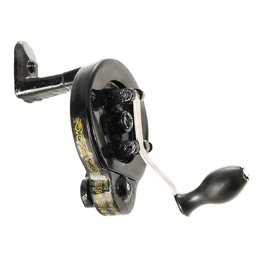

                                          I have an old hand-crank gearbox of an old sewing machine like the one below, that I plan to one day add to the apron of the M-Type as a handwheel reduction gear and rotation reverser. They seem to be common and cheap to buy. It;s just two gears in a housing, one large one small. Perfect, with a little fettling to fit the existing gear and spindle and hand wheel.
                                          #594249
