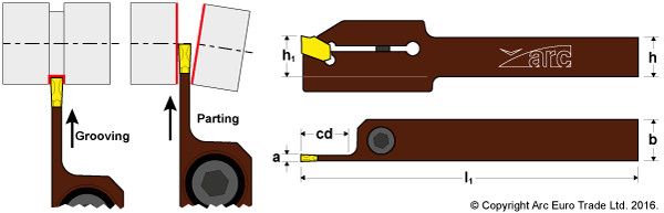

      After a spot of parting off unpleasantness:
      I had to buy a new tool. The one I went for came from Arc Euro Trade – pretty much a direct replacement for the Glanze:

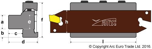

      This works very well, but I wondered about the other design of holder Arc offer:
      I don't understand why the first type is advertised as a parting tool only, but the second as a parting and grooving tool. Can anyone enlighten me about the functional differences of these two designs of bit holder?
      Robin

          Posted by Robin Graham on 27/08/2018 00:55:32:…
          … I don't understand why the first type is advertised as a parting tool only, but the second as a parting and grooving tool. …
          Marketing. Parting is simply a groove taken all the way to the centre. Any parting tool can be used to cut a groove. But any grooving tool can only part off to the depth the tool can be plunged into the job.

            Mick B1
              @mickb1
              On the top one, the tip is just a tight slide fit in the angled slot, and the stiffness of the tool is determined by the depth of the blade. Protrusion is selectable by to the user.
              The lower one clamps the tip with the capscrew, but has a stiffness mainly determined by the shank depth in the toolpost slot. The shoulders force a minimum protrusion.
              My choice would usually be the top type for stiffness and versatility – I can't readily think of a reason I might choose the lower one. Perhaps if you need all positions of a 4-way to be available it might offer less occlusion at the rear?

                    ARC MGEH one piece clamp type Parting & Grooving Tool Holders
                    Suitable for external grooving, parting, turning, relieving, profiling.
                    Each tool holder includes:
                    • MGMN200 TiN coated insert
                    • Hex Key
                    ARC MGEH Parting and Grooving Tool Holders - DiagramsHi Robin
                    Can you see the left arrow above the grooving arrow?
                    This tool can take small cuts side to side.
                    Cheers Michael.

                        What Michael says, inserts held in place by a screw can take light side-to side cuts as well as fore-aft ones.

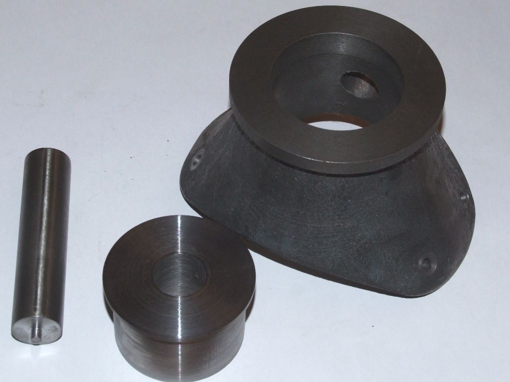

                              The steel part bottom slighly left (~2-3/4" diameter) was parted off with an insert parting tool with no fuss and an excellent finish; better than I get for normal turning.
                              The lower tool in the OP can take a multitude of inserts and has a different, more positive, clamping arrangement, rounded inserts are particularly suited to profiling, like this:
                              The profiling cut isn't pussyfooting about, note the blue swarf! If I remember correctly DOC was 20 thou and feed 8 thou per rev and a spindle speed of 800rpm. And yes, I know it's a Dickson toolpost, but that's what the copy unit came with.
                              My modus operandi for parting off with an insert tool is have no more sticking out than needed. My toolpost automatically sets perpendicular to the cut. In the above picture you can just see the radial "gear"on the left that aligns the normal toolpost. Lock the topslide and tighten the gibs and lock the saddle. Part off under power with a minimum of 4 thou per rev and always coolant except for brass and cast iron. Spindle speeds are normally in the mid hundreds of rpm.

                                Michael, Neil and Andrew,that holder that Michael shows is not what the OP shows. The tip are different and have better side cutting geometry and can therefor cut sideways which is why the MGEH is also described as suitable for profiling, even more so with the round nose inserts.
                                The QA-GTN that the OP posted just uses a standard GTN parting insert but due to the holder being stiffer (sideways) will be better able to cut sideways but at the expense of not parting as deep as the blade type will allow.

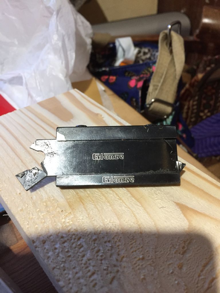

                                          I've got both the first Arc parting tool the OP shows and the MGEH. The MGEH I have actually has squarer ended inserts. It's more prone to the insert slipping backwards when parting hard. I've also tried the other style and my impression is that all the ones with screw clamps are better for sideways cuts although the MGEH may well have the advantage for this.
                                          In practice I tend to make multiple straight in cuts and then take a fairly light side to side cut to finish, although the other day I shaped a domed end on a steel bar with the MGEH by eye which was all side cutting, just too lazy to change tools
                                          Parting under power with TCT inserts is an eye opener, the only issue I have come across is that when cutting alloys you get build up unless you use cutting fluid. Uncoated parting inserts seem to be like hen's teeth.
