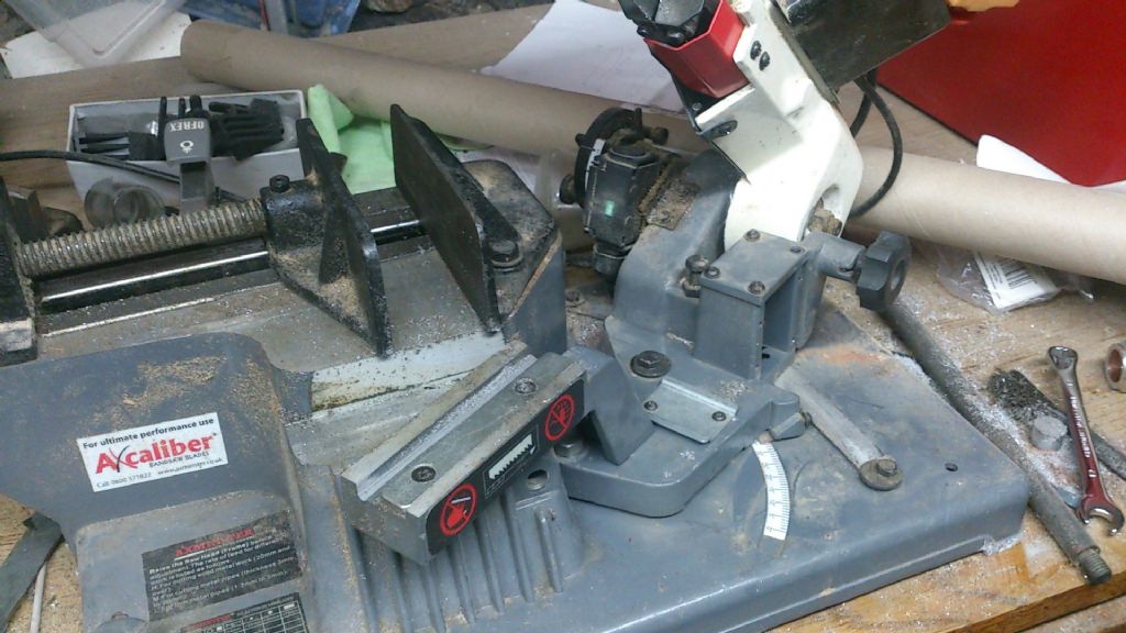

                                          #346300
                                          Robin Graham
                                            @robingraham42208
                                            Thanks for further comments. Unfortunately I don't think the problem with this machine is going to be solved by the usual bandsaw setup methods – I have a vertical saw also, and have got to grips with correcting blade drift etc. Leaving aside tracking problems, which I can probably fix, the saw's major deficiency is that the arm doesn't swing perpendicularly to the vice bed. If I put a 4" square with the stock on the vice bed, align the top of the the square's blade with the saw blade then drop the arm, there's a gap of ~3.5mm between square and saw blades when the arm is down.
                                            I can't see how to fix this given the way the machine is constructed. If anyone can suggest a strategy (other than taking up knitting preferably wink) I'd be grateful!
                                            Pic of machine…
                                            I've set the arm at an an angle for the photo just to (hopefully!) make it clearer how the bits fit together.
                                            Robin
                                            #346307
                                            oldvelo
                                              @oldvelo
                                              Hi Robin
                                              Looking at the photo and your description shows things to check. The bore of the pivot is not parralel to the mitre base of the casting the saw is mounted on or the bottom of the vice and the main frame casting the saw pivots on.
                                              Excess clearance on the saw frame pivot Bush?
                                              Check that what looks like there is two castings bolted together  the vice casting and the base of the mitre and could be separated and shimmed to correct the error
                                              Unfortunately you will need to dismantle to check on a flat and true surface.
                                              This error should be able to be corrected with  time and patience as You have identified  the problem
                                              Eric
