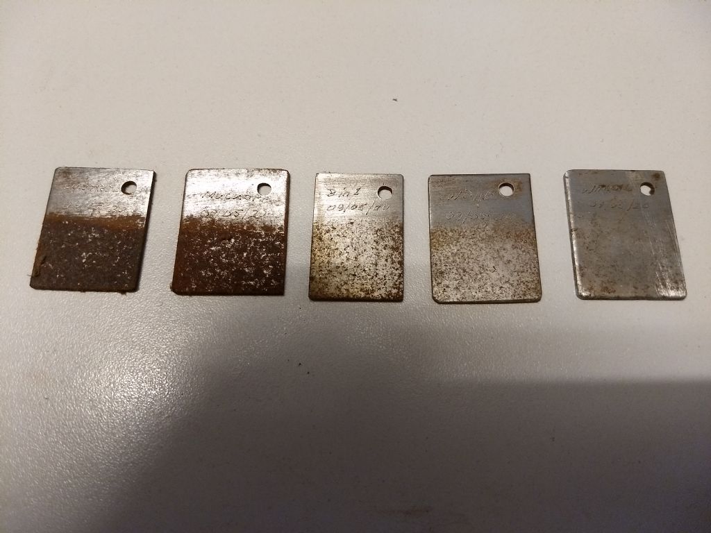

                                                Master of none
                                                  @masterofnone
                                                  Posted by J Hancock on 21/11/2022 17:17:37:
                                                  Many, many years ago MEng did a test on this subject.
                                                  Three-in-one oil came out way ahead of all the other fluids used to provide protection against corrosion.
                                                  I tried this test a while ago. Five pieces of identical plate suspended beneath the eaves of my garage for a period of months, From the left:
                                                  No treatment
                                                  Muck Off
                                                  3 in 1
                                                  WD40
                                                  Waxoil (best).
                                                  I use white spirit to remove it
