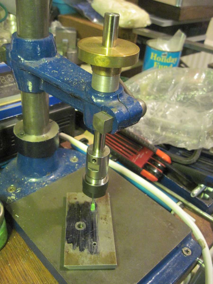

                  #727095
                  IanT
                    @iant
                    Here’s my version. I take the table off my small drill stand and insert a reamed bush instead.
                    A shaft fitted with an inexpensive ER16 chuck fits into the bush and can slide up & down in it. For small taps, I just hold the chuck. Seems to work very well and is simple to make if you have this kind of drill table. As you will see, I use Trefolex (the magic green stuff) too! A small tin will last a lifetime.
                    Regards,
                    IanT
                    IMG_5700

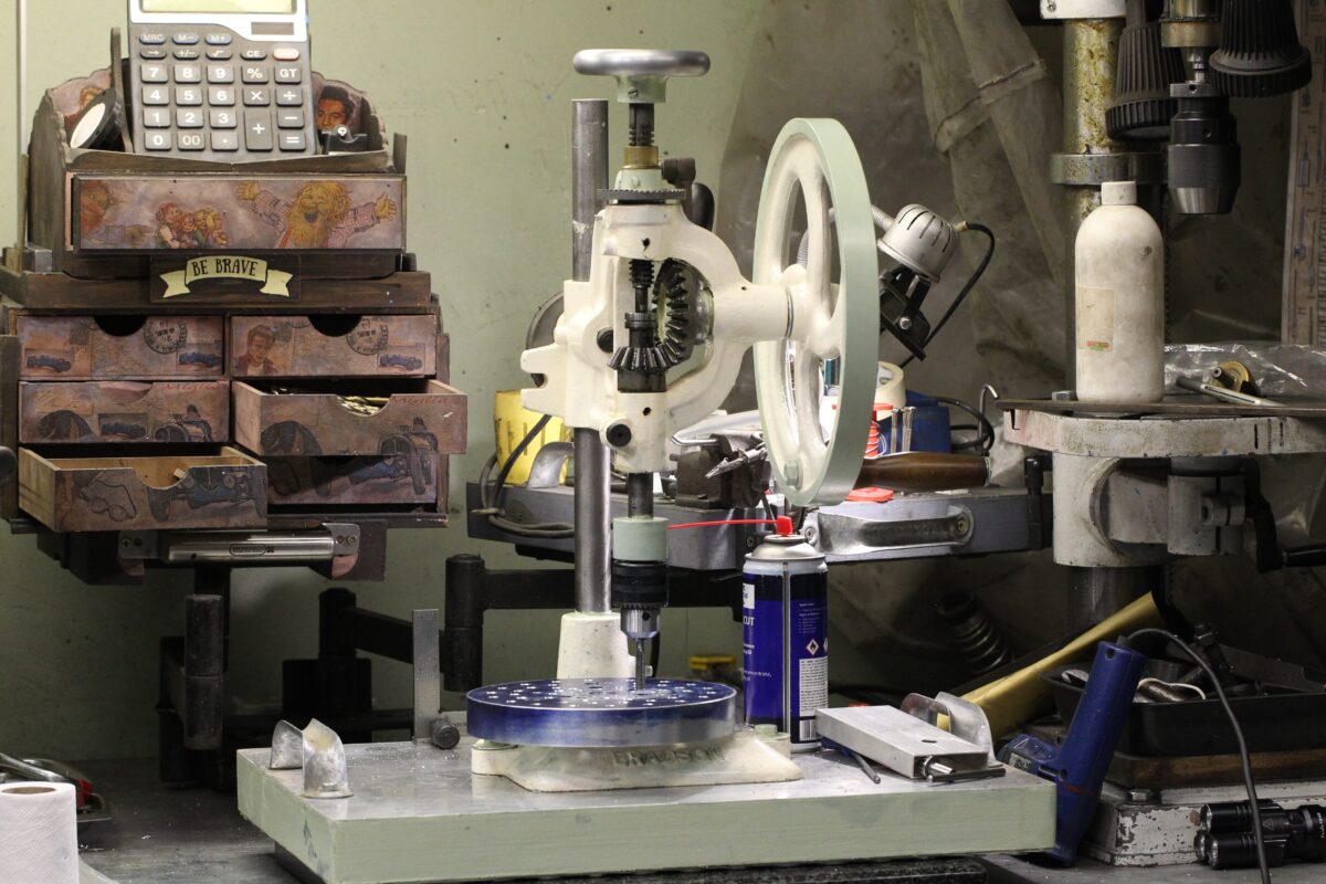

                    #727279
                    Chris Mate
                      @chrismate31303
                      You gave me an idea. Had old restored drillpress gathering dust.
                      -Removed the two nuts holding wheel t top, now you have a floating shaft with chuck.
                      -it works great for tapping the holes in RT disc, slow process however, using what you got. I grab the big wheel itself not the handle for tapping, that gives me a good feel.
                      Note-1:You don’t have to put the nuts back on top, just wind the worm down, connect the ratchet, and it advance the drill down for drilling, easier than I thought, just make sure the its wided back upo for tapping.
                      Note-2:This drillpress base has the nastiest cast Iron I ever drilled, drilled a hole for tap to rest in going down the hole.
