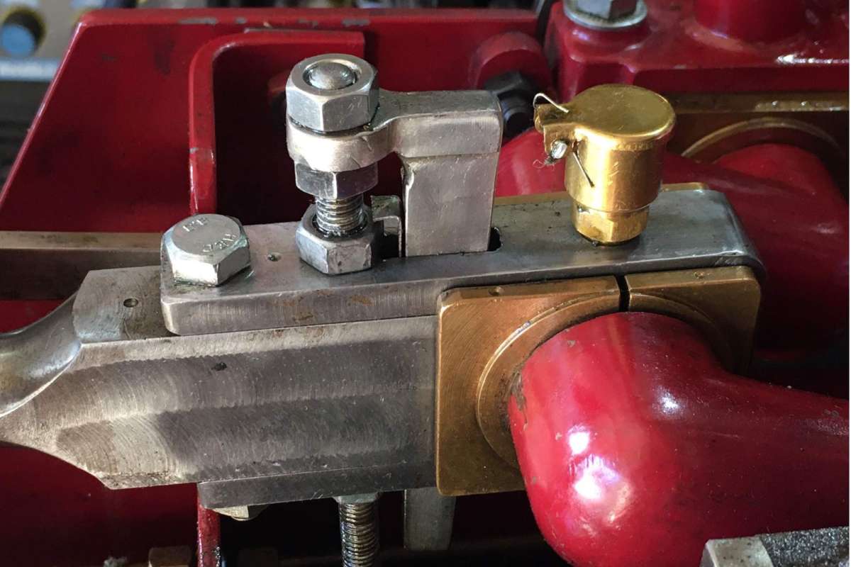

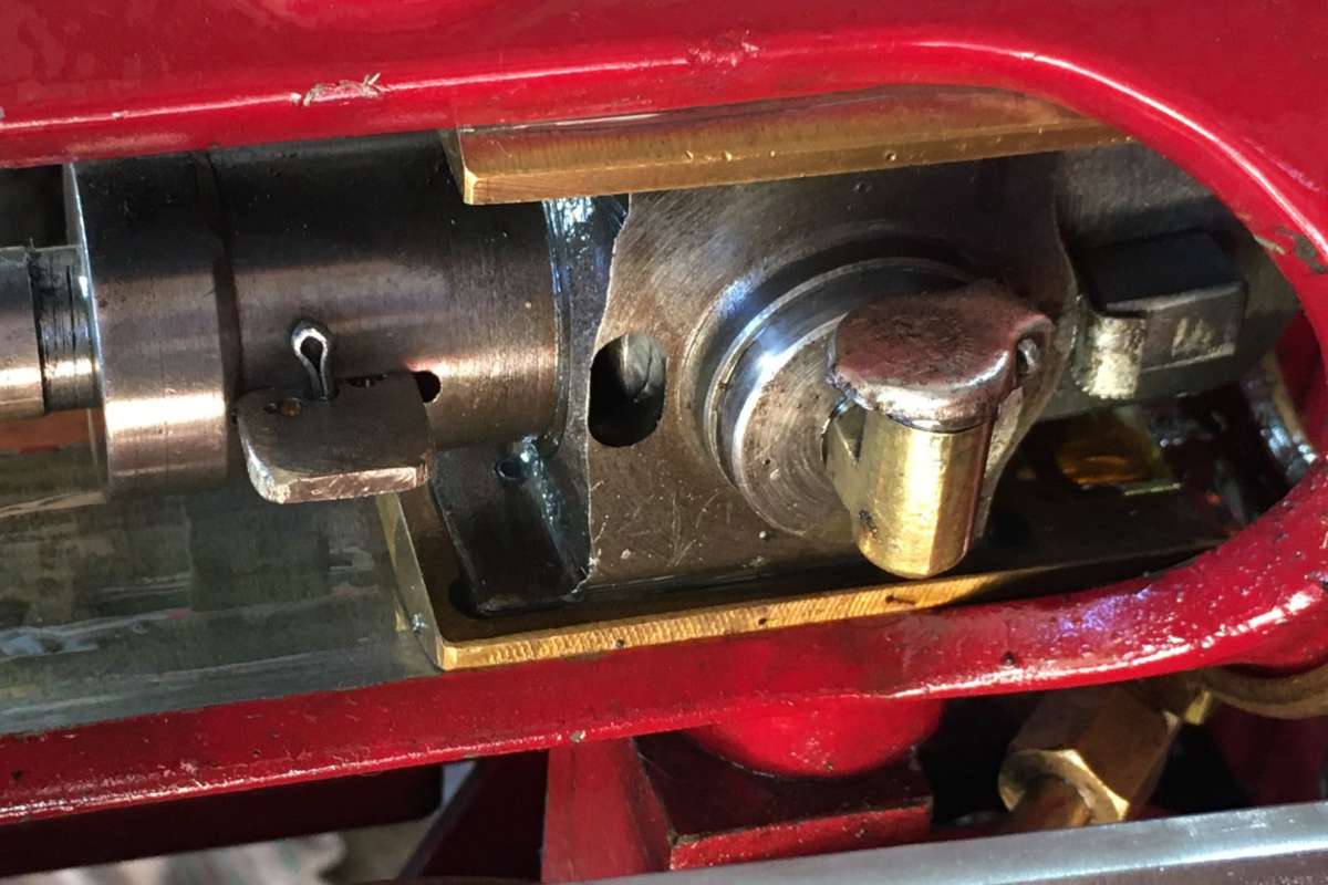

                          #727343
                          Paul Lousick
                            @paullousick59116
                            The crankshaft journal on my engine has a screw for adjusting and locking a tapered pin.
                            Taper pin 2
                            The taper pin on the cross-head has a series of holes and a split pin to secure it in position.
                            Taper pin 1

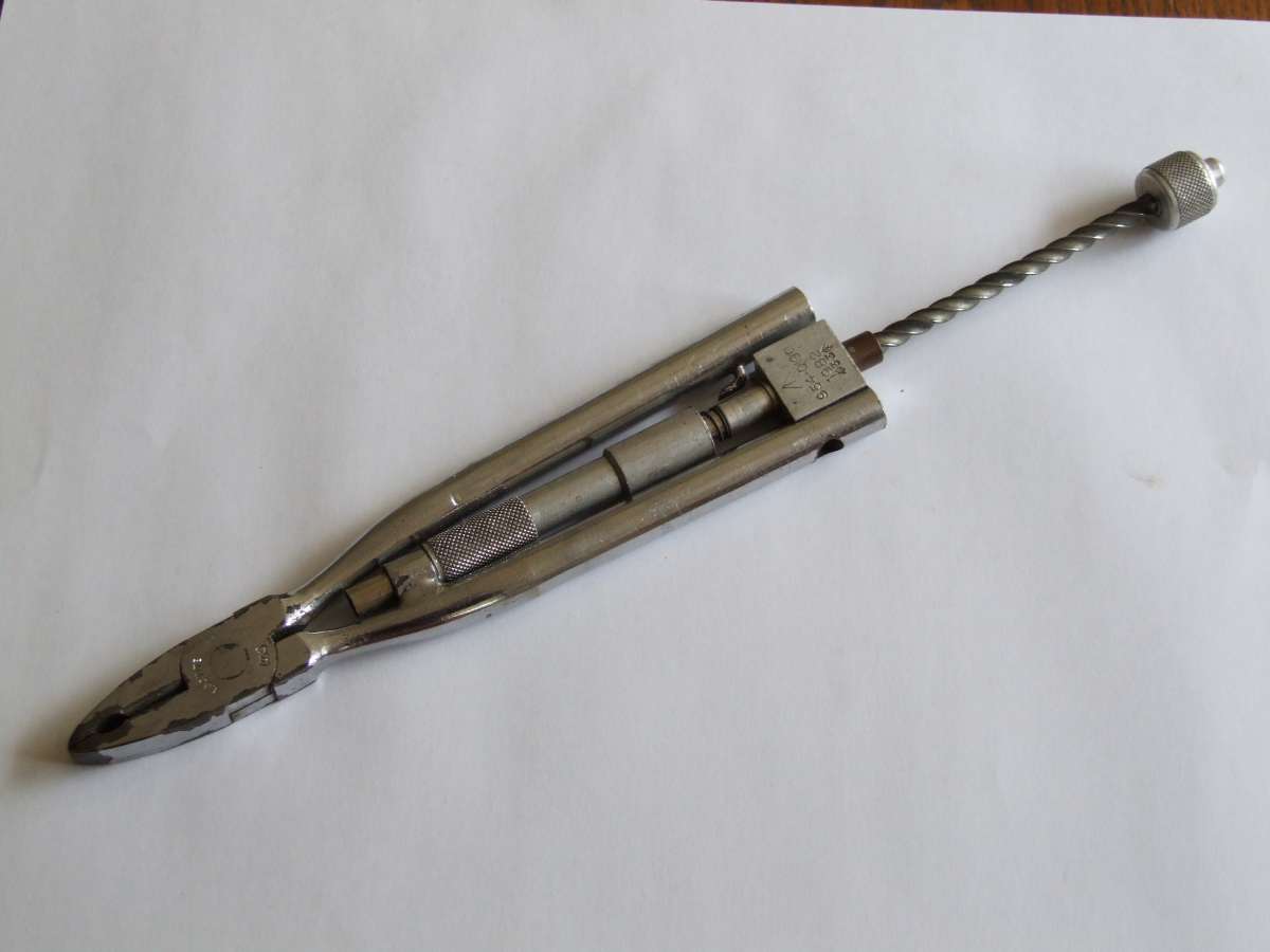

                                  #727629
                                  Andrew Johnston
                                    @andrewjohnston13878
                                    On duncan webster 1 Said:
                                    For wire locking bolts the fitters where I briefly worjed had a tool like a cross between locking pliers and a Yankee screwdriver for twisting the ends of the wire.
                                    Still part of the aircraft mechanics toolkit:
                                    2024_04260009
                                    I bought mine in a surplus store in Rushden many years ago. The proprietor didn’t know what they were and was removing the innards and selling them as pliers for £1. We said we’d save him the trouble of removing the innards and offered 50p each, which he accepted.
                                    Generally wirelocking on aircraft is not used to secure nuts. Nuts are either castellated with a split pin, or are a variety of locknut. Wirelocking is used on bolts/studs that fit into fixed threads. The classic example is bolts holding on a propeller. The bolt heads are drilled for the wire. The bolts are wirelocked in pairs and the skill is in orienting the wirelocking such that both bolts cannot loosen against the wire. Wirelocking also used to be very common on turnbuckles used to adjust tension in control runs using steel cable. Another use is restraining, and sealing, pipes on pneumatic instruments. Although that has largely been replaced by large O-rings normally used for castrating sheep.

                                    #727639
                                    JA
                                      @ja
                                      A chief designer or a design standards manual would condsider any of the above suggestions for tapered and cotter pins bad practise. However they are acceptable bodges to keep something running until a proper repair can be made. My feeling is that they should be avoided when making a model but since you are the designer or constructor you can make your own rules.
                                      One comment about the above cotter pin pictures, I cannot see the matching tapered pad for the pin. If there is not one the pin will work itself free quite rapidly.
