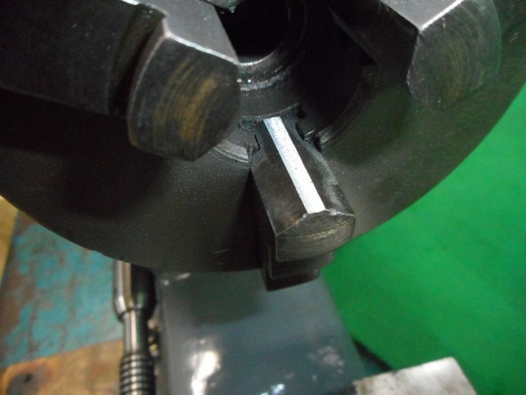

      myford ml7 with 3 jaw chuck …
      i'm having bother threading mild steel with a tailstock die holder and the stock being held in the chuck ..
      i turned a bar down yesterday to 9.5mm for a 3/8×24 die and it was in the chuck but when i try to thread it using the die holder the work just slips no matter how much i tighten the chuck ..
      it will make the first small part of thread then just slip even with a good chamfer …
      yes i can take it out and finish in the vice but i would rather do it on the lathe .. is there a way to make the chuck grip tighter ?
      the only thing i can think of is maybe a soft collar using two halfs ??
      any input guys ? thanks ..

            If the chuck is well used perhaps the jaws have become bell mouthed, this drastically reduces the gripping area.

              the chuck is worn a fair bit i think because i needed a 12mm hole through 6 penny washers so i put them in the chuck to bore through them with a drill and the washers closest to the outer edge of the chuck fell out when i tightened it ..
              i done them 3 at a time ..

                    You have a bellmouthed chuck as your washers proved. It needs regrinding or replacing.
                    Meanwhile you can make life easier by reducing the diameter of your steel bar by 5 thou or more. Die goes on much easier and thread is just as strong.
                    And try wrapping a piece of emery paper around the job where the jaws grip.

                                          Has been threads on here before and article(s) in MEW on regrinding chuck jaws. It just needs a clover leaf plate, or three small bits of flat bar to push the outer ends of the jaws OUTWARDS while regrinding with a Dremel held in the toolpost.
                                          picture 11. chuck regrinding. stop grinding when all three jaws are evenly ground..jpg
