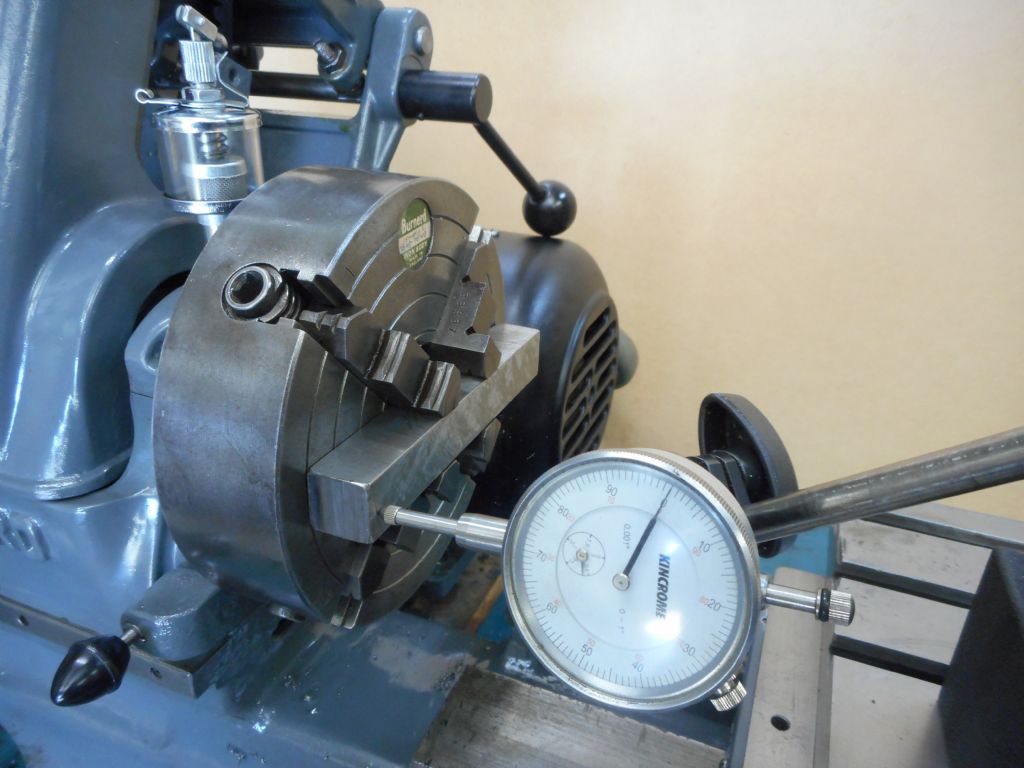

                                      This pic shows the basic principle of "diagonal" work holding jaw positions for the four jaw chuck.
                                      But I like Duncan's idea to cut your piece of spring longer than required by say two inches, and  drill holes in the ends and bolt straight through to the faceplate . Machine the middle section and cut off the ends afterwards. Elegant in its simplicity and no chance of anything moving.
                                      For interrupted cut on a large piece like yours, use low rpm, like backgear medium pulley.
