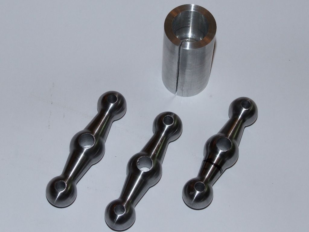

              Make a split collet, like this:
              The collet was bored to fit the small and large balls, with a smaller through hole to act as a stop on the smaller ball. I was able to machine the third ball using the same speeds and feeds as the others using the split collet.
              I don't think 316 can be hardened. However, it does work harden. I speak from bitter experience having just badgered a number of drills when drilling and tapping it in both the lathe and mill. Hesitation is fatal. Just drill continously with a good feedrate and don't even think about peck drilling. For stainless I drill for a 50% thread engagement and use my newest, and sharpest taps. Tapping goo also helps.

                  Thanks. I am not sure from the picture but have you bored out the inside of those split collets to give 2 rings of contact to grip the balls either side of the widest point?

                    I have done it with pot chucks like andrew shows with plain sides, the softer aluminium grips the ball better than steel would. Collets with backstops work well but you would need a large one for that size ball.

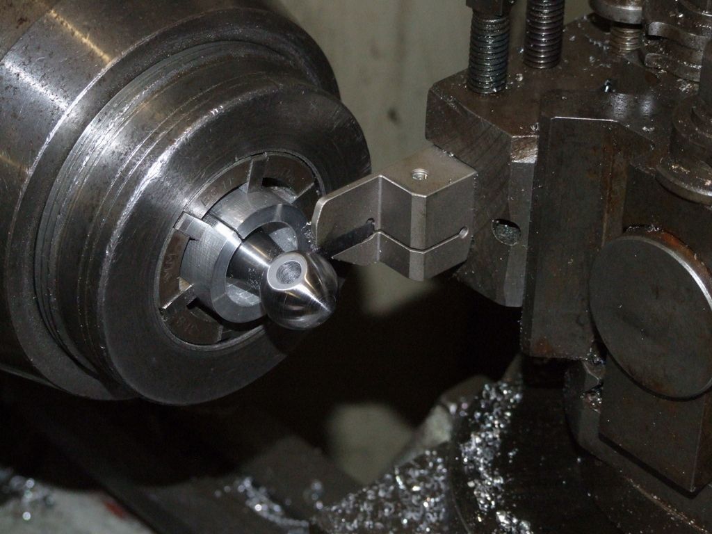

                        Anonymous
                          Posted by SteveI on 11/04/2017 13:05:42:
                          If I recall correctly the embryo collet was drilled thru about 10mm. Then it was drilled 3/4" part way through. That locates the smaller ball and provides axial location. Finally a portion was bored 7/8" diameter to hold the larger ball. So correct, it does grip on two rings of contact. The collet is split diametrically almost all the way through axially. And then another diametric split 90° from the first, but from the other side. A bit like an ER collet. Here is the collet in action:
                          The six finger headstock collet probably helps with closing force and keeping the split collet more or less concentric.
