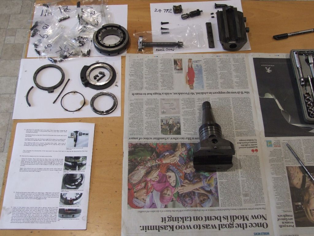

                                      Finally got around to disassembling my UPA4:
                                      Fairly straightforward, although it wasn't quite as the instructions detailed. I also fell at the first hurdle and had to buy a set of larger circlip pliers. Once I'd got the correct tool it took 5 seconds to remove the circlip!
                                      It's clear that the locking mechanism for the coarse feed has parts missing. It's missing one ball, a spring and a detent. Sadly the spring and detent are not shown in the picture in the instructions. I can see how it would work, but it would be very helpful if someone could confirm that the lock only works in three places, spaced by 120°, and corresponding to the positions of the three balls. It's simple enough to get a replacement (4mm) ball but I'll need to make the detent and possibly the spring. I also need to replace a missing 4mm dowel pin.
                                      Andrew

                                          A bold move – a bit like taking a clock apart. Perhaps you could take some good photos of each of your sheets of paper sectons of the innards above for the record as you have demonstrated nobody else has ever done that on the internet.

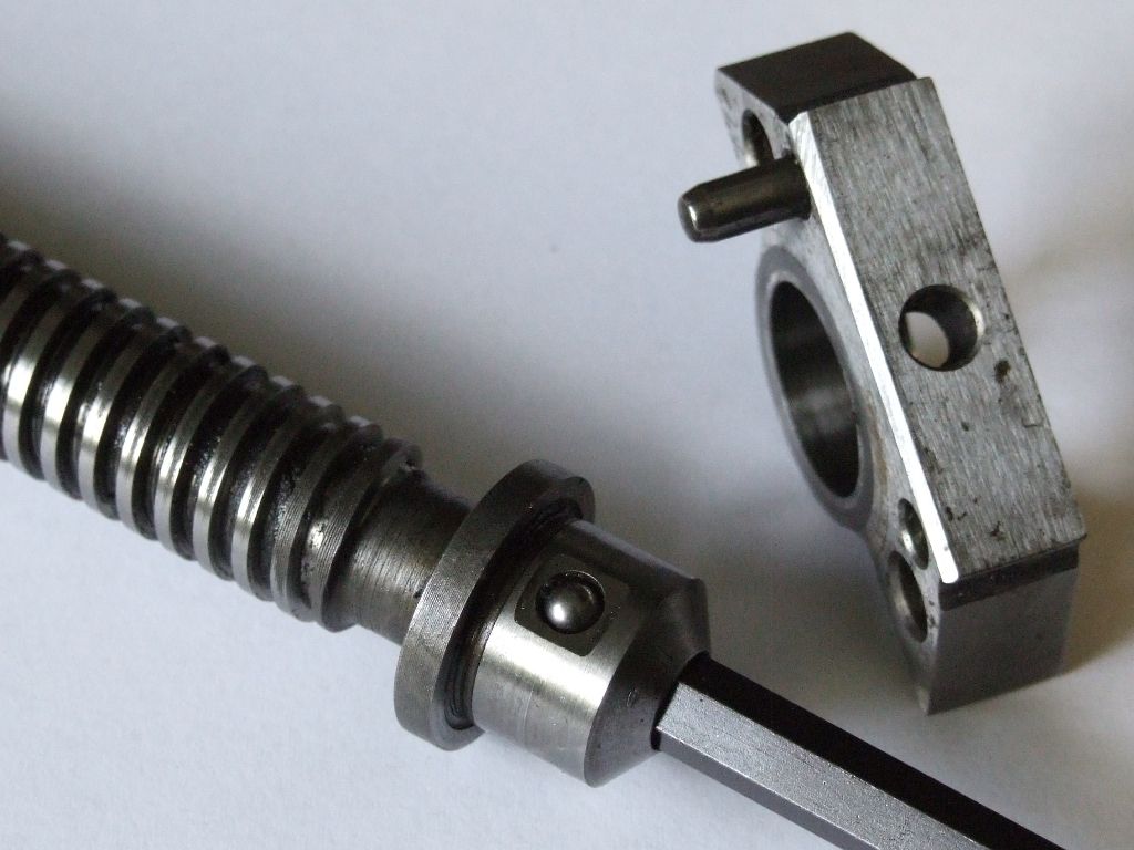

                                            Andrew,
                                            The coarse feed on mine locks in three places, each at 120 degrees. The detent appears to be at the bottom and the ball in this position is spring loaded, with the other two balls being loose when the key has been removed.
                                            Regards,
                                            John.

                                              John, thanks for the confirmation. Here are the parts:
                                              You are correct that the detent and spring are housed in the hole in the block at top right. Note the block is missing a 4mm dowel. At least the serial number on it agrees with that on the main body.
                                              I don't think the 4mm balls are spring loaded directly. When the Allen key is fully home (as above) the ball is slightly proud of its hole. I think there must be a tophat shaped detent in the hole in the block. When the ball is proud of the hole the detent can't engage with anything. As the Allen key is withdrawn the ball drops to the bottom of its hole and when the screw is in the correct place the detent can drop into the 4mm hole, thus locking the screw. The hole in the block is quite short so the spring is going to be short, given that the detent needs to be long enough to stop it canting over.
                                              Andrew

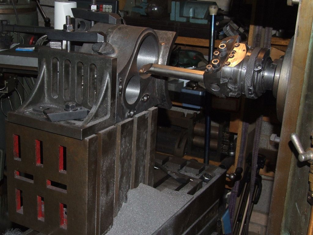

                                                Thought I'd finally bring this thread to a conclusion. I recently got around to making the small 'tophat' detent for the coarse feed. I made some careful measurements, with a depth micrometer, of the depth of the housing to the shaft and the depth of the housing to the ball fully home. That enabled me to design the 'tophat' and then make one in silver steel. I bought the compression spring rather than make one. Once the parts were fitted the coarse/fine feed works exactly as advertised above.
                                                This weekend I've been boring the HP liners for my traction engine cylinders:
                                                Now that the boring head works properly it's a joy to use. Easy to rough out using the coarse feed and then swap to the fine feed for finishing. The feeds are spot on; for one liner I put on 4½ thou (on diameter) according to the fine feed knob divisions, and as far as I can tell with an internal micrometer the diameter increased by 4½ thou.
                                                The bores measure round and are parallel, measured at each end, to within 2-3 tenths, and the bores on the two liners are the same to within 2-3 tenths. The bores are 4-5 tenths undersize to allow for honing.
                                                One happy bunny here! Now celebrating with a glass of wine. It's just so nice to be able to use quality kit that does what it says on the tin.
                                                Andrew
