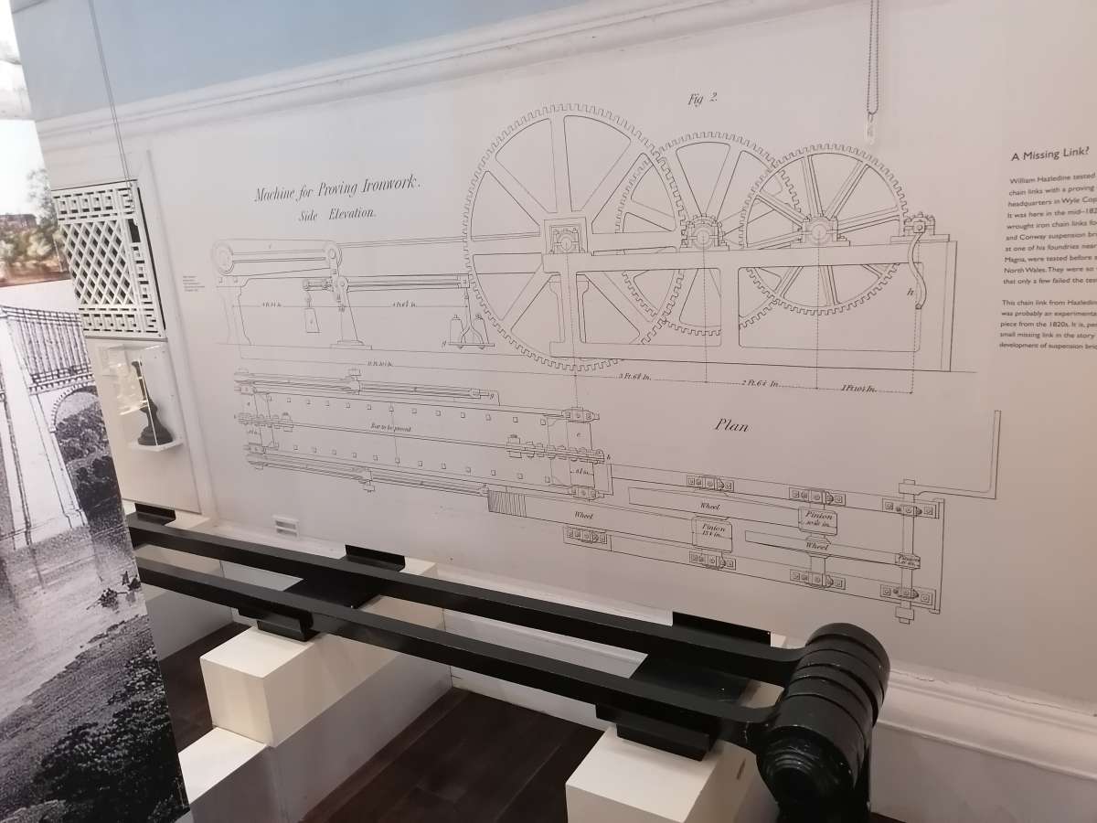

      My brother has just sent an interesting snapshot from Shrewsbury Museum:
      IMG_20250717_122937
      Worthy of further investigation, methinks

        But no mention that I could see from a quick visual scan of the document of how the proving machine worked to test the wrought iron used for the suspension chains.

          Magnifying the image did not help much but the drawing suggests a tensile-test machine using either two racks or a central screw with bevel-wheels, driven from the final gear.
          Though how the test was supposed to be quantitative rather than just qualitative, is not clear.
          Materials testing was still in its infancy in the 1820s, and even by the early-20th manufacturers were still using quite crude methods such as (for cast-iron) loading the centre of a specimen bar simply supported over a length.

            The weights just to the left of the largest gear are magnified (20:1?) through an arm pivoting on a floor stanchion to lift the substantial lever on the far left which pulls the chain to one end of the test piece. The hand crank far right is wound to take up the slack until the weights are lifted. The weight on the far left is probably used to compensate the weight of the mechanism to make the calculation straightforward.

              the gears reduce the rotation of the hand crank (rightmost) to the biggest wheel(centre). Wrapped around the axle of this wheel is a chain, connected to the test piece. At the left hand end a second chain is connected to the test piece, this chain wrapped round another axle. This axle drives a double lever arrangement to lift the pan with 3 weights on it. As Bazyle says, the left hand weight is to zero the whole shebang. It seems reasonably founded to me, the only iffy bit is friction in the left hand axle bearing, otherwise the load in the test bar is the mass of the double weights multiplied by the double lever ratio.
              There is a much bigger tensile test machine in a museum in London, Kirkaldy

                      For anyone still interested … the machine is described here:
                      https://archive.org/details/dli.bengal.10689.19434/page/n253/mode/2up?q=proving

                        – I see that although ultimate tensile strength was known, ‘proof’ was really based on the yield point..
