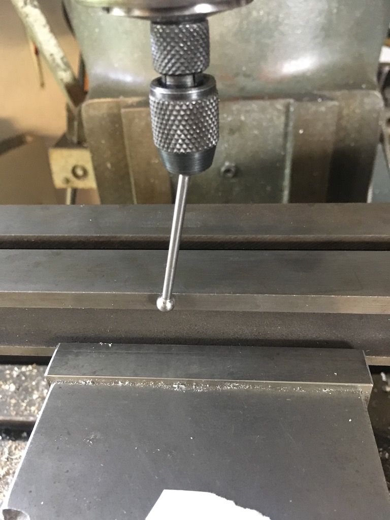

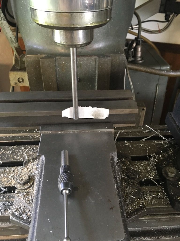

                                                  #420151
                                                  Clive Foster
                                                    @clivefoster55965
                                                    Hi Brian
                                                    Sorry to be unclear. Take 2 on the calibration, with pictures.
                                                    Obviously if you put a straight round rod of known diameter in a collet and just touch it against something solidly fixed to the table the spindle centre line will be exactly half the diameter of the rod away from the solid object.
                                                    Tricky bit is getting the just touch position right as, using the feed screws its very easy to bend any sensible size rod by a few thou without noticing. Picture below shows the method using the Y axis with a piece of cigarette paper instead of the feeler gauge so its easy to see. Basically wind the slide over until the cigarette paper or feeler gauge is just trapped between rod and object needing a smooth pull to remove. My personal calibration is just bit less pull than needed to tear the paper. Using a one thou feeler gauge means you know exactly how much extra to add to half the rod diameter to get spindle offset. Rizla green is said to be a reliable 1 thou thick but paper always seems bit squidgy and a rather un engineering material for calibration use.
                                                    The narrow ridge on the indicator holder base block seems better than a solid face for reference as a face needs to be truly vertical for accuracy not merely very close.
                                                    Posed picture with the edge finder running out a little to one side. Having figured out the spindle centre line position using the rod as above its easy to note how far the edge finder has to be off centre before it moves sideways. In a perfect friction free system its obvious half the ball diameter. Friction, stiction et al means it has to go bit further.
                                                    Hope this helps.
                                                    Clive
