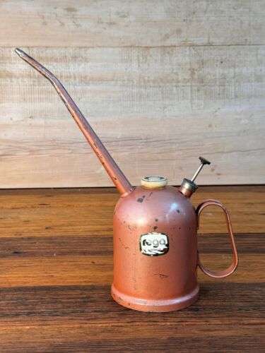

          #738107
            Far-eastern machines often come with a pump action can like this: like Nick, mine is full of ATF!
            https://i5.walmartimages.com/asr/3c97dca0-aa27-4c9f-9d17-d8d5995ea9e3_1.2fb21a1797e32b8dba2b1f924194d8e2.jpeg
            Not ideal because the spout is straight, making it difficult to align with some oil-points, so oiling can get messy.  One with a bendy spout might be better:
            https://modernfarmer.com/wp-content/uploads/2014/02/dynaflo.jpg
            Cruel world that it is, I have yet to find a perfect oil can, and am of the opinion that no such thing has ever existed!  They all leak and cause some sort of mess being filled or in action.
            Fortunately, on a lathe the can doesn’t matter much, provided a dollop of oil gets past the ball-bearing seal.   On a couple of mine I poke the ball with a screw-driver to make sure oil actually gets in, because I’m not completely certain oil-pressure from the can is enough.   Others work very obviously. Any excess oil is just wiped over the lathe with a clean cloth.
            Some folk fit one-shot oiler systems.   I don’t think they’re worth the bother on most hobby machines.
            You might like to consider using “Way Oil” on the slides.   I tend to splash what ever is handy on my lathe just to keep it clean and slippery, but “Way Oil” definitely feels better.
            #738113
            Hopper
              @hopper
              I have actually done a bit of research into this recently, and come to the conclusion that old vintage oil cans are less prone to leak than the modern ones like the one in your picture. The reason, according to my extensive research – leaving various oil cans in the Myford drip tray surrounded by various paper towels — is the modern oil cans all have small-bore, parallel spouts like the one in your picture.
              The old cans with a large tapered spout, starting out at about a half inch diameter at the can and tapering down to the point at the dispensing end, do not leak.
              The problem seems to be (and I stress seems in the absence of definitive testing) that thick viscous oil rises up the narrow parallel spout of the modern cans by capillary action, then gets over the curve at the top of the spout and runs downhill to the tip, whence it dribbles out, creating somewhat of a siphoning action at the same time.
              Some oil cans, depending how fast the oil comes out and the design of the tip, dribble healthy droplets straight down onto the telltale paper towel under the end of the spout. Others, dribbling more slowly in more of a sickly ooze than definitive drops, have the oil dribble back down the outside of the spout and run down the outside of the reservoir can on to the strategically placed paper towel under its base. This, you would swear, is caused by the can leaking around the base seam area etc. But multiple oil cans over the years have been tested for leaks, coated with sealant etc etc and still ended up standing in a puddle of their own muck when left standing for any length of time.  Very frustrating as you have found.
              But a couple of recently acquired ancient oil cans with the traditional large diameter tapered spout passed the test with flying colours. The spouts are too large at the base to promote capillary action (according to my theory!) All paper towels left unsoiled.
              So one is filled with ISO32 hydraulic oil and the other with whatever clean engine oil was leftover from the last oil change and both sit in the Myford drip tray, high and dry and not surrounded by the usual mess. The oil mess in the tray from the bearing drip feeders, it turns out, is minimal once the errant modern oil cans were shunted off and replaced with the period correct good ‘uns as below.
              oil can
              Standing your oil can on a square of paper towel and also wrapping some paper towel around the spout and securing with a rubber band for a few days or weeks will reveal if you have a dripper or a dribbler. (Or if as in one case I had, the old oil can has rust pinholes in the base from moisture that sat there for years at the bottom of the oil, but that is a different issue!)

                  #738160
                    I have actually done a bit of research into this recently, and come to the conclusion that old vintage oil cans are less prone to leak than the modern ones like the one in your picture. …
                    Maybe, though I suggest Survivorship Bias is a more likely explanation.  Millions of oil cans have been made since the industrial revolution, and most of them have long since been scrapped.   The few that have survived are the exception, not the rule, perhaps still existing today only because they performed unusually well.
                    I agree capillary action is a likely explanation, but here’s the sting!   Capillary action depends on the viscosity of the oil, and the geometry of the feed tubing, and the angle at which the can is positioned to get the nozzle into the oiler.   This creates a situation in which a lucky owner fervently believes he owns the perfect can, when actually it’s just a good match to his problem.  An unlucky owner of exactly the same can, might be equally convinced the design is rubbish.  He could be applying a different grade of oil to a different machine, or perhaps the same machine with different ball spring pressures on the oil points, and that’s enough to upset the apple cart.
                    Making the perfect oil can would be a good competition.  One that “just works”, no matter what grade of oil it’s filled with, and irrespective of how awkward the oiling points are.  I suspect this is an example of an engineering challenge that’s much more difficult than it first appears!
