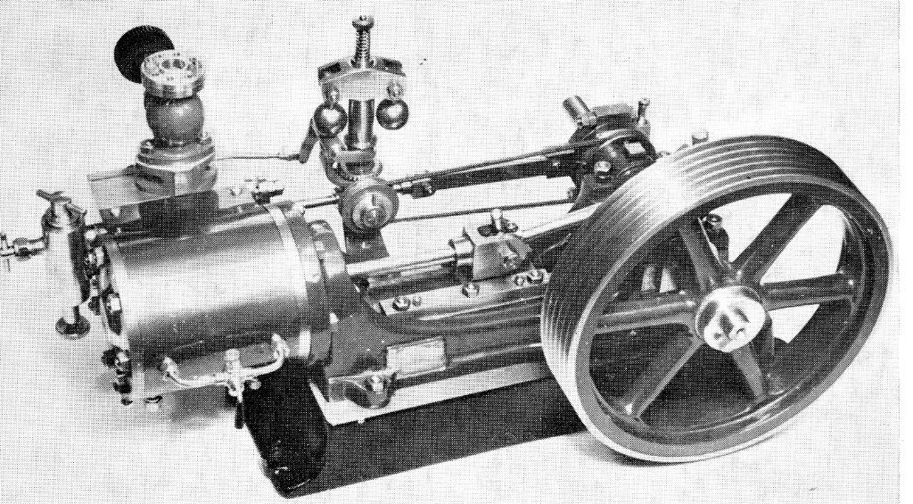

      A friend brought this to me yesterday, not sure where he got it, but its a bit rough, and not all there. Think I'll be able to sort it out, and at least make it look a bit better. There are more photos in my album. The nearest I'v got is S9.  The bore and stroke are 1 1/2".  The flywheel 5" dia.  Ian S C

          Hi Ian
          I think you are right.;- see here  If so any bits that you can't readily fabricate are available on that site.
          I seem to remember a twice size one at the Bristol show last year and very handsome it was!

            Its a stuart no 9 built one many years ago

              This one was also built many years ago, and by the look of it, by someone who was no craftsman. One example, at the rear end of the cylinder, a hole has been drilled and tapped top and bottom for holding cladding on the cylinder, that would be OK, except that the holes go right into the cylinder.
              Its got parts of a govenor, and a feed pump. I'm in the process of making new excentric straps, one for the valve, and the other for the pump (maybe), the brass one that was on the valve (too tight), fits the pump excentric. I'm using a bit of cast iron, as I will for the guide rails for the ? slipper? on the con rod. I'll even have to make the oil cups for the bigend, and main bearings. The key for the flywheel will be a filing exersize, its not square.
              The govenor is going to be a bit of a puzzle, I have the spindle, the pully, and the T shape bit the flyballs mount on, and the pully that fits the crankshaft. Oh yes, I'v got a tube of JB Weld. Ian S C

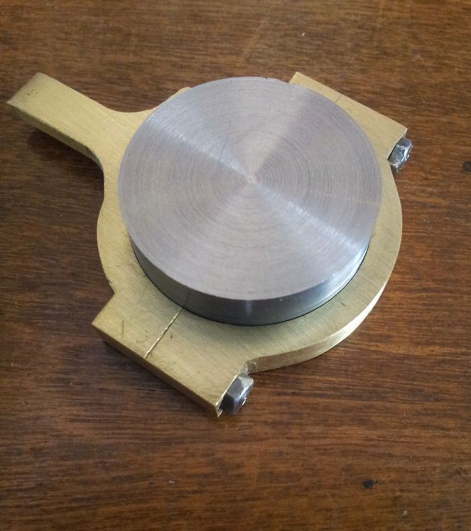

                  Making eccentric strap this afternoon, found something else, the eccentric has a ridge, more or less in the centre to locate the strap, there is a .0035 difference in diameter. The eccentric is a bit over 1 1/8", and I want about .0015" clearance, just a guess.

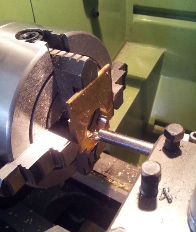

                  Terryd
                    @terryd72465
                    Hi Ian,
                    Out of interest here are a couple of pictures of the eccentric strap and new eccentric I am in the process of making to refurbish a Stuart Beam engine damaged in a fire – the eccentric has the locating ridge you describe, I made a special boring tool to make the groove in the strap.
                    Stuart were in the process of being taken over and I couldn't get a new casting so I fabricated it from solid – besides, I like a challenge and am an old skinflint!. I have progressed since these pictures and have made the operating shaft and clevis brackets and will post a picture when I can get a good one.
                    Click to enlarge
                    Eccentric strap 1
                    Boring the eccentric strap blank before shaping outline. The HSS insert tool for the groove was made to fit this boring bar:
                    Hope this is of some interest,
                    Best regards
                    Terry
                    Edited By Terryd on 07/10/2012 10:06:31

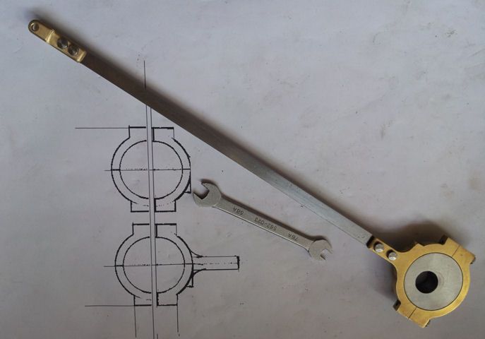

                    #100196
                    Terryd
                      @terryd72465
                      Hi Ian,
                      I found a few pictures taken earlier, con rod was cut from a bit of old rusty sheet and polished:-
                      Eccentric:
                      Eccentric control assembly (sketch is my poor hand drawn sketch) BA spanner as a size comparison:
                      Hope this is not getting too boring, if it is let me know and I'll shut up crook

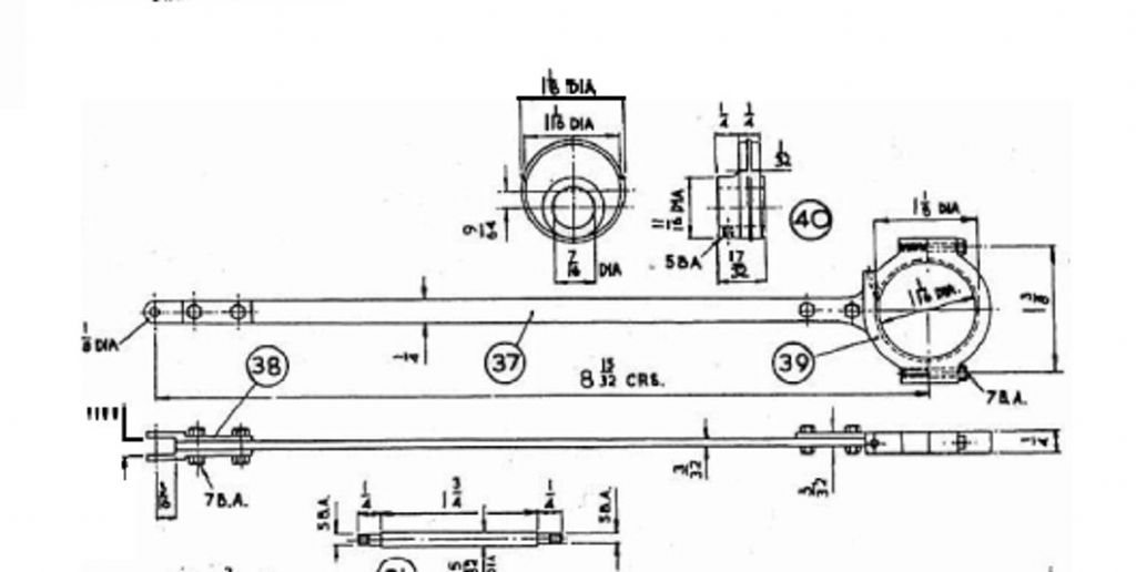

                      #100208
                      NJH
                        @njh

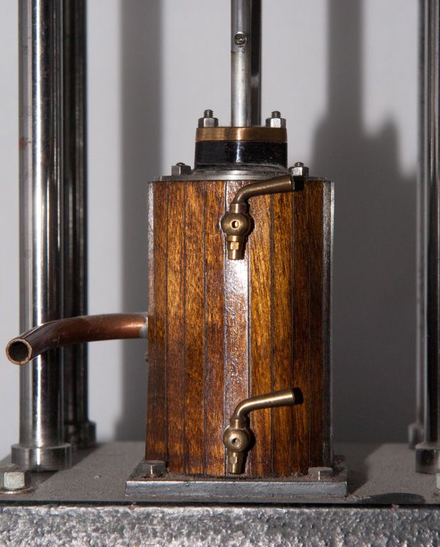

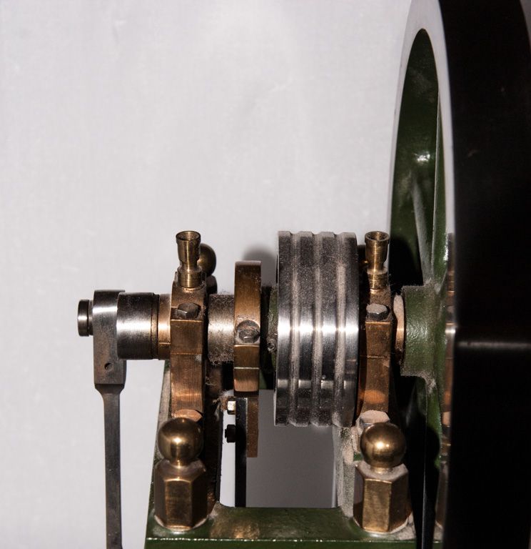

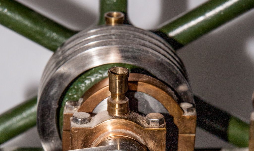

                        Hi Ian
                        Terry is quite right – I think it is common on Stuart engines to have this grove cut in the eccentric strap. Here are a couple of pics of the same fitted to the ST "Real"
                        You asked too about the tapped holes in the cylinder – this shows the drain cocks fitted to the same engine – is that the position of your holes?
                        This engine has sat on the desk in my study for many years ( I think I made it over 30 years ago!!)
                        Looking at the 'photos it's Filthy!!! and, worse still, a few signs of rust are appearing. I think I'd better give it a birthday!
                        I always enjoyed building the Stuarts – the castings were well produced and easy to machine – well at least they were 30 years ago! when I bought this set from Henley.
                        Let's see a few pics when you finish your restoration.

                        Terryd
                          @terryd72465
                          Hi Yet again Ian,
                          I note that your eccentric is about 1 1/8" dia, I just checked my books and it appears to be the same as the one on the Beam engine, Here is an extract from the Stuart Drawings in the building advice book by Andrew Smith. Together with the main dimensions of the strap. Let me know if you need more information – send a pm -, the crank should be the same as well I suspect.
                          Click to enlarge
                          Best regards,
                          Terry

                                    I was making a eccentric strap today from a cast iron brake disc, and I thought to myself, this stuff would make good piston rings, so I might have a go. For any Kiwis, I'v found a place that sells BA taps and dies, have not been there yet, its called Drills Taps and Dies, I'll get there later in the week, with any luck, think I only need a 4 BA die, need a number of studs, I'll make some hex to make nuts.Ian S C

                                        I notioced that on teh current Stuart site that they are now not listing "finished piston rings" as they ded before, instead you get a vitron O ring. Some of teh larger bore engines still have CI rings but all the ones with the common 1"x2" cylinder now seem to have the O rings.
                                        It also seems to be the season for making Eccentrics & straps, Ive just finished these two and just managed to get them out of a couple of slices off the end of an 80mm CI bar.
