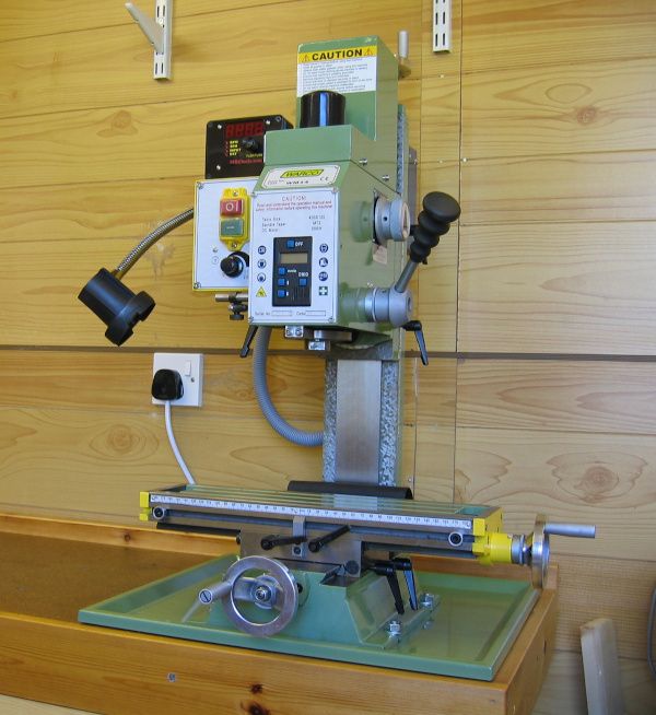

                      This is my WM14 standing on a home built bench 520mm deep. There is about 110mm between the rear of the column and the wall but only 75mm from the chip tray to the wall.
                      Of course the main thing to allow for is the width. The table is only 400mm wide but needs at least 800mm to allow for full travel and the handle. For more info have a look at Journeyman's Workshop. There are a few pages on mills and benches there. Out of interest I trammed the tilting head true when I first got the mill and have never moved it since, as others have said it is much easier to tilt the work.

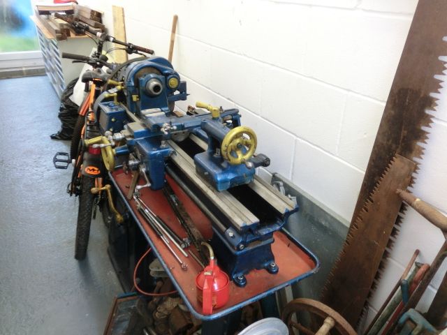

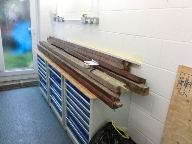

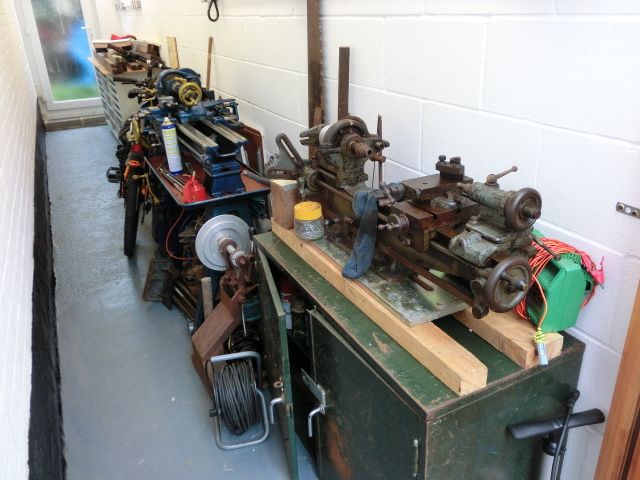

                                        I just spend ages measuring and thinking and checking dimensions and thinking. Its amazing how poor I am at making a decision considering I have been on this since 2004.
                                        I then spend ages typing this post, hit the wrong button and it all disappeared. angry
                                        I have managed to up-load some pictures. The mahogany came out of a skip about 20 years ago when a previous employer ripped out some office partitions that probably dated from the 1950s. When we moved from Gateshead to Hampshire it came too. The time and trouble of bridging across the metal drawers is fine by me as the draws are lovely and the vendors didn't know what load they could take. I have a 18" x 24" surface plate to fit on as well as a heavy vice and prospective machine tool.
                                        The gap in the foreground will have a fume cupboard, so what you see is the bench, about 2m long.
                                        #483991
                                        Roger Best
                                          @rogerbest89007
                                          smiley
                                          The other end is dominated by my WW2 South Bend Heavy 10 with taper turning attachment. It sticks out 27", 690mm, so well in the way for getting past.

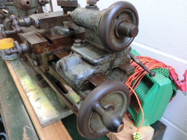

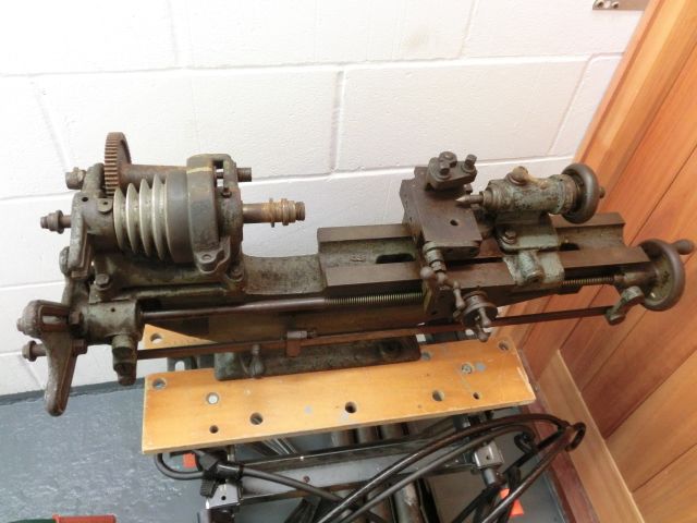

                                          #483993
                                          Roger Best
                                            @rogerbest89007
                                            smiley
                                            The little lathe is a Drummond M-type, presumably coming up for its 100th birthday. Its a cracking hobby lathe, nominally 3 1/2" it has a good gap bed, a whopping 9" face plate and loads of bits I have yet to sort out.
                                            Obviously I don't need two lathes, but this one has waited 20 years for some TLC and I do like it.
                                            It was sold to me by a gent who became a mentor and close friend to my brother, he lived just off, Maidstone Road, Rainham Kent, so someone might know him. He died many years ago, a great loss to my brother.
