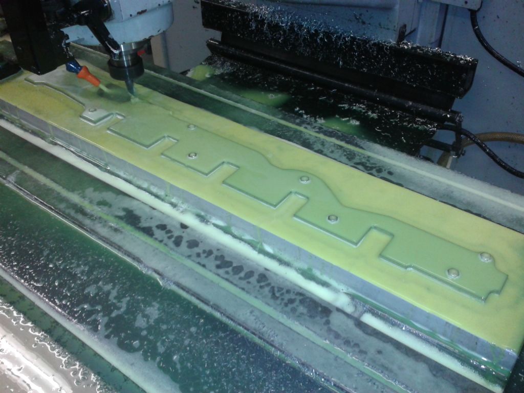

                                                  When I cut out my BMS sheet frames for my 5" KING (20 years and still not finished) I had them sheared over size and then hacksawed down to width(hight). This took the stresses cause by the shearing out of the plates and they remained perfectly flat. Possibly because I did not really know what I was doing then.
                                                  Martin
