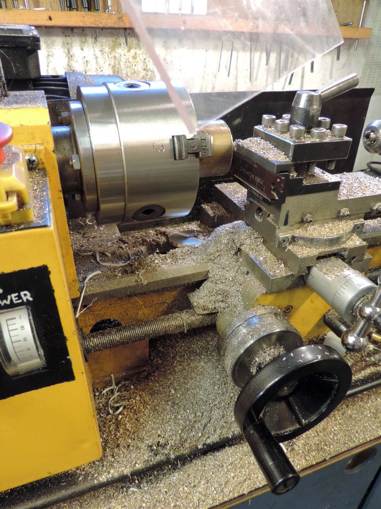

                                      I know I am biased but a few jobs done on my mini lathe, admittedly with roller bearinmg conversion, but i never had any problems before doing it:
                                      0.125" DOC (the manual recommends 0.01" max…)
                                      Finish you can get parting off with a carbide tool (1" diameter):
                                      2 1/4" diameter knurl using single wheel held in toolpost:
                                      Capacity for swarf generation…
                                      Parting off 1 1/4" steel using HSS tool:
                                      As LBSC would have said, any questions?

                                          You were doing so well until that pile of brass swarf hiding a lathe made its periodic appearance cheeky

                                              I don't deny it's brass, but it proves I'm not just an armchair machinist 😛

                                                Where there's brass there's muck devil
                                                Actually, I did some brass and copper turning a couple of weeks ago, and the swarf from those two colours mixed is quite satisfying!

                                                  I'd have never guessed it was brass, I assumed EN1A or similar. What were the rpm and feedrate?
