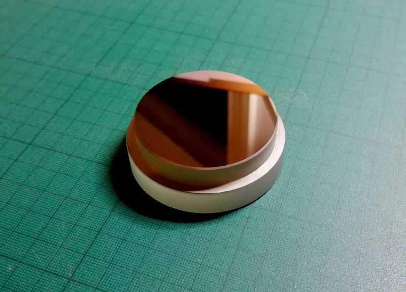

                    #531286
                    Pete Rimmer
                      @peterimmer30576
                      I've bought this mirror from a member who was kind enough to offer it in response to this thread. It's in fantastic condition, the silvered face is 55mm and it's 20mm thick.
                      I intend to make a cast iron mount to hold the mirror, I have the materials and the facility but what is the best way to hold it inside the housing whilst allowing for adjustment in the vertical plane? The sled will be 2-piece with the base holding the mirror mount so I can allow for horizontal adjustments there. I have to think about fine-adjusting the mirror vertically.
                      I've done reading-up online and there seems to be a bewildering number of options and considerations. I'd like to keep it as simple as possible.
                      Pete.

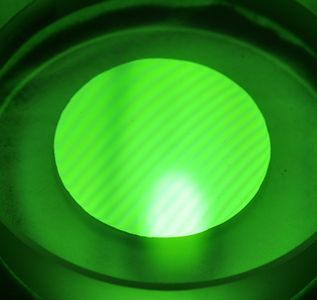

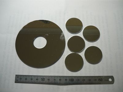

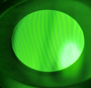

                              Tendor
                                @tendor
                                Posted by Martin Connelly on 24/02/2021 09:17:30:
                                The disk in a scrap hard drive may be useable. If you have one to take apart the disk is aluminium so easily cut. Don't know how well it will work for your application but it may be a suitable stop gap until you get exactly what you want.
                                Martin C
                                I have gone a little way down the path of investigating this for the same purpose. My preliminary results were not very encouraging, but I report them here for the information of interested members.
                                I acquired an old HDD and extracted the three 90mm diameter aluminium disks. (Newer HDDs have glass platens and are only 65 mm diameter). From one of them I cut 5 small circles of 33 mm diameter – the largest possible (given the hole in the centre of the 90 mm disk).
                                Using an optical flat they were tested for flatness by rigging up a very rough 'monochromatic' light source (a compact fluorescent bulb with green cellophane over it – about 550 nm wavelength).
                                Attached are the fringe images of two of the ten surfaces available (both sides of the disk are recording medium). Only one was 'nearly flat' (parallel straight fringes). The other image is one of the "less flat" examples. Fringes are half a wavelength apart – about 275 nm in this case. One fringe deviation from straight is therefore about 275 nm. Hume's book on autocollimators mentions that reflectors should be flat "within a few millionth of an inch" (~ 75 nm)
                                My conclusion is that these are not really good enough for autocollimator reflector use. However, beware that this was a single test on only one platen. Others may be better.
