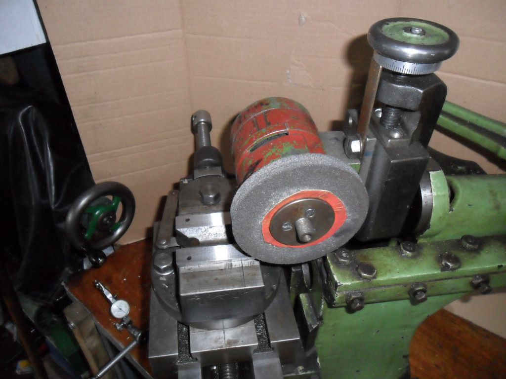

        I sometime uses my Drummond hand shaper for surface grinding
        Nobbydrummond shaper

          Surface grinding on a shaper? That's an interesting idea, but would have to be approached cautiously under power. Food for thought, as I have a small tool post grinder.

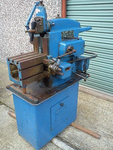

              Here's my Elliott 10M. Love setting it going then hearing it swish swish in the background as I get on with something else

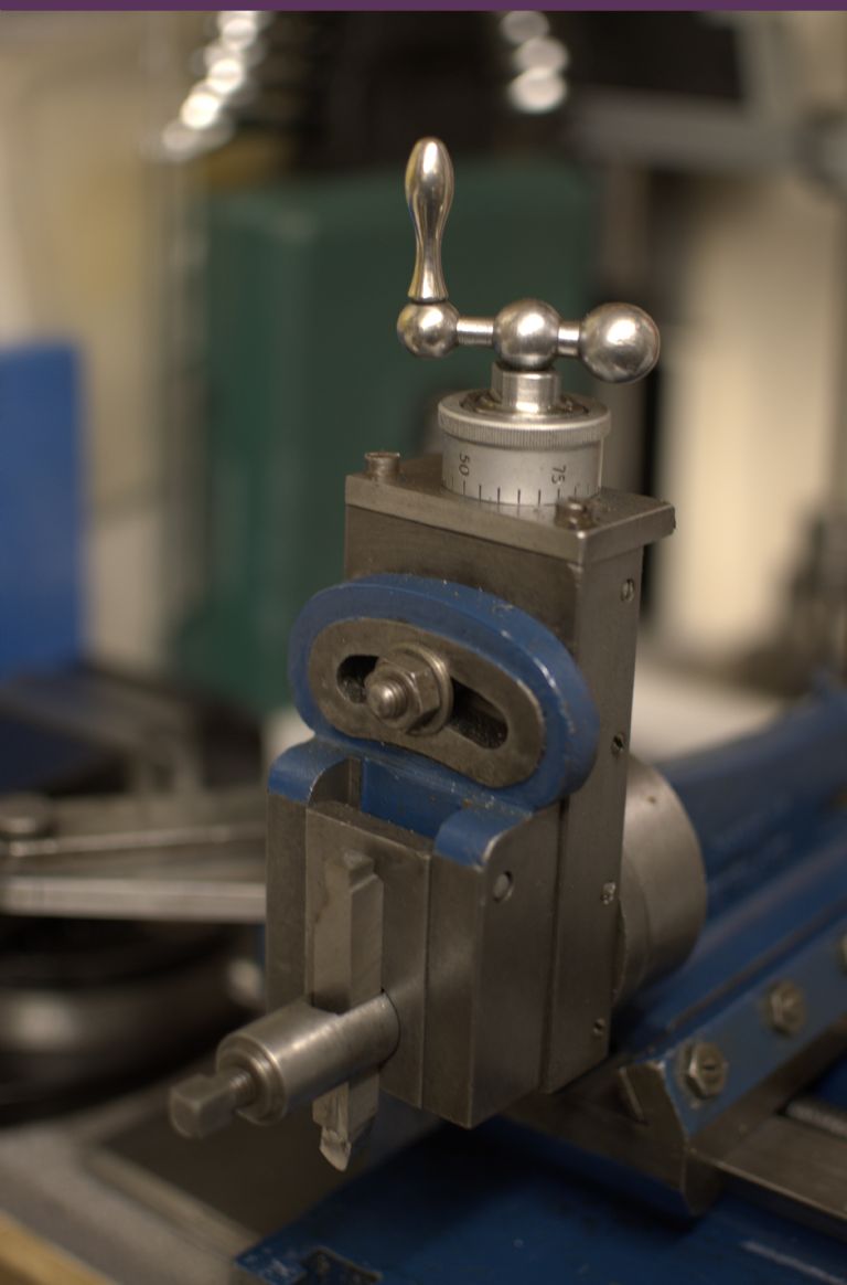

                    I find my Adept number 2 hand shaper to be a good substitute for my poor filing skills.
                    The modification to the toolslide shown takes the guesswork out of depth of cut.

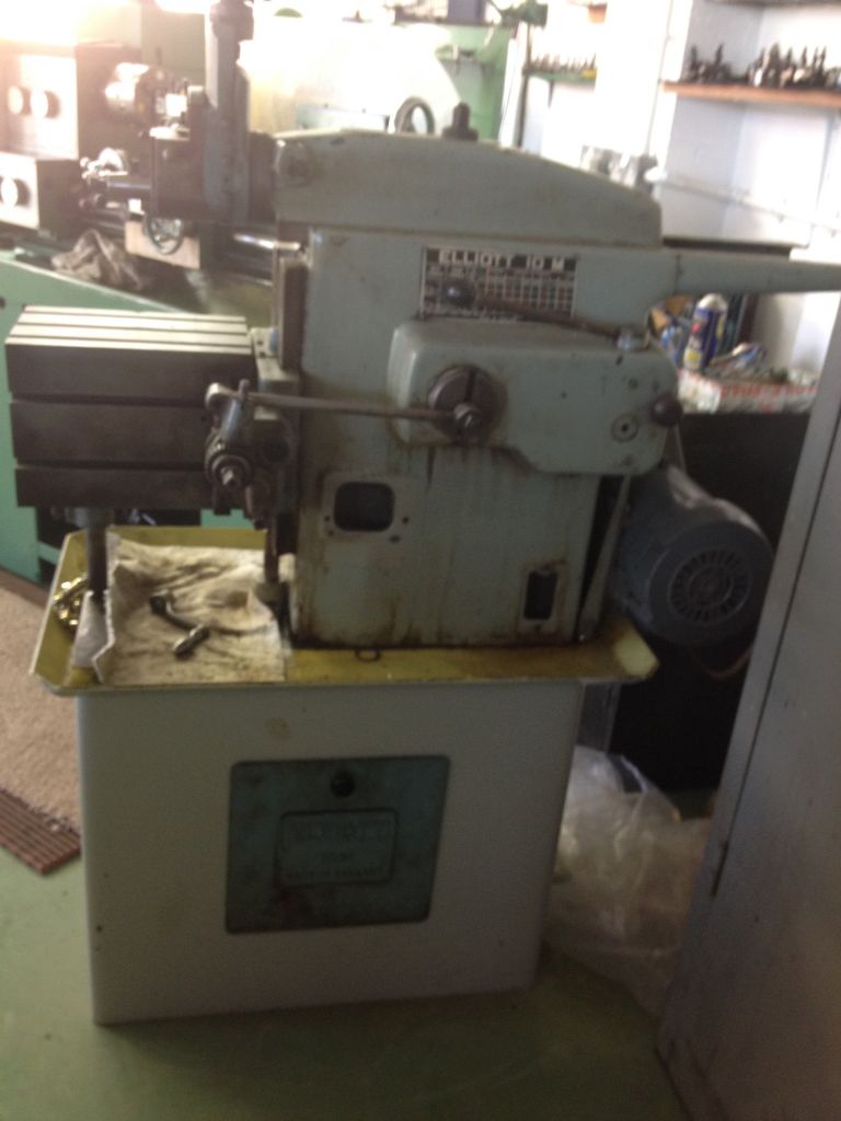

                                                image.jpegMy 10 M had it probably 20 years rescued from a scrap yard still scared of it!
