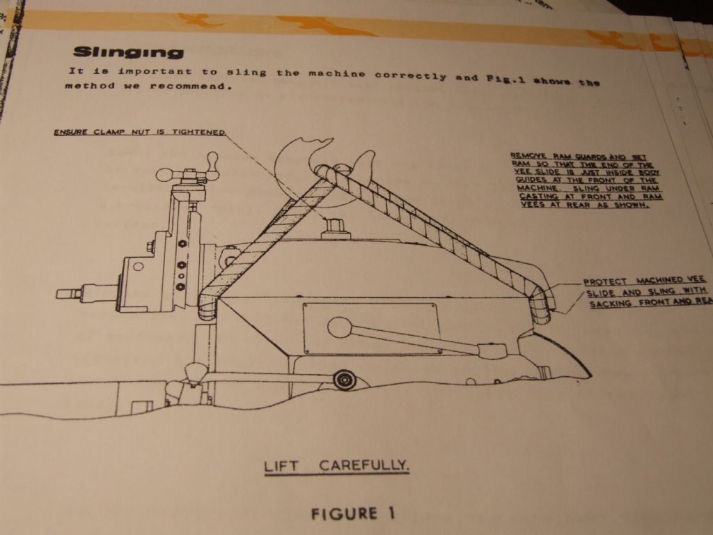

          #532845
          Nigel Graham 2
            @nigelgraham2
            I don't think the shaper would go much on being lifted by the ram, either!

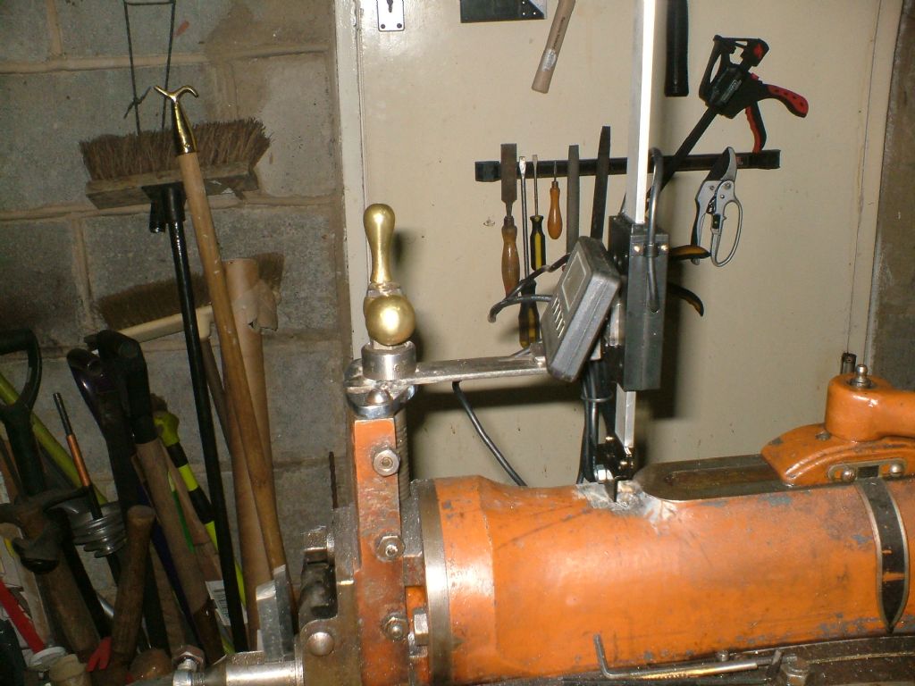

            #533031
            Ady1
              @ady1
              Looked at DRO stuff recently but the prices were a bit on the high side for an experiment
              So I got a couple of cheapies and I'm very impressed with my first impressions, they are good to a couple of hundredths of a mm without any serious effort on my old jalopy
              edit:
              The cheap dros are in a different league to calipers, they feel better and record movement far more readily
              Edited By Ady1 on 10/03/2021 17:16:20
              #533043
              noel shelley
                @noelshelley55608
                my pictures11 154.jpgThe idea of lifting by the ram is not mine – It's from the Elliot 10M handbook. I quote -" It is important to sling the machine correctly and Fig1 shows the method we recommend. Remove the ram guards and set ram so that the endof the Vslide is just inside body guides at the front of the machine. Sling under ram casting at the front and ram Vees at the rear as shown". Having been trapped when a 10M toppled I can vouch for the fact that mounted on a pressed steel cabinet the machine is VERY top heavy. Lifting with the weight above the C of G is to invite disaster!!!!    Noel

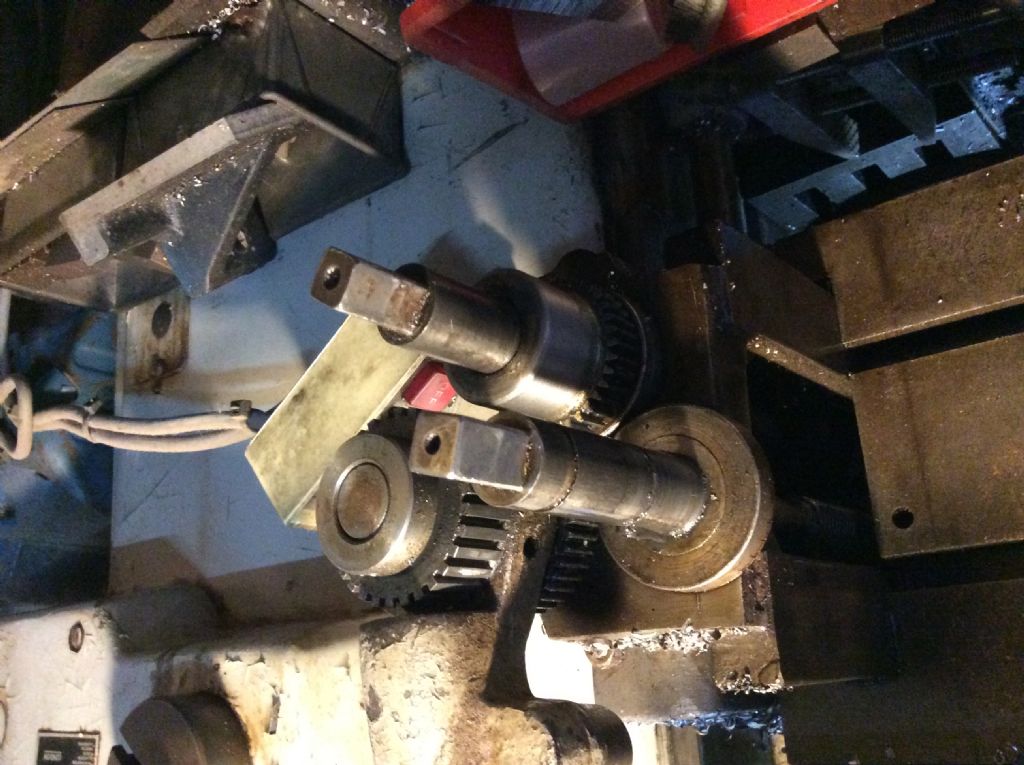

                  #534923
                  Ian McVickers
                    @ianmcvickers56553

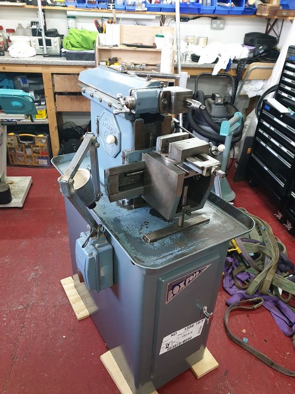

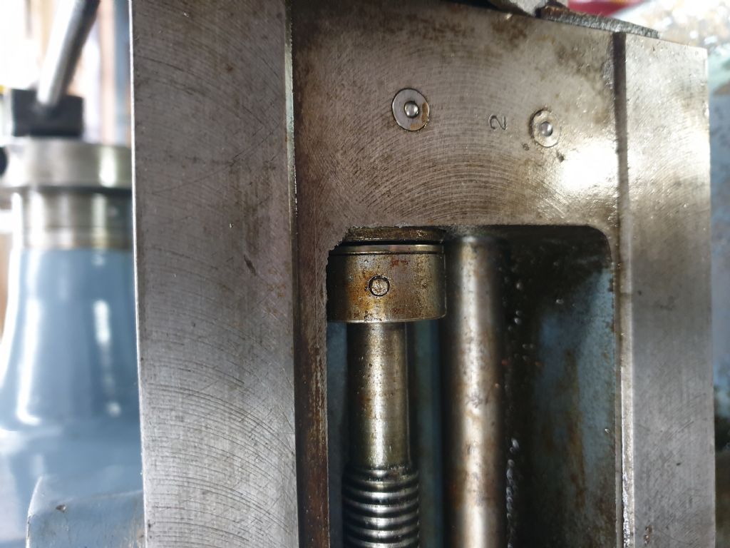

                    My Boxford shaper has arrived and has had the electrics removed so that I can replace them with some more modern stuff. I would have liked to remove the table but cant get the internal nut off. The previous owner has pinned it through the shaft.
                    Had a go at punching it our but its solid. The nut has a grub screw so I dont know why the pin was fitted.

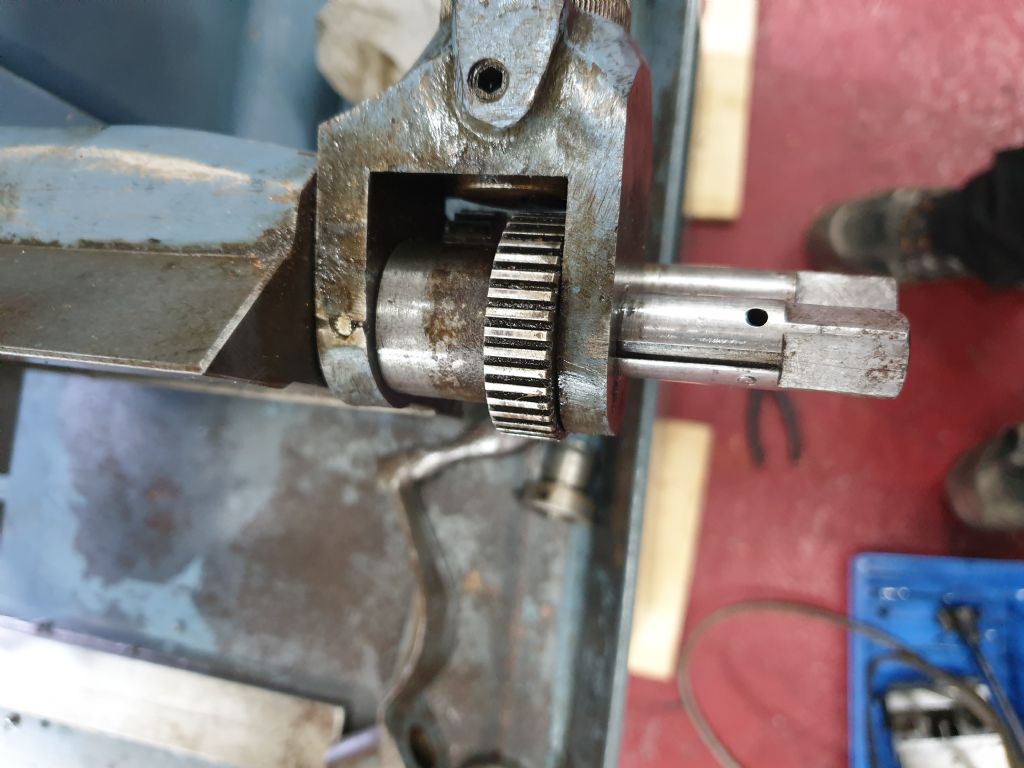

                    Can anyone tell me how to remove the table drive assembly shown below.
                    The bush on the front of it had also been pinned with a taper pin which came out easily enough but I cant get the assembly off the shaft, The outer bracket and spacer rotate on the shaft but the pinion does not which I think is correct. I presume the pinion is keyed but cant get it off. Since the cast bracket has already been repaired I didnt want to force it.

                      Hi, have you downloaded the drawings from Boxford's website?

                          #535110
                          bernard towers
                            @bernardtowers37738
                            Vertical feed is obtained by sliding the sleeve gear from its shaft and refitting it to the lower vacant shaft. Will try to take photos tomorrow.
                            #535281
                            bernard towers
                              @bernardtowers37738
                              8780a542-caa0-4599-9cb5-3c8cf1f5c6b3.jpegFirst photo vert feed second horizon feed

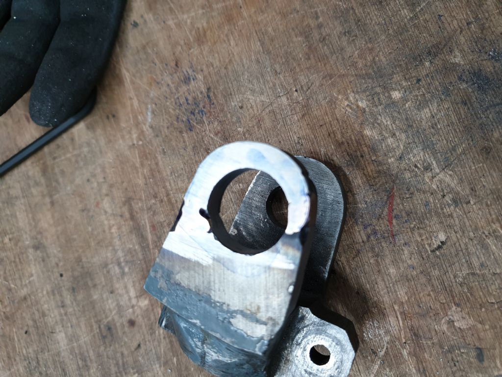

                              Ian McVickers
                                @ianmcvickers56553
                                Thanks Bernard.

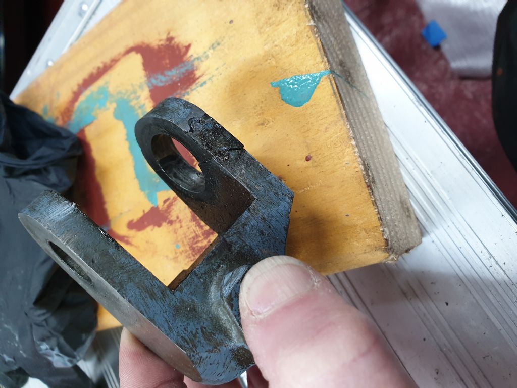

                                I managed to get it removed today without any hassle. No idea what was wrong before. Im going to have to get the bracket brazed as now i`ve got it removed I can see the break and it needs a better fix.

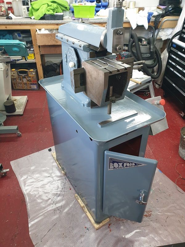

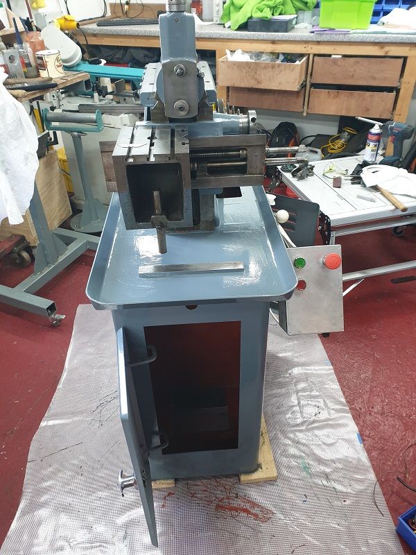

                                  Shaper as delivered
                                  Shaper nearly finished.
                                  Still have the vice to look at and need to get the table off and cleaned and painted.
                                  Electrics are all done and it runs nice and smoothly.

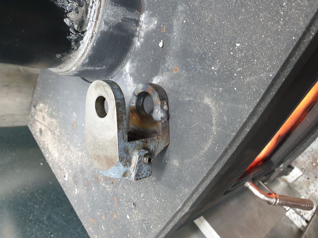

                                  #536105
                                  Ian McVickers
                                    @ianmcvickers56553

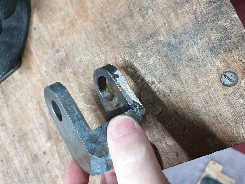

                                    Still hijacking this thread a bit… Had a go at tig brazing the cast bracket and it turned out ok.
                                    After welding left it on the heater overnight to gradually cool. The material ended up being rather hard around the weld so had to grind it down.
                                    A bit of machining to get the hole round again and its ready for painting.

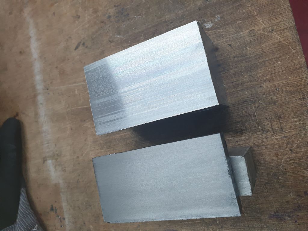

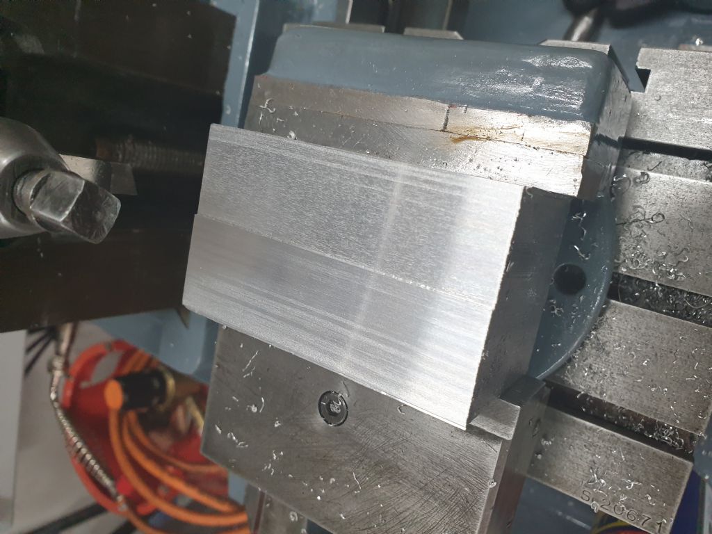

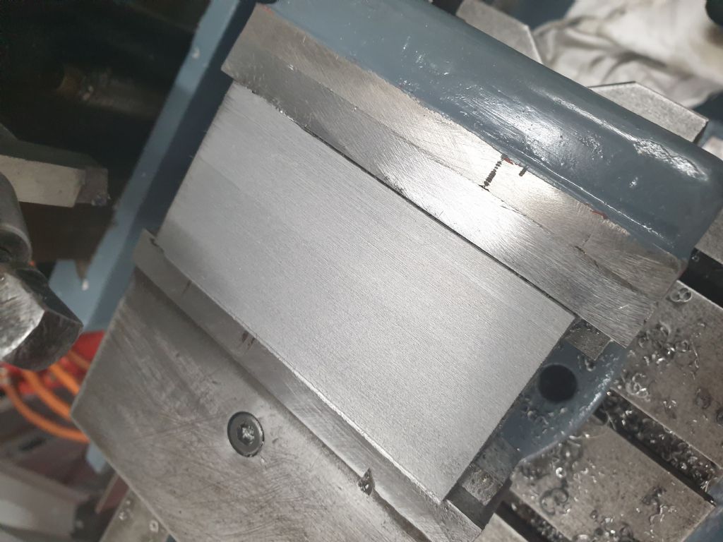

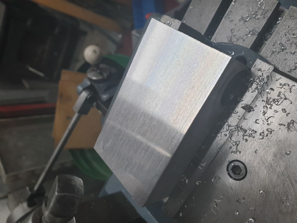

                                      So finished off the shaper and tested it out today on some ali and mild steel.
                                      0.5mm deep cut on ali.
                                      1mm deep cut with wd40 beside the 0.5mm deep cut.
                                      0.5mm deep cut on mild steel witrh wd40.
                                      Both parts side by side. Impressed by the cut quality.

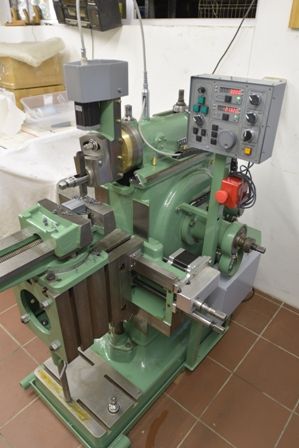

                                                      I would not be without my Shaper if I can help it!  But, I could not do without my benchtop mill either!.
                                                      I think there is a balance – if you can afford a big mill with heft capability, you can probably afford the cost of tooling it – collets, cutters ( HSS, Carbide, ) etc then a Shaper is moot. But if you can't, a shaper is an inexpensive solution to hogging metal in preparation for finer work on the small mill.
                                                      And since DRO's are mentioned – if you fit a DRO to the shaper, you will be amazed at how accurate you can work.
