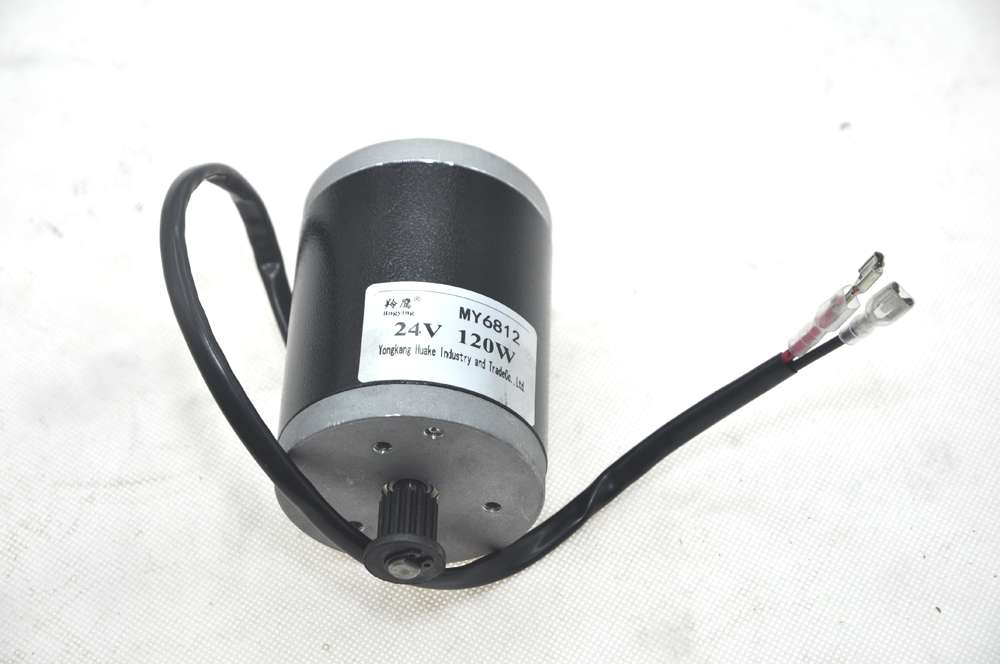

      As sod says,  Scooter /cycle motors come in various powers, are compact and have a manageable RPM. I use one like  below for a jeweller’s style  sensitive drill running off a 6A 24v black brick PSU with a relatively decent quality DC controller (ie not the cheapest £3 ones!) speed controller. It even came with a 3M timing gear so I only had to get one more for the counter spindle.  More powerful ones are available
      Plenty of grunt for drilling all materials up to 10mm and compact, round belt slips long before motor stalls out (except at very low speeds).
      Thought about replacing the ex washing machine motor that powers my picador mini wood lathe. The only advantage of the faintly comically sized washing machine motor is that it delivers an almost perfect 1000RPM when supplied with 36V so it can power the lathe spindle directly without too large a pulley.
